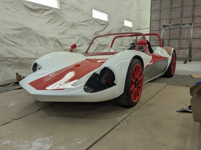

But in the meanwhile......Working on the main chunk of body, prepping for paint.Lots of smoothing to all the modified/added into areas.Lotsa filler primer and block sanding.Third cycle of prime and sand going on now.16954899126791.jpg

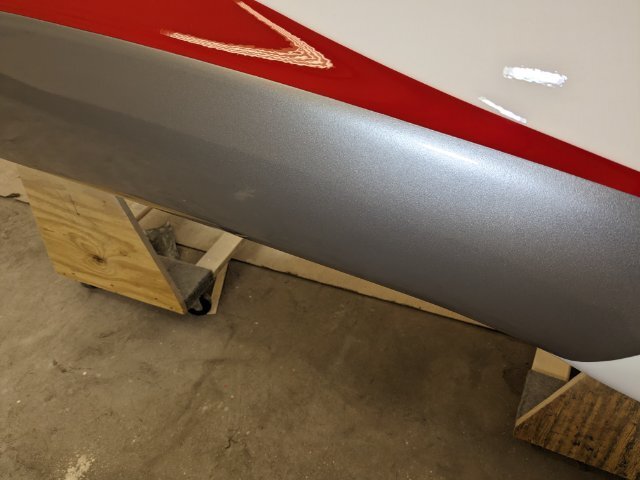

Next up is some silver and :Angel:clear coat. It is nearly all sanded and ready.But I hafta work this weekend... dunna when I will get to it.

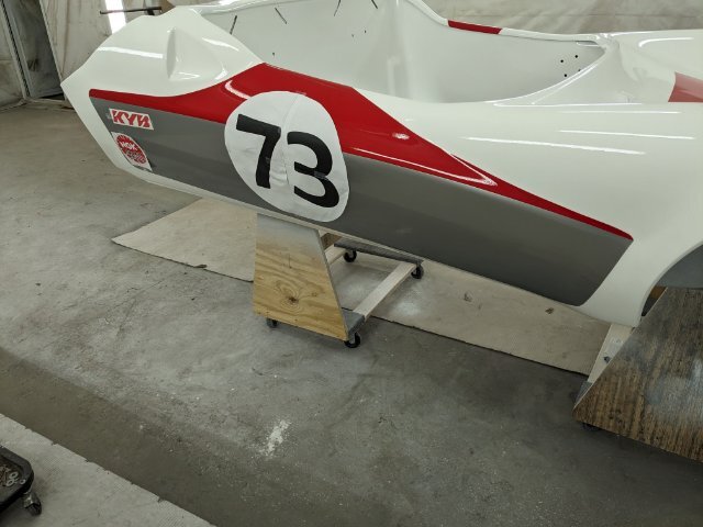

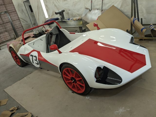

Beautiful!!! Are you going to put numbers on it? Maybe your daughters birth year?:pepper:
Yes it gets numbers ..... and yes it does connect with daughter.She came up with an amalgamation of my old race number and her favorite numbers ......So when she was racing dirt track the number was 73.That silver is lighter in person that the pics make it look.16992002652581.jpgAnd a mock up of printed pics from internet 16992002381000.jpg
