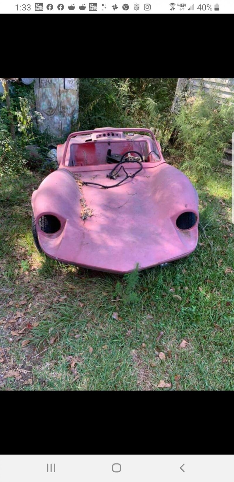

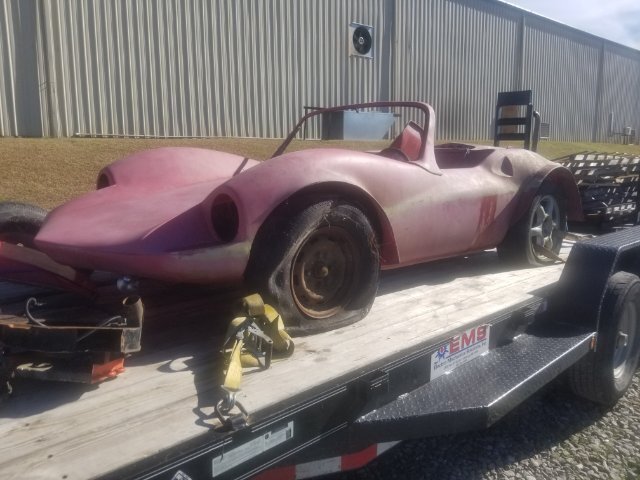

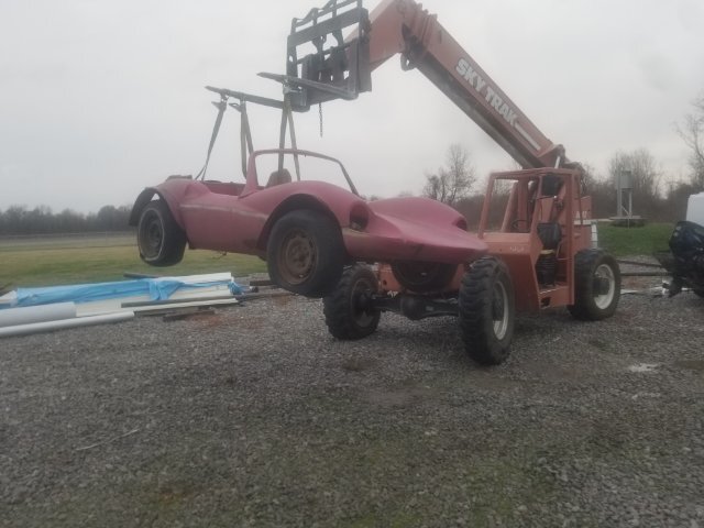

Looks like its in pretty good condition, without major broken body panel(s) to fix, with somewhat of a drivetrain still intact.
Definite score for $500, all day long!:clapping:

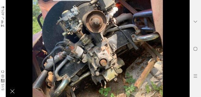

A nearly complete 1600 dual port, dual relief, dog house. The right engine to build from. A 1973 model AK.
It also has a dual side cover IRS trans and ball joint front suspension.
No numbers on the body to date it.
The company was in business 1974 to 1986.
This body style was discontinued in 1981 for a larger upgraded comfort body.
The molds were sold and others claimed that they were gonna make them again. I caint find one that was made by any new owners of the mold. I would assume a couple got layed up but that there was a lack of interest for any customers and the project scrapped.
So I am gonna say the body can not be newer than 1981.
The vw pan/chassis is late 70 to early 71. It looks like the beam and trans are 71 and there were bits and pieces of a 71 motor laying around it. It was never driven or registered, so never completed.
So all that leaves me with the vw that was taken apart was minimum of 3 yrs old to a maximum of 10 yrs old at the time it was taken off the road.

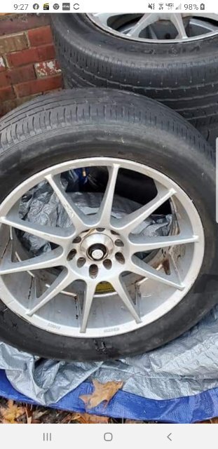

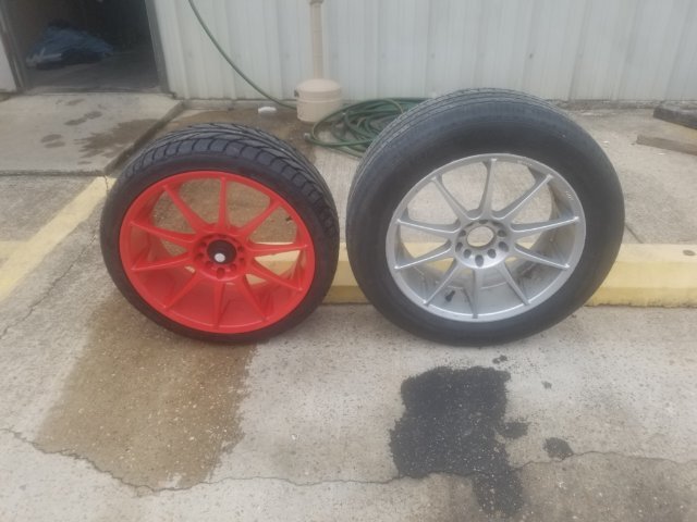

I came across these old Enkei lightweights. Technically not a street use rim....but the car is light. The wheels are not all that lightweight by today's standards anyway. I was going to have $250 in getting stock look steelies in 6" wide.
I got these with 2 barely useable tires of the right size for the rear and they are 17 dia and 7 wide (which is kinda narrow to find in a 17) which I think is the absolute maximum I could fit to the vw parts.
I might have to modify the body some. But a wheel I like and I paid $150 for them. Probably paint them red. Still thinking the silver and red racer look.

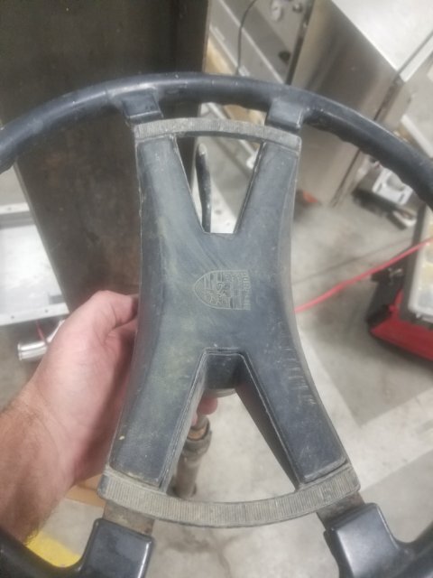

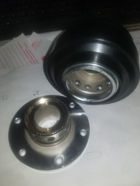

Dug around in my own junk pile and came up with this. It has been in my beetle back in the day.

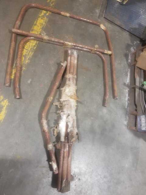

Found this chassis knock down kit in a very old pile.

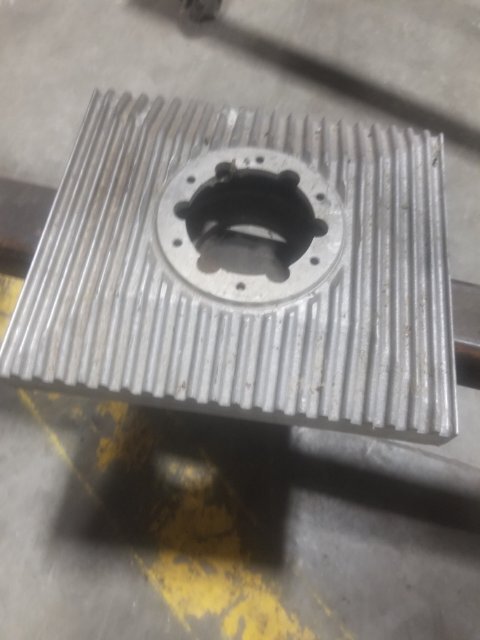

Add on sump.

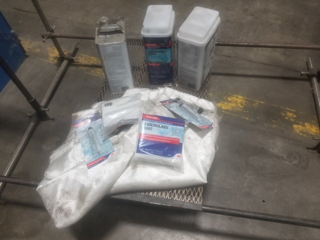

2-1/2 gal of resin. A lot of glass cloth. A few packets of matt.

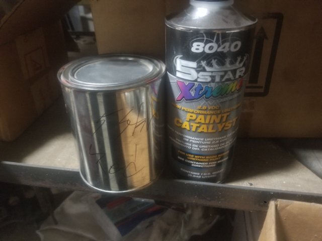

Viper red paint for the stripes and wheels.

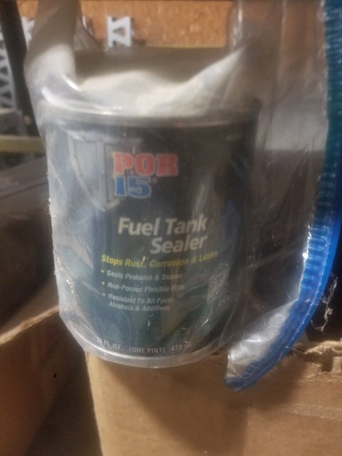

Gas tank sealer.

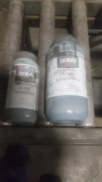

Ceramic for headers, piston, ect.

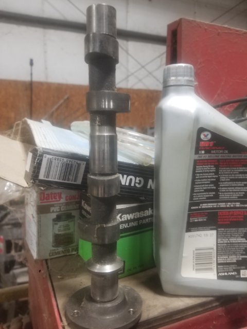

Eagle 2241 cam (about same as w110)

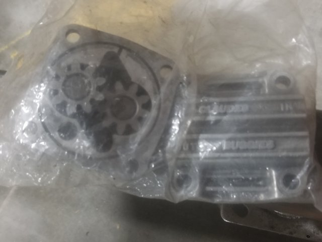

26mm in out oil pump.
Grade 8 pressure plate bolts.

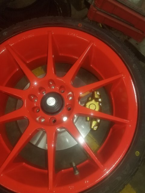

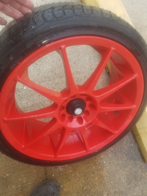

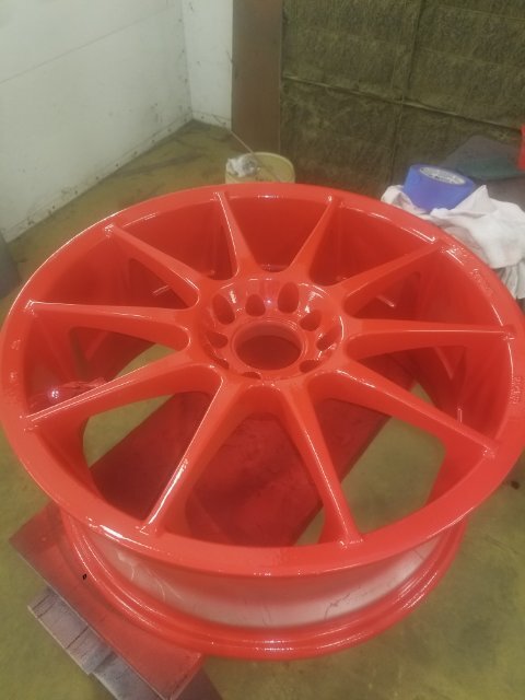

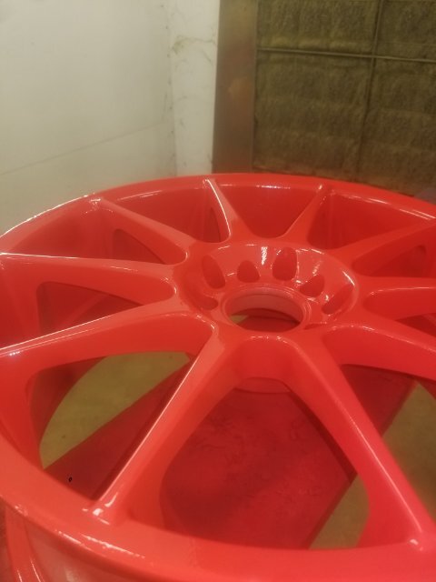

So the idea is red wheels. In my head wheels are supposed to be aluminum/silver. This is a new one for me here.
Only painted one.....just to make sure I like it.
I think I do.

Rubber band looking fro t tires.
The size difference between front and rear.
I got the other front wheel prepped and painted. Now to wait a day or two and mount the other front tire with the motorcycle tire spoons.

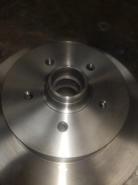

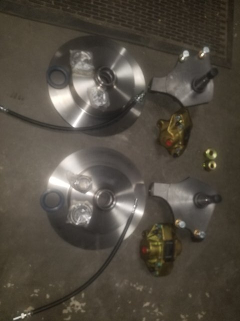

The front end big parts came in today.
2-1/2" drop spindles.
Rotors and calipers.
Bearings and seals.
Camber adjusters and brake hoses.

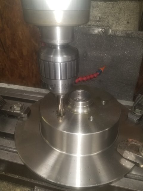

I know.....no lug bolt holes.
I need a pattern they are not available in.
So I will put my own holes in.
5 on 100mm circle and M12 x 1.5 metric stud and some odd nuts these wheels take.
Just waiting on some money to spend on the lugs.
