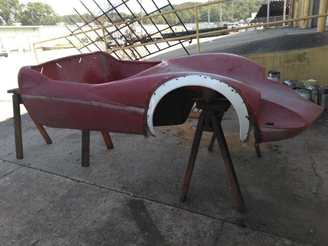

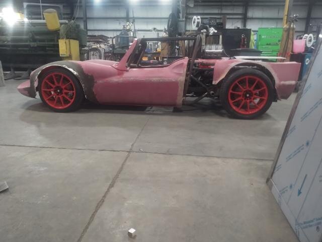

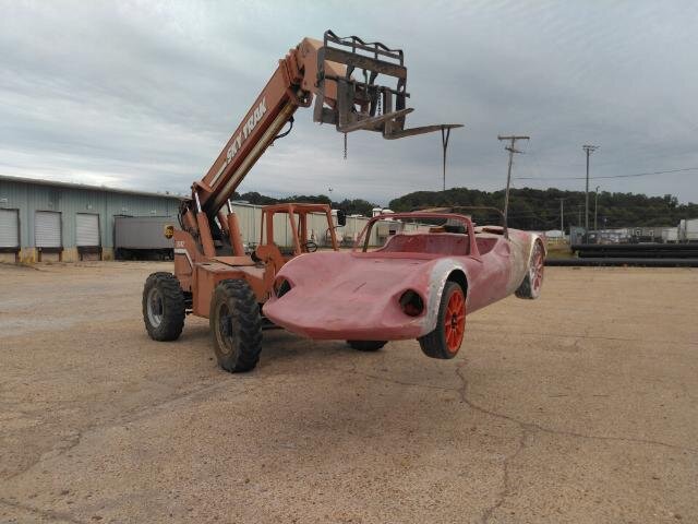

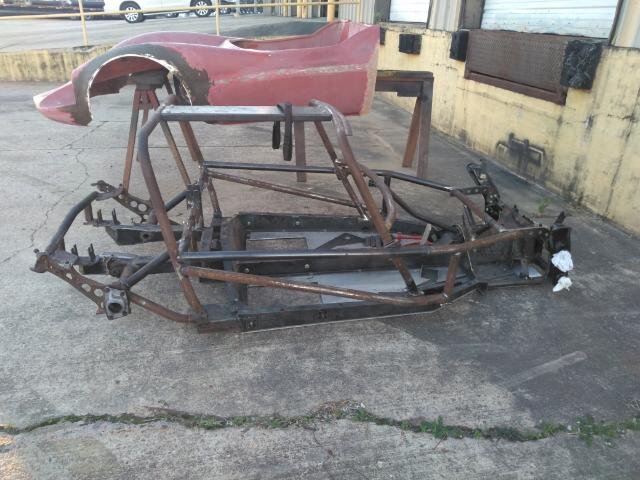

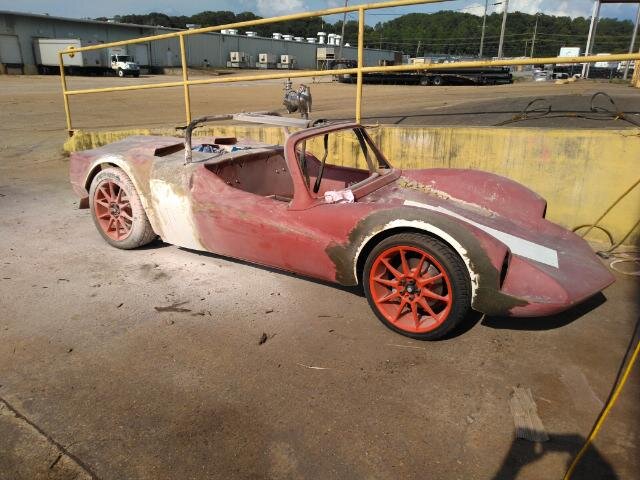

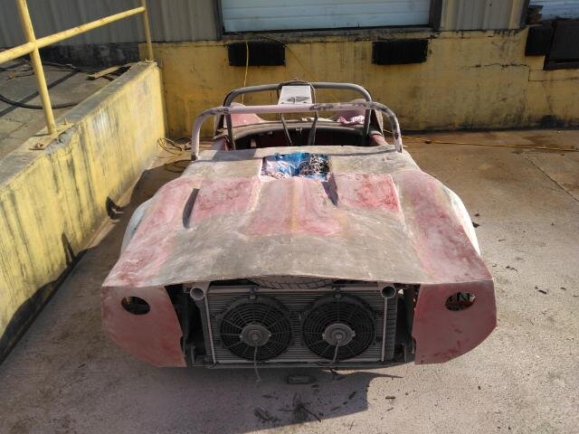

The body went on and off there a lot of times.......making all that tubing hide in there and the body stit down over it all.
But it is in its final resting place.
Aluminum floor boards made and body flange all bolted down.

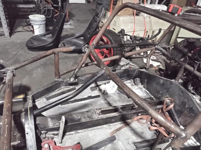

Worked on the seat and 6 point harness rearward mounting points today. All this connects through the body to connect directly to the roll cage.
No pictures of it though.....just tabs and brackets tack welded to the tubing.

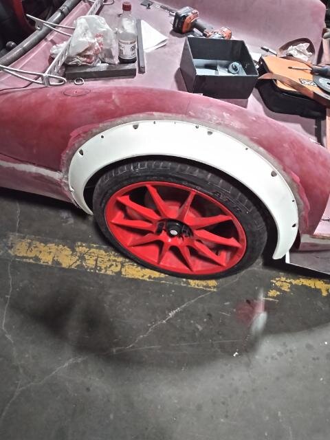

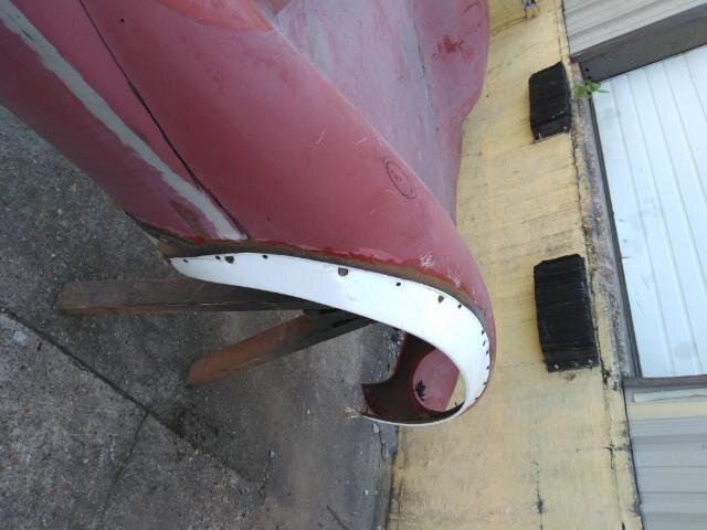

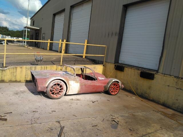

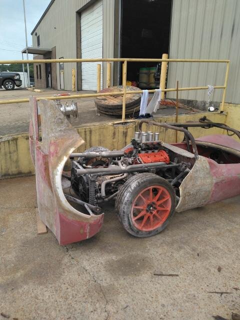

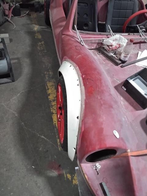

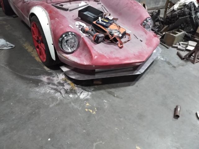

The 70's fender flairs are gone now.
Of course with drop spindles, spring drop, pie cut and a body drop......even with the low profile 23" tall tires .... A lot had to be hacked out just to get the body on.
So cut to clear, turn ect now
Well it's not like I went anywhere.....I look in regular and all......just not a lot going on......sickly wife to... take care of.....moved girlie to a dorm at college.....lots work...... so hot out..... getting old and slow.....ect.
Haven't hardly even ridden the scooter this summer.

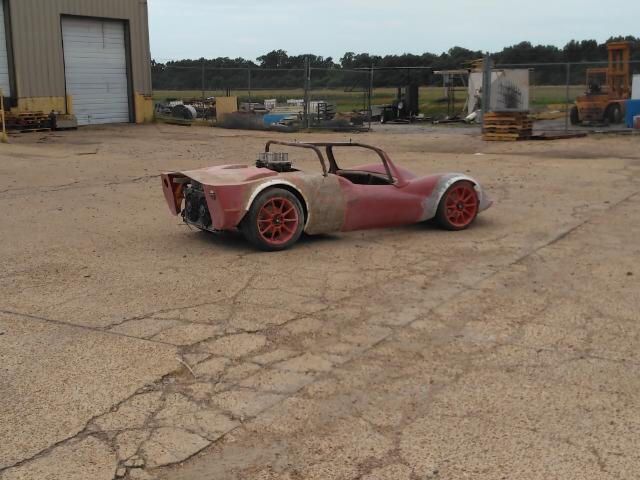

But....the weather has cooled off a bit and I am working on the funny little car again.

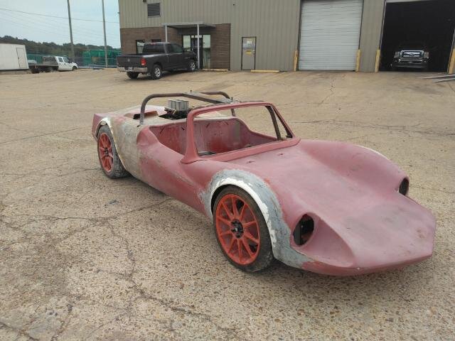

Started glassing the fenders....waiting on it to cure out.....then grind and glass each side in.

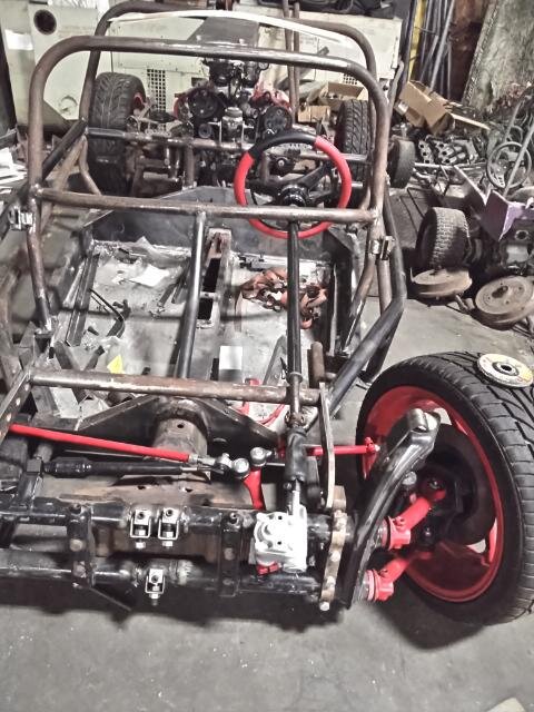

And the steering is mocked up.
Those front fenders are all glassed in and are in the process of sanding smooth.
But now that it is daylight loosing time....I don't get much sanding time.....the heavy dusty stuff I do outside of shop.

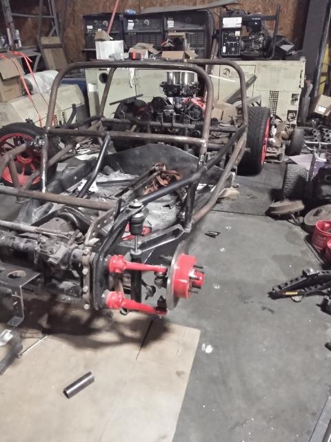

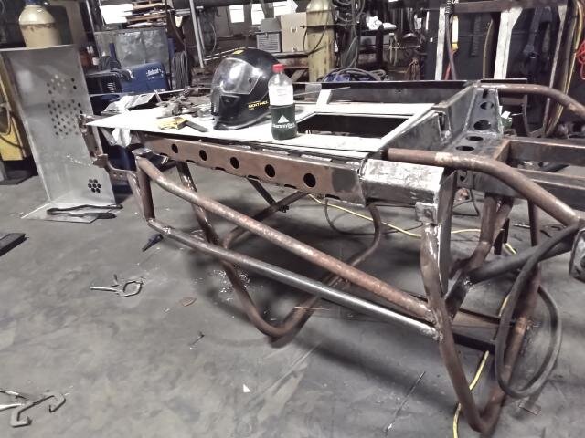

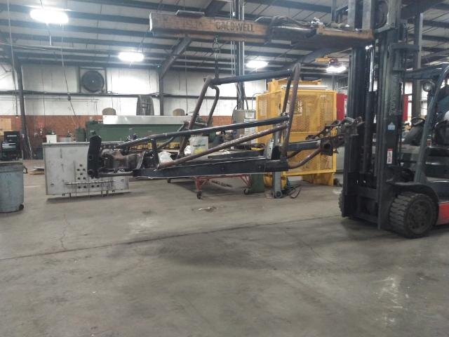

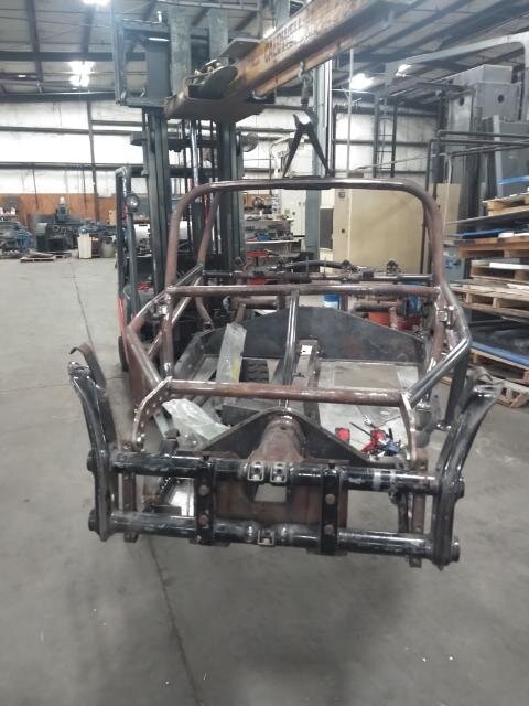

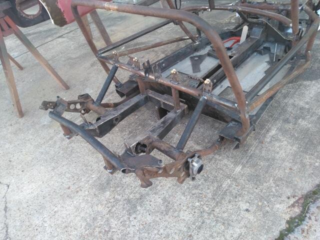

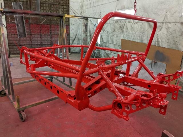

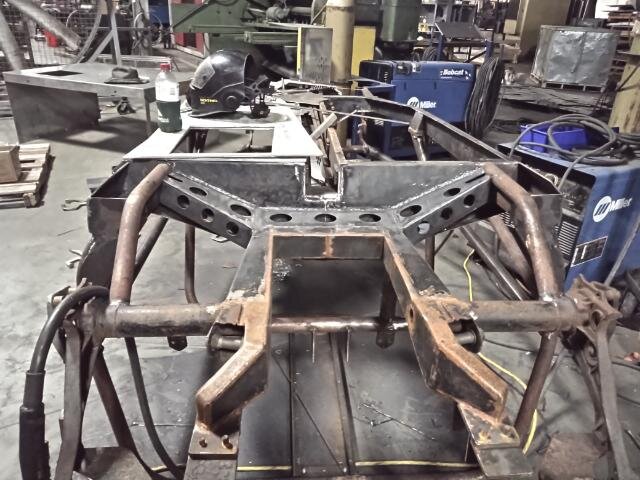

So right now the big push is the chassis. It is completely back apart. A few smaller details yet to fab and weld in.....tabs, brackets and such.
Doing the welding now.
I did get the welding done on the primary chunk of frame there.

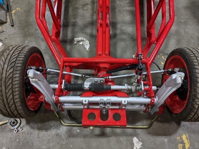

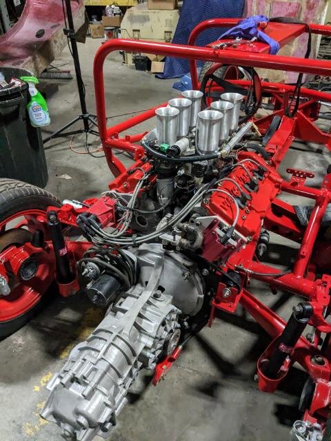

Then changed my mind about something. I had originally planned on brush painting por15 chassis black on the tube frame. An advantage of that was that I could add/change as needed.....and just touch up and no one would be the wiser
I now decided to paint the chassis with red car body paint (for looks).....now the chassis has to be 100% complete....no touch ups.

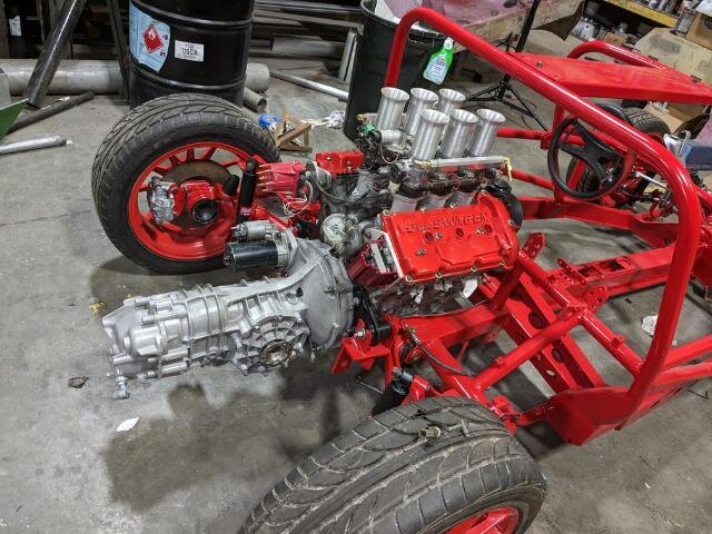

Do the whole mess went back together and lots of smaller things are being worked on.

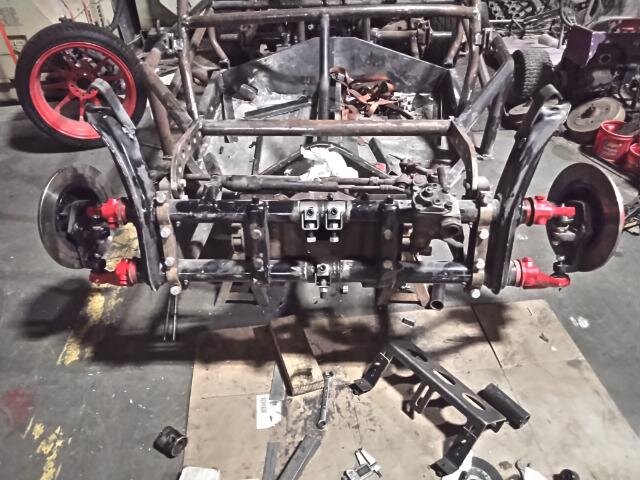

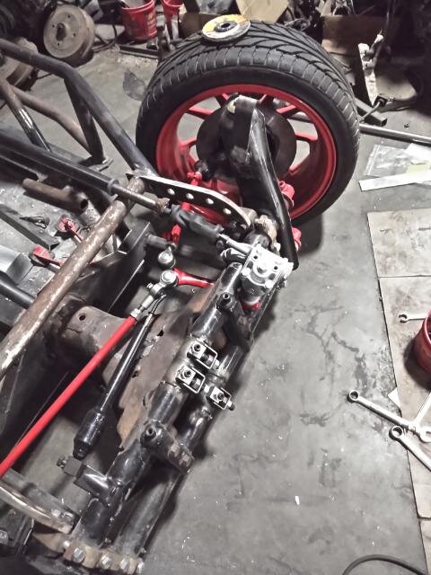

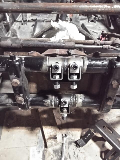

Shifter linkage is done....I might modify the shifter itself..... but not done yet.
Clutch linkage is done.
Throttle linkage (on the chassis parts) is done.
E-brake is done (cables not shortened yet)
Brake lines are bend and anchored.
Front suspension is complete (except for mounting the sway bar)
Rear suspension arms are welded and reassembled.....new bearings ect.

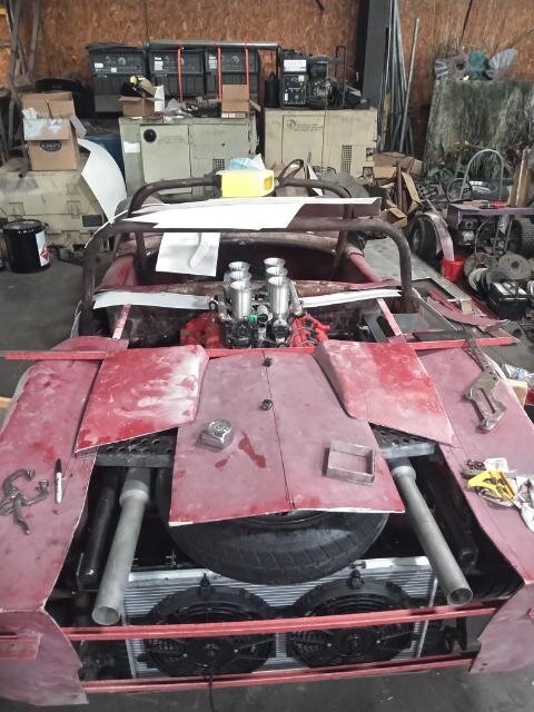

And now it is back in it's corner turned around the other way and building the back end. Rear subframe that holds the tail of trans, radiator and hood hinge is all fabricated and tack welded.
And..... I have had COVID again.
Went through the shop again.
I had started making the fiberglass fill ins of the back end......nasty outside work.
And now back to the fiberglass after getting over the COVID....again.

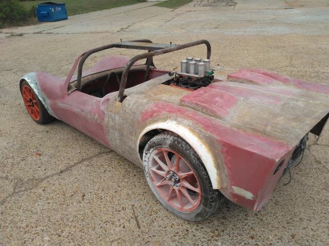

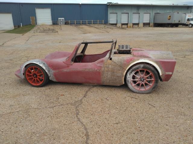

Most of the exterior is done.....still gotta do the tail end.
Next is laying up a coupler layers on the inside.....blending all the pieces together.
I have not gotten much done lately.The wife has been bad sick and some long hospital stays.
It is all back apart.

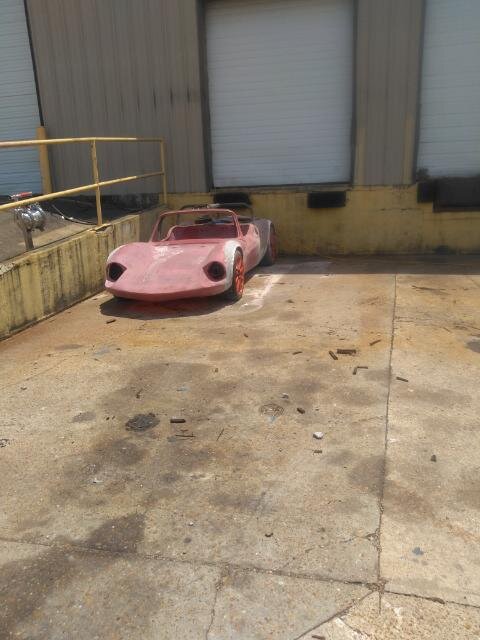

The fiberglass on the underside of the new body panels is done.....along with some small repairs.So body is ready to start smoothing/body filler/primer.
The flip up hood is half done with the underside fiberglass.
The back end is not done at all.

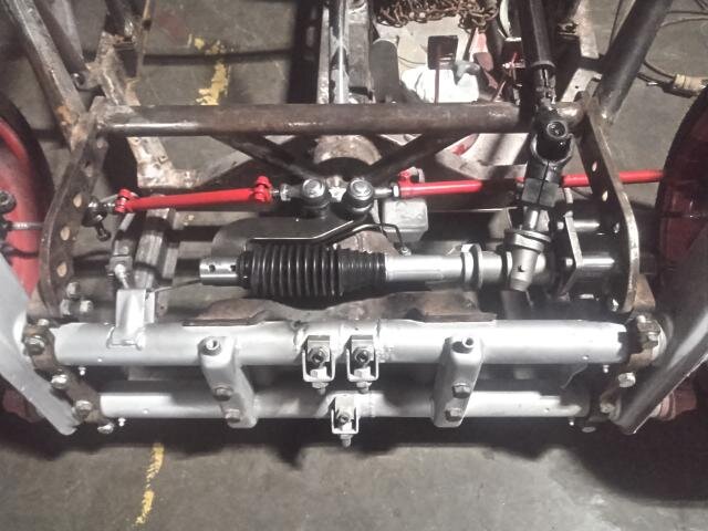

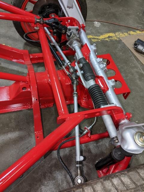

I changed my mind on the VW steering gear and got a small manual rack and pinion. So I am modifying it into working.
And then have started on making a gas tank and it's mounting.

Mine being mid engine will probably keep the front down. I think I am around 1500lbs.
It is still going together.
