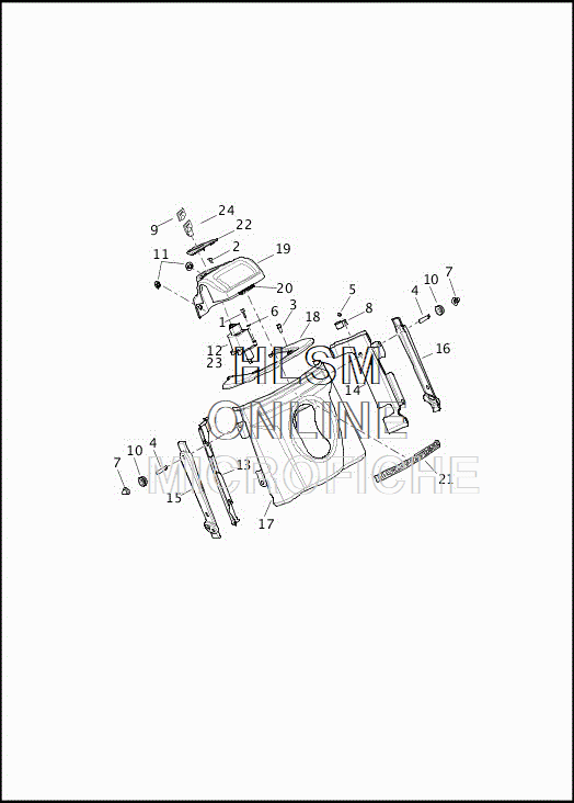

# 11 in the diagram
Yep, there are two black plastic caps there on my '21 FLRT. Perfect. Doesn't Harley sell a switch that fits that hole? All I found were entire wiring harnesses for specific things.

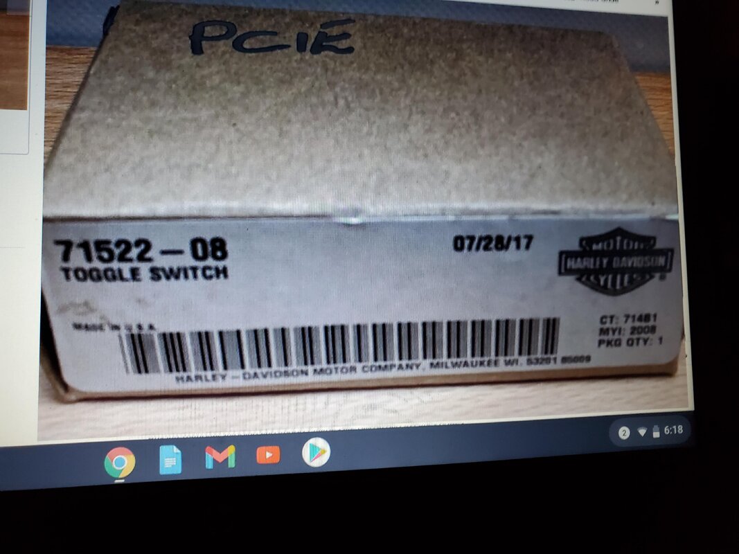

#2106-0217 Drag Specialties, HD part number is 71522-96
Both come with a wire harness, so you can source just a toggle switch from any Auto parts jobber, that is the route I would check first

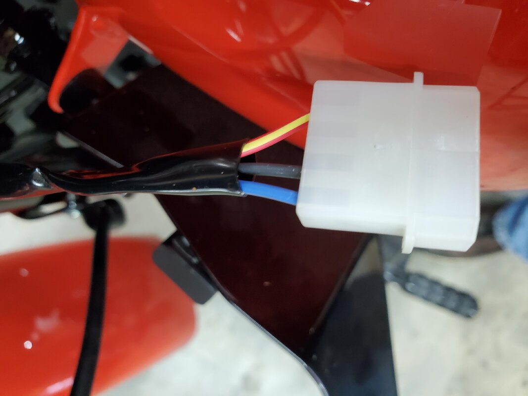

passing light switch

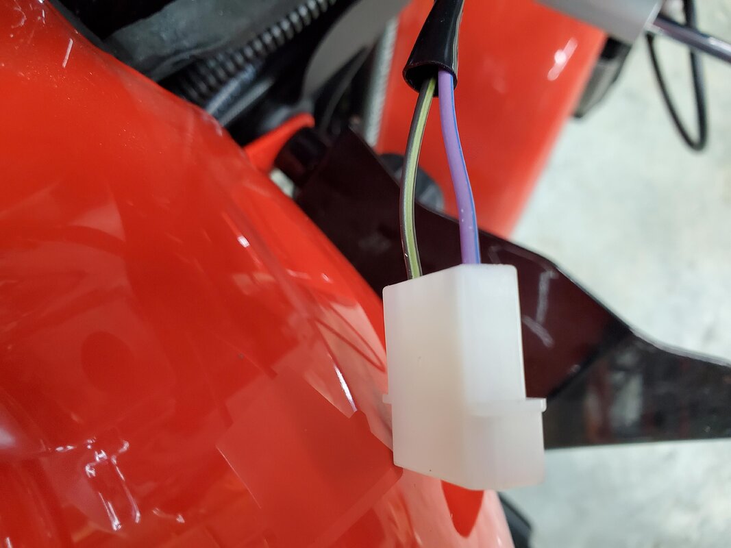

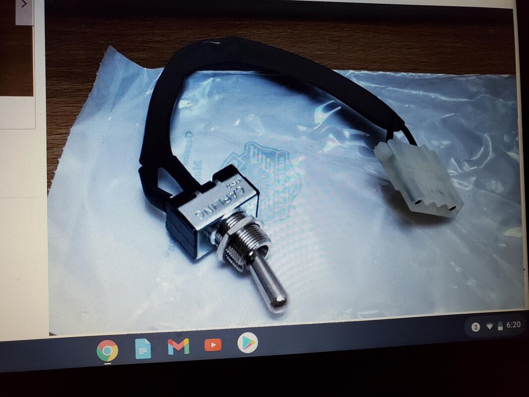

Here is the Harley switch and a couple of wiring connections, passing lights on on right side .
the left side I believe is for a cooling fan, both are just tucked in under the tank and held with a small
zip tie no need to remove tank.
