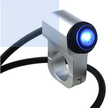

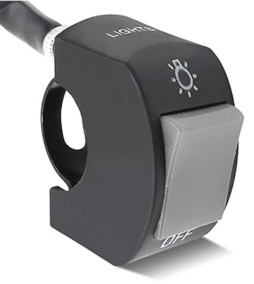

Down and dirty:at the headlamp harness there are 3 wires black, yellow( low)and white( high). You could use a posi tap on the yellow,run the wire back out the bucket to a switch mounted either side of the handlebar cover- plastic bungs are aleasy there. But you already know most states require lights on for motorcycles right?
