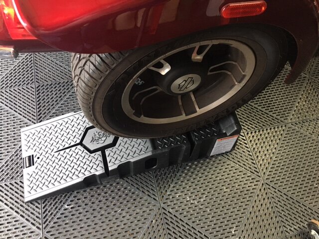

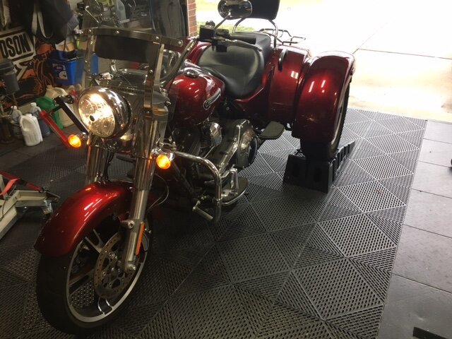

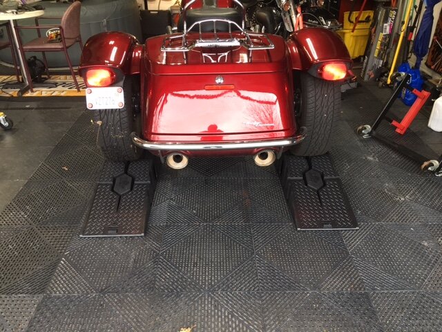

My flooring is a plastic "RaceDeck" type flooring and as with epoxy flooring it too can be a bit slippery. What I did was place the ramps up to the rear wheels and then gave them a kick to kind of wedge them a bit.
Then I slowly drove up on them. I was a bit timid when I got to the top of the ramps until the tires hit the stops.
Anyway, the only YouTube video I could find the guy jacked up the rear and then slid ramps under the tires. In that video he uses the typical metal ramps that I suspect "pushed" when trying to drive up on them hence the reason he jacked the trike up instead of driving up on them.
I've used those metal ramps before on other vehicles and too had them push when trying to drive up on them. That's one of the reasons I got rid of them.
However these Rhino ramps seem to be a bit better as they have a rubber pad right at the edge that protrudes through the ramp. So when you roll up on the ramp you roll up onto the rubber pad then the tire pushes the rubber pad down onto the floor.
You can see in the picture below where the rubber pad protrudes through the ramp. Also these ramps are a bit wider than the past ones I've used which is nice as well.
I got these at Walmart for $40.
