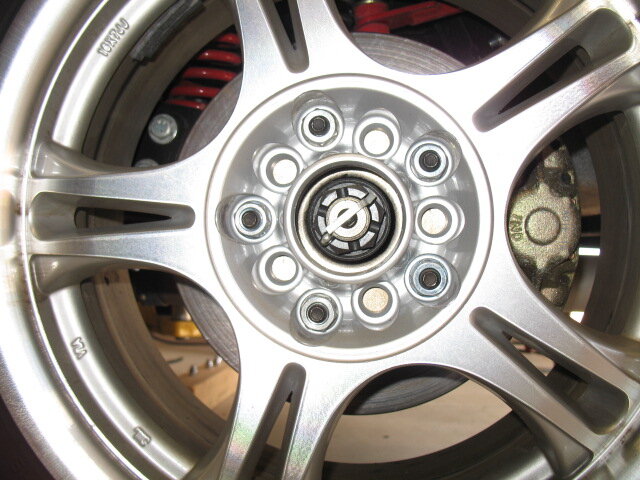

My 06 with a 2012 Road Smith has 5 lugs.

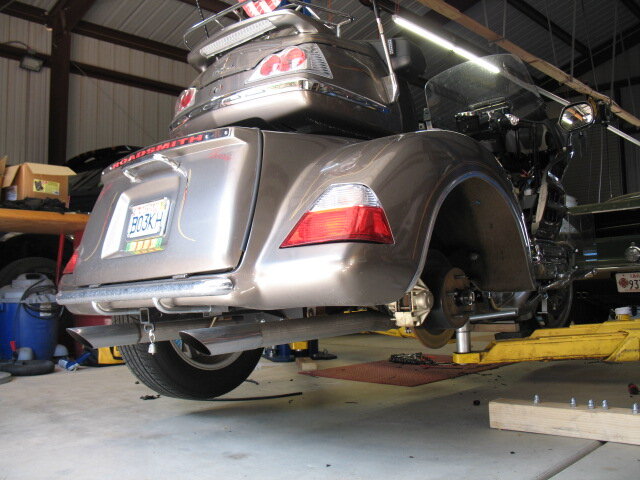

I lift mine with a 10,000 two post asymmetrical BenPak lift.

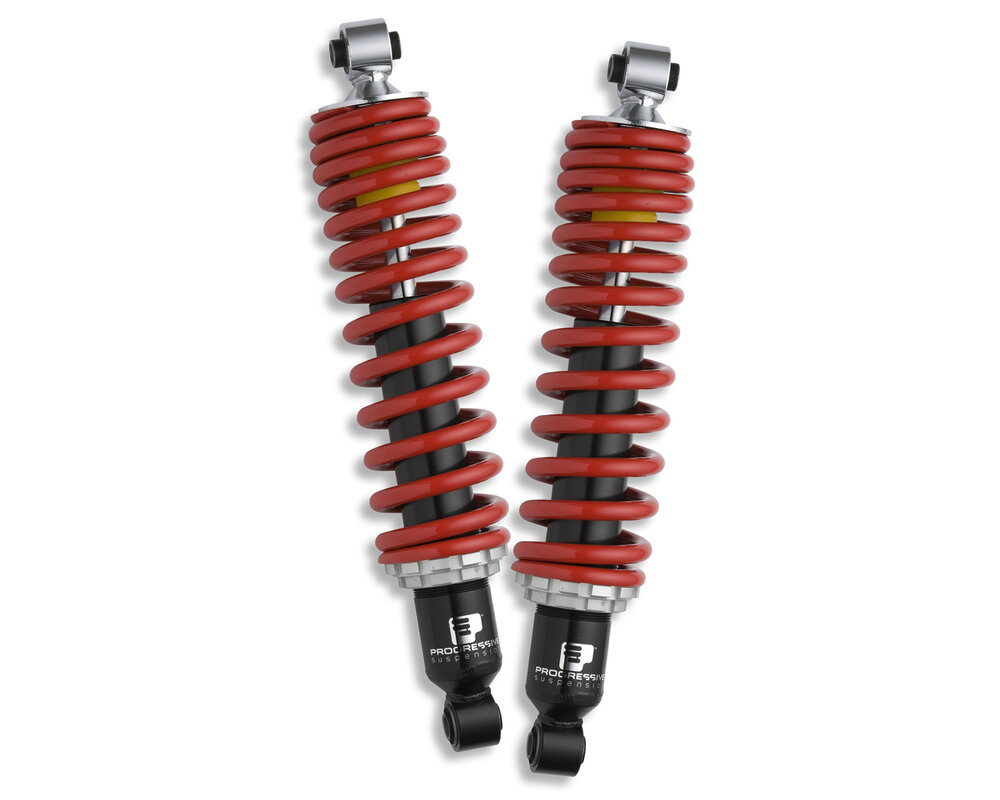

Roadsmith and maybe others.... #00-9570-8 for 1969 VW Beetle Coil Over
11.25" Collapsed
16.75" Extended
5.5" Travel
1.9" Piston
700# Rated

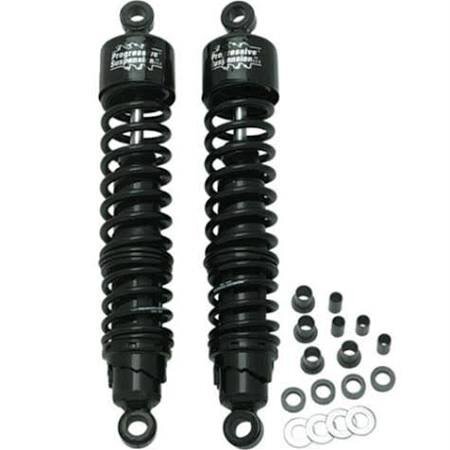

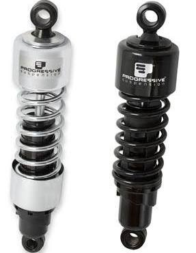

another option is #49307 Gabriel Air Shocks.....
Progressive also has various models that will work......
