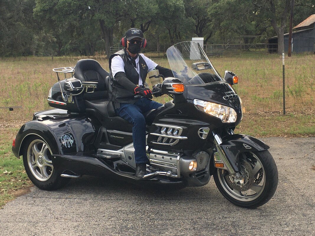

At what age do most owners replace their tires, or is it always by mileage? I have two 2012 dated Nexens on my RS, with only 17,777 on the trike. They look brand new, but they are not. Should I replace them due to age, or ride em till they’re worn out?
On the topic of rear tire to front on a trike I”m baffled. The rear tire on a two wheel GWing is 16”, the front wheel is 18”. Do you put the 16” up front and replace the 18” totally, wheel and all, or do you look for an 18” tire with rear wheel measurements? Help me understand please. Thanks in advance. I don’t have a rear wheel for the front.

On /With Trikes the front tire wheel rim is an entirely different size than the rear tires. You do Not ! rotate them when they wear you replace them with , like sized as the originals,.. just me, mind you, but I’m a maverick I don’t go by age or miles. With tires when they get down to the wear indicators that’s when I’ll change them.. Now saying that if the sidewalls look cracked or dried out, then I will change them..

I’m tempted to agree with you on the age vs. mileage thing. My tires look fine, but they are almost as old as the trike! SO how do they put a rear GW tire on the front of a GW trike? That’s what I don’t understand. Thanks for tuning in.

I think you misread his post. You do not put a rear Wing tire on the front of the trike. Instead, you find either a trike tire (Avon trike 18-inch tire) or find an 18-inch rear tire like the Bridgestone BT46 and put that on the front (run it backwards.
As for your rear wheels (car tires) - they are 11 years old. Even if there are just 18K miles on them, I would be inclined to replace them.
Use a flash light and check the sidewalls and inside the tread for cracking
If your tires show signs of cracking replace them for sure
Tires also have manufacture codes on the side wall, if your tires are more than 5 years old I would replace them JMO

Ok, that makes sense on the rear to front business. On the rear trike tires, with only 18K, it seems like a waste, and a way to sell new tires. I know the cautions, but….damn. Thanks again.

Front tire is marked 2014 mfg. It is obviously worn and slightly cupped. That’s why I”m curious about the rear in the front idea. Probably time to replace front tire one way or the other. Thanks again.
