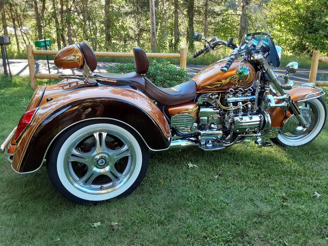

Thanks for all your responses and help. My trike is a Honda Valkyrie which was done in 2018, the rims that came with it are aluminum alloy 215-55r 16 and I also had whitewall tires installed at the same time.

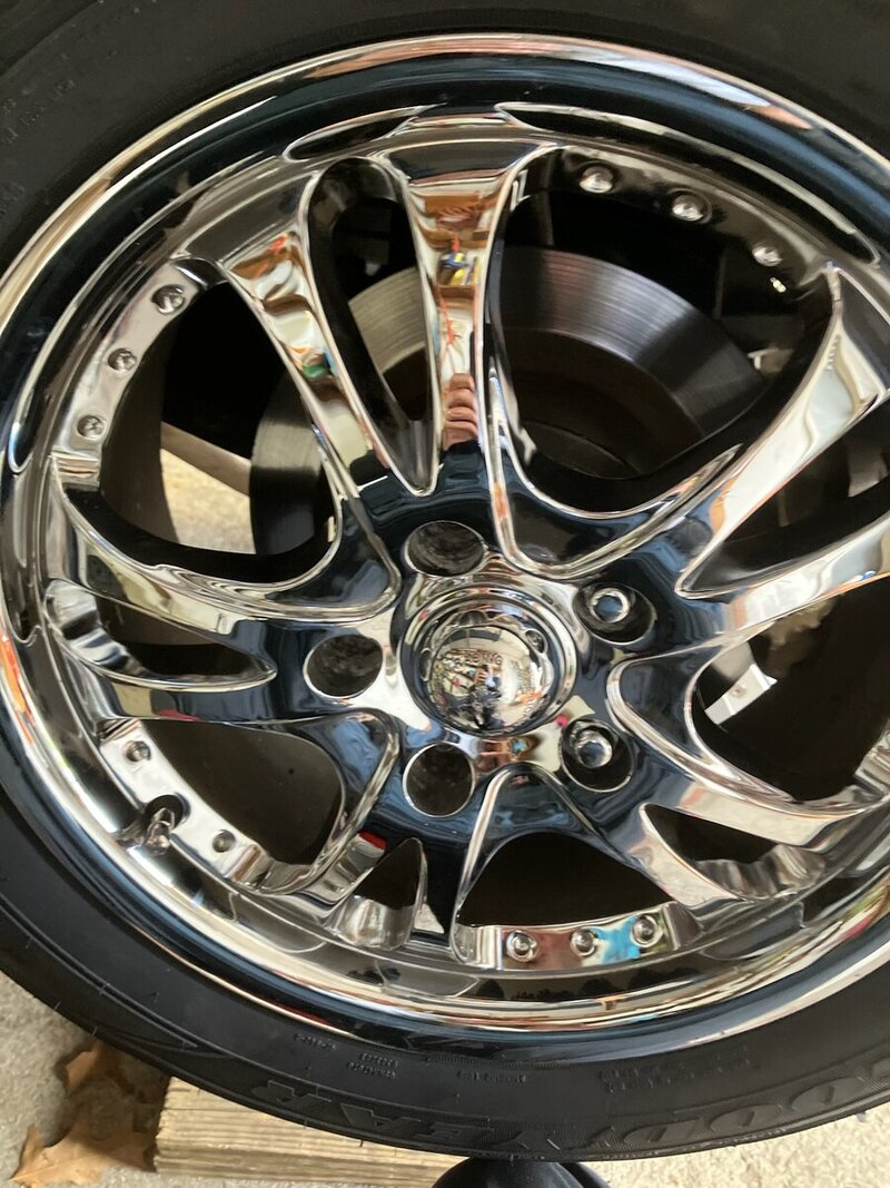

I now wanted to upgrade those rims to chrome and Roadsmith has them as an option (attached photo) I now know everything will fit perfectly so I figure the best way is to order directly from them.
