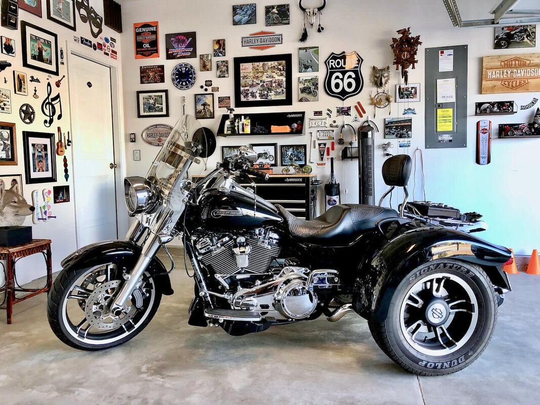

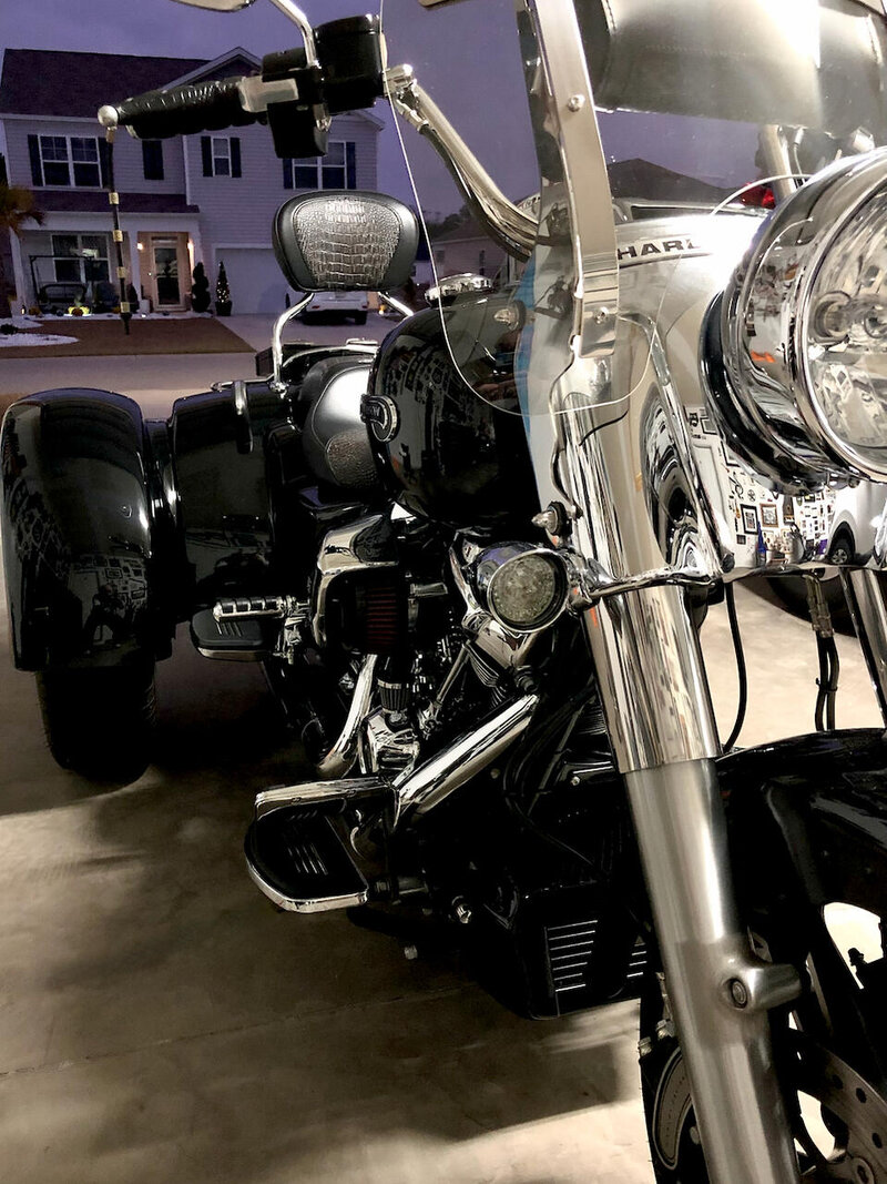

I think this is an interesting post. I personally have not experienced this occurrence myself. I like the "close the garage" and keep the heat in concept. I personally do leave the garage door open when I pull in for probably 20 to 30 minutes while the bike cools down, something I have always done with every bike we have had. I have no gas smell ever, no exhaust smell either. I do lean towards agreeing that a new bike (with that new bike smell) could be a minute burning off the newness. My 17 FW does not leave any odors ...
