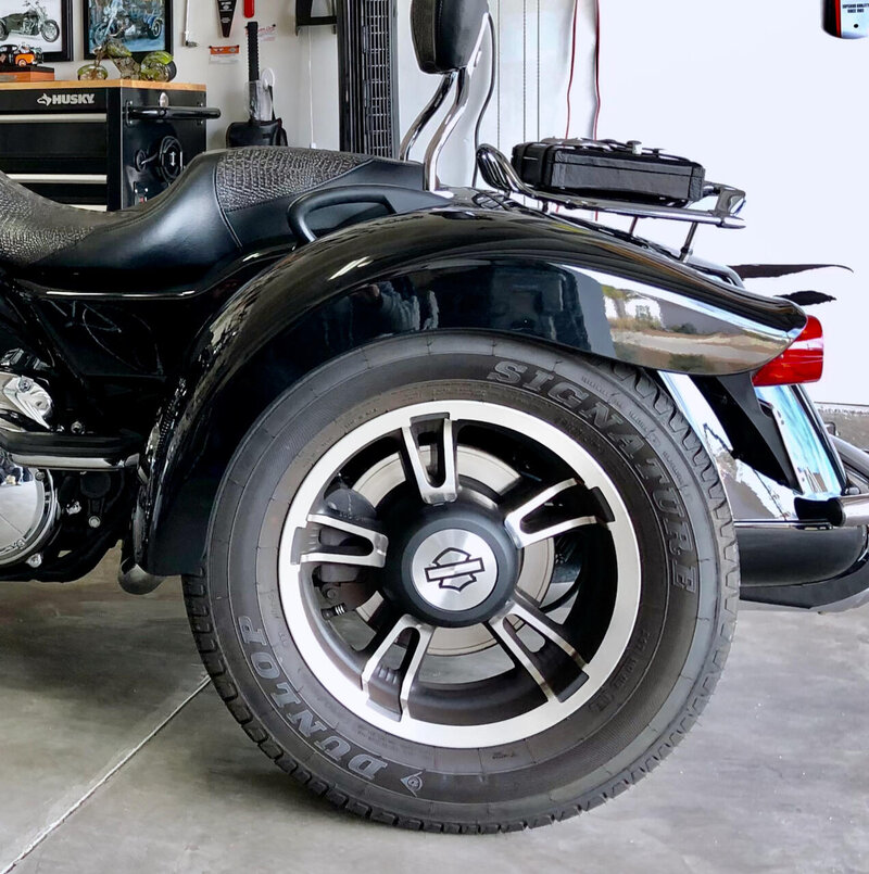

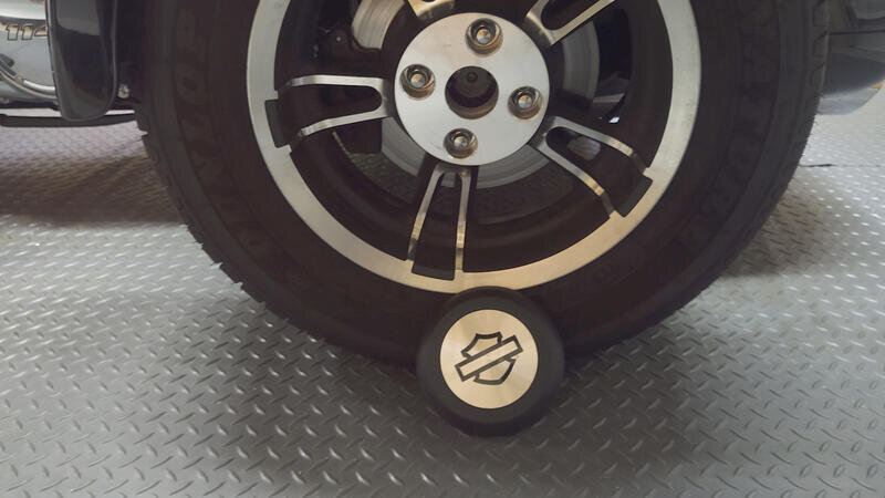

So to check the torque of my rear wheels lug nuts obviously I 1st remove the "hub cap" (if you will) ... I'm sure there's a simple easy way to do this although there's nothing in the HD Manual and nothing I have been able to find online. Any input is always greatly appreciated. Thanks

Just grab it and pull it off, check the inside fingers of the hubcap for cracks and or missing fingers
I ran a strip of duct tape around the fingers for a tighter fit
Torque the lugs to 100 ft lbs, check it once a week good to go
