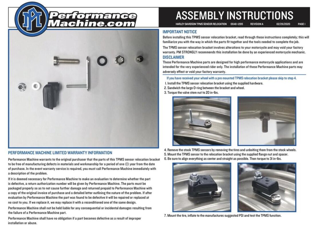

Found where PerformanceMachine.com makes a Harley TPMS adapter for aftermarket wheels. I've searched on their website and can't find it, but eBay sells them for $45. You basically use a threaded valve stem to hold a flat plate with a stud on it inside the wheel. Then you mount the Harley TPMS over the stud and secure it with a nylon locking nut. Pretty simple actually. I happened to find someone who posted the directions on another website and posted them below for reference.

Is this what you are talking about? Looks like/sounds like the same thing my dealer did.
Performance Machine TPMS Sensor Bracket Assembly For Harley - RevZilla

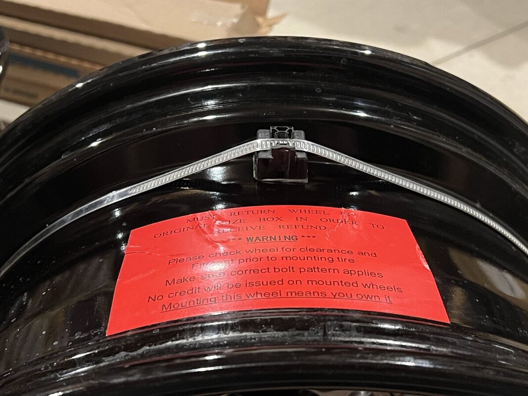

what I did was purchase a 48 inch zip tie and a 4 inch zip tie. The 48 inch zip tie went around the inside of the wheel hub and the 4 inch zip tie held the TPMS sensor to the 48 inch zip tie. WORKS!

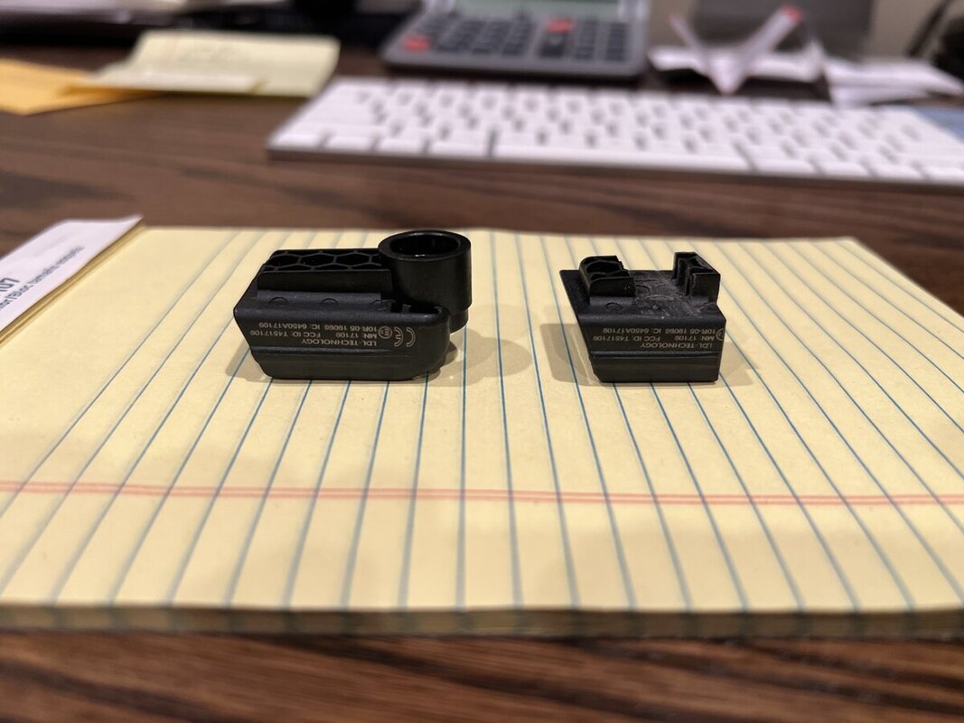

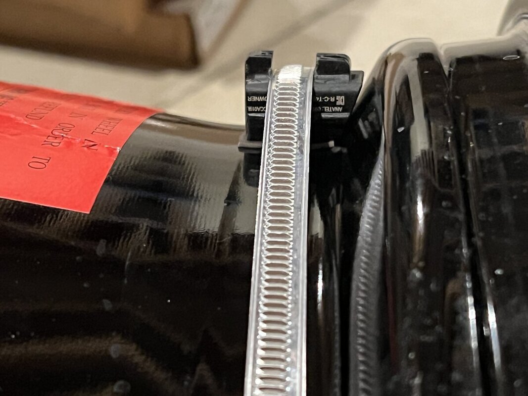

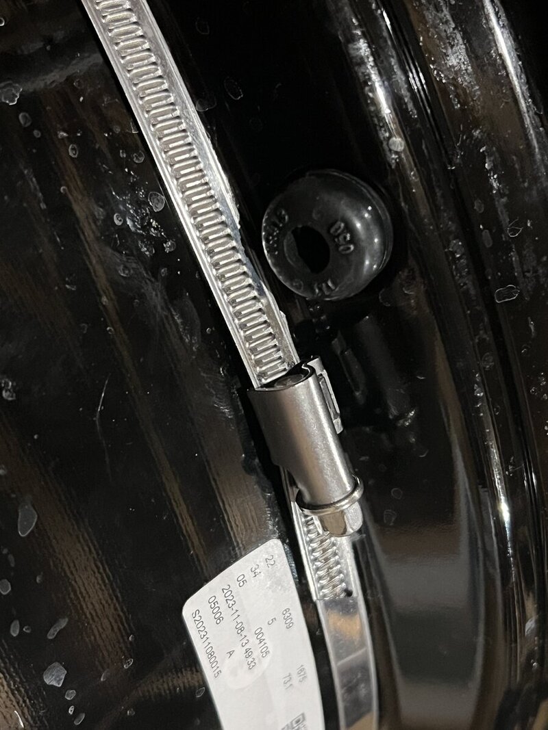

Finally getting around to mounting the Harley TPMS sensors in the aftermarket wheels that came on my Roadsmith kit. I cut down part of the plastic case on the sensor and used a metal TPMS band for a Ford wheel. Taking the tires up later this week to have them mounted on the rims, then back to Harley to program them.
I wonder if this will throw off the balancing of the wheel and need to be rebalanced?
Probably will. I took off all the weights when I cleaned the rims up and will have them Road Force balanced again when they put the tires on. I did put the screw part of the clamp opposite the sensor so it would offset it some. I also put 3M VHB (very high bond) tape under the sensor to keep it from spinning on the rim and getting out of balance as well.
