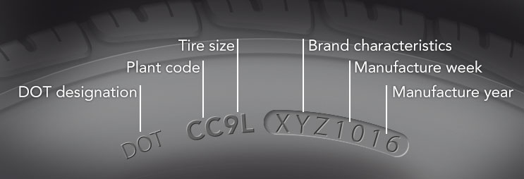

Look at the tire DOT number, it will give you the date of manufacture
To my knowledge no trikes were shipped from the factory with Goodyear tires
Here you can see an example of how to read a tire DOT

Joe even though the tires look great you have to make a decision for yourself here. From all the reading that I have done, most tire people say to replace tires when they are 6 to 8 years old depending on who is making the statement, I have read both.
I will give a personnel example. I am a Captain with the Sheriff office here. 3 months ago one of our Lt's., who assign admin vehicle is a Chevy Impala, was driving to work when she started feeling a thumping. She stopped at my house and I noticed that one of her tires was starting to split open in the middle of the tread. The tires were 5 years old with only 20k miles on them. From the outside they looked in excellent shape, but they dry rotted from the inside. Tires were all replaced.
Now I'm not saying replace your tires, I'm just saying what I have read and giving an actual example. If it were me I would take the ride, but I would also be looking at replacing the tires when it was convenient.
Trike rear tires will wear forever because of the light load on a tire that was designed to carry a heavier load. So that leaves the replacement decision up to the owner. Those tires may very well be in great shape BUT you cannot see the inside of them.
