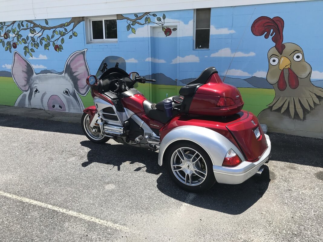

I 've been reading much about putting in only 22 lbs in my rear tires, for a smoother ride, instead of the much higher recommended amounts suggested by my trike builder..
My ride is not as smooth as I had hoped, before triking........
2010 Honda Goldwing/Roadsmith model
Won't this lower pressure wear out my rears faster???
I ride "both" back roads as well as highway riding (70 MPH ish)
I am not a cowboy with my trike, (I baby it) I ride the speed limit, and enjoy a relaxing ride......... BUT I do many long distance trips.....

Ronnie, I have been riding the VTX you saw me with for over 6 years with 20# air in the rear and 40 in the front. That recommendation came from experts right here on Trike Talk. You are not carrying the weight of a car with you. My tires wore perfectly. I just replaced them a month before I sold it. Don't remember the date codes. I personally put 25,000 on them. Don't know how old they were. Could have been original tires. It had 58,000 on it when I sold it. I did put a BT45 on the front and ran it backwards. It was still going at 28,000 miles.

22 LBS in rear will be tried............I'll report back in a few days, after reducing the lbs in rear's

I finely had a good chance to ride my newly lowered tire pressure (22lbs) a good long distance.... and I took it on a long ride to the Vermont area (now be advised, too, those that don't know these back roads, in Vermont, I can tell you that some of these roads are so bad that it would "jarrr" your back teeth.....BUT these roads are also long, sweeping, no traffic, wind'ie bike perfect roads...
I went a total of 189.6 miles Round trip from my home.... Vermont border is 60 miles from my front door......Anyway I LOVE THE TIRE PRESSURE LOWERED DOWN TOO 22LBS., I FOUND THE RIDE SO MUCH SMOOTHER...................SO THANK YOU TOO ALL THAT RECOMMENDED ME TOO LOWER THE REAR AIR PRESSURE...........It's now a pressure to ride my trike again..
