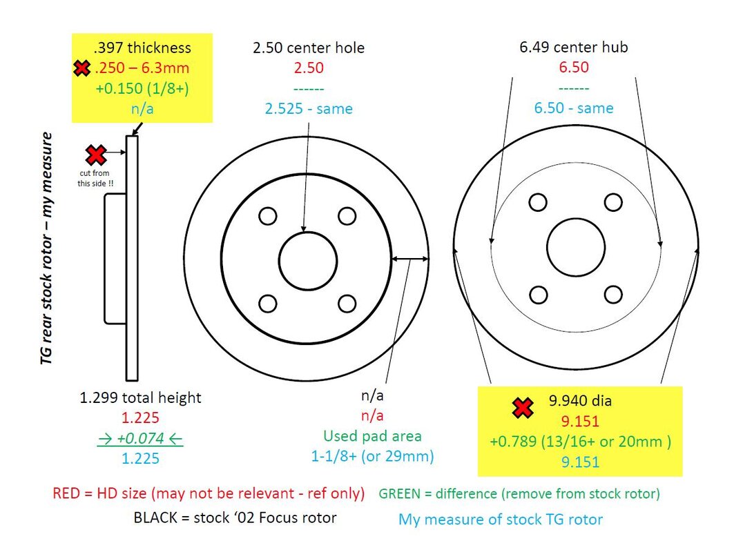

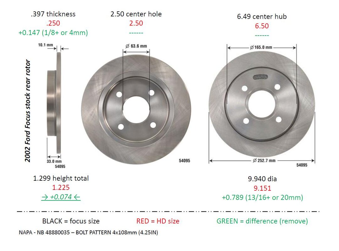

I can't remember who ..... and I thank the person who made these drawings. Please double check everything yourself before cutting. ThumbUp
View attachment 31425View attachment 31426
The only measurement that is missing & quite vital is the distance on the inside of the top hat from the surface that sits against the hub & the inside face where the pad brakes against.
It might make a difference where you remove metal from the rotor surface. How much on what side. Because that is what controls where the rotor sits in relation to the caliper.
One other consideration is the ring around the center hole. Does Harley have one? And what size? That has to fit inside of the wheel.
That was me... :cool:
I thought I clarified this ..
notice the markings on the drawing say 'cut this side' ... or did I forget to add that... I have to review. I know I took that measurement, thus allowing me to be sure of those drawings. Everthing was compared side by side thanks to a gentleman from West by God who sent me his replaced/unusable rotor.
I checked ............ YES -- check the red/yellow highlighted 'X' ... machine from that side. unless my math and eyesight both went ... ?
AND BY ALL MEANS... if you find a mistake there in those drawings, PLEASE let me know...

You put the cut this side, but there is no measurement of the inside to the inside rotor surface.
If you measured that then great.
And also is the Harley rotor smooth around the center hole, or does it have the ring as the Ford rotor shows in the drawing? That lip serves a purpose of supporting the wheel to keep part of the pressure off the lugs. If Harley doesn't have it that could part of the problem of the lugs coming loose so easily. I don't have one off to check.

No, not just the hole in the center, but the raised ring around the hole. I don't know if the HD rotor has the raised ring or not, but it is shown on the ford rotor. Actually it is a good idea as it takes part of the impact off the lug bolts by supporting the wheel somewhat. And centers the wheel with the rotor. It can also be a recessed ring.
But if there is one on the Ford rotor, & none on the Harley rotor You would have to cut it off, or machine the matching relief into the wheel to go over it.

ok... the HD rotor has no 'raised ring' in the center, nor is it recessed. Now the hub on the TG obviously has the raised portion in the middle that fits on the rotor. Id have to see a pic of what you are talking about, I may still be confused .... OR maybe ill post some pics of the HD rotor I have. let me dig it out, it can only help.
If you will take the time to just look at the pix you have posted in this thread it is obvious in the right picture. In fact I copied your picture into my last post.
Look at the right picture & the ring I am referring to is obvious. But I think after searching online for an actual picture the ring is actually a recessed ring.
