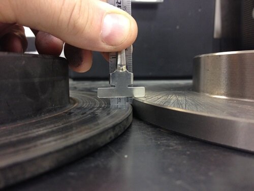

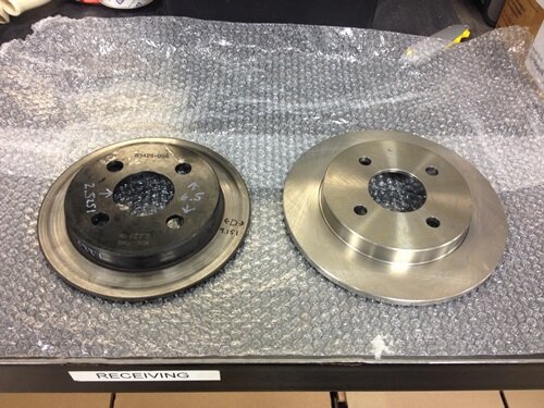

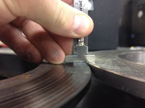

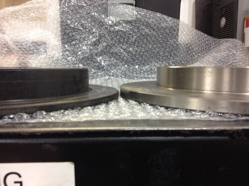

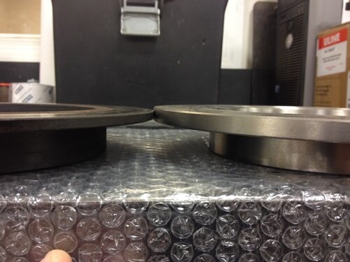

ok folks, the news we have been waiting for ... the stock rotors from a 2002 Ford Focus can be machined to fit. They are a match. Now im sure of this.
Its been a rough couple of weeks, so i havent gotten to cutting and drilling them yet. I have the 'drilled' pattern' template done also......But at least i have physical proof .. some reason i cannot upload the pics, the uploader keeps crashing here ...... i can email em to anyone who wants em ... send me a message, and ya can tell me what ya'll think.
If i find a way to 'make the pics load' here, i will put em up.
here they are...

I too have confirmed this. 2002 Focus REAR rotors are pretty close, the bolt pattern is the same. From NAPA the rotors are less than $20, price today is $15.00 each through my business. I took the new rotor and one from my trike to a local machine shop and they said around $50 each for machining. That would be around $150 total for a pair of rotors. That to me is reasonable, as opposed to the alternative!

AND .... the larger rotors now are a larger DIAMETER only ... I have seen them. They look like the same thickness. But I will find out what max thickness could be with new pads...

Being a tool maker i find this very interesting.So my first question is,with the rotors sitting on the braking surface as in the first picture what is the distance from the top to the first braking surface.Will the thickness difference be taken equally from both surfaces or just one.And is this for 09-13 trikes or 14 and later. Okay after looking at the third pic it appears that stock will have to be removed from both surfaces.This is great info. Please keep it coming.Looks like i will be going to the parts store this weekend.
