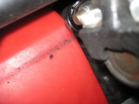

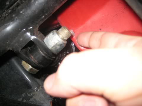

There you go, Spirit...... and Joe knows how to post pictures, too, so he can show you in person :D.
Here's photo's of what Wally was talking about. Sorry it took so long to post them tonight.........
