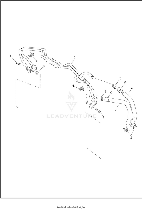

I live in the UK and bought a CVO Tri Glide in September 2021. I love it. However, the radiator to engine outlet hose has failed and HD UK cannot source the hose anywhere within the UK and Europe, the HD part number is 26900114, it’s on back order without an expected delivery time. HD UK will not permit my dealer to source any part from the USA, which I found out after many emails from my dealer. I did have a conversation with John Bennet from Adamec HD, Jacksonville, Florida last week (we were on holiday in Florida), he was really helpful but needed my dealer to purchase the part and then he could courier it to the UK.
Can anyone buy the part for me and courier to the UK please?

WTF is the matter with you? You think HD makes it's own hoses? You said this was an emergency.
Same here I would go to a auto parts store and find hose to match up, there got to be a heater hose of some car that can be cut to fit .

Just as an FYI, my dealer, like others here, suggested you go to an auto parts store and get them.
Good luck
These coolant hoses can be matched up @ an auto parts store, Harley does not make them they would source them from a hose vendor, the hoses are nothing more than a preformed 1/2 inch heater hose
I would take the hoses in hand to an auto jobber and match them up, these hoses
should NOT void your warranty # 6 and 7
