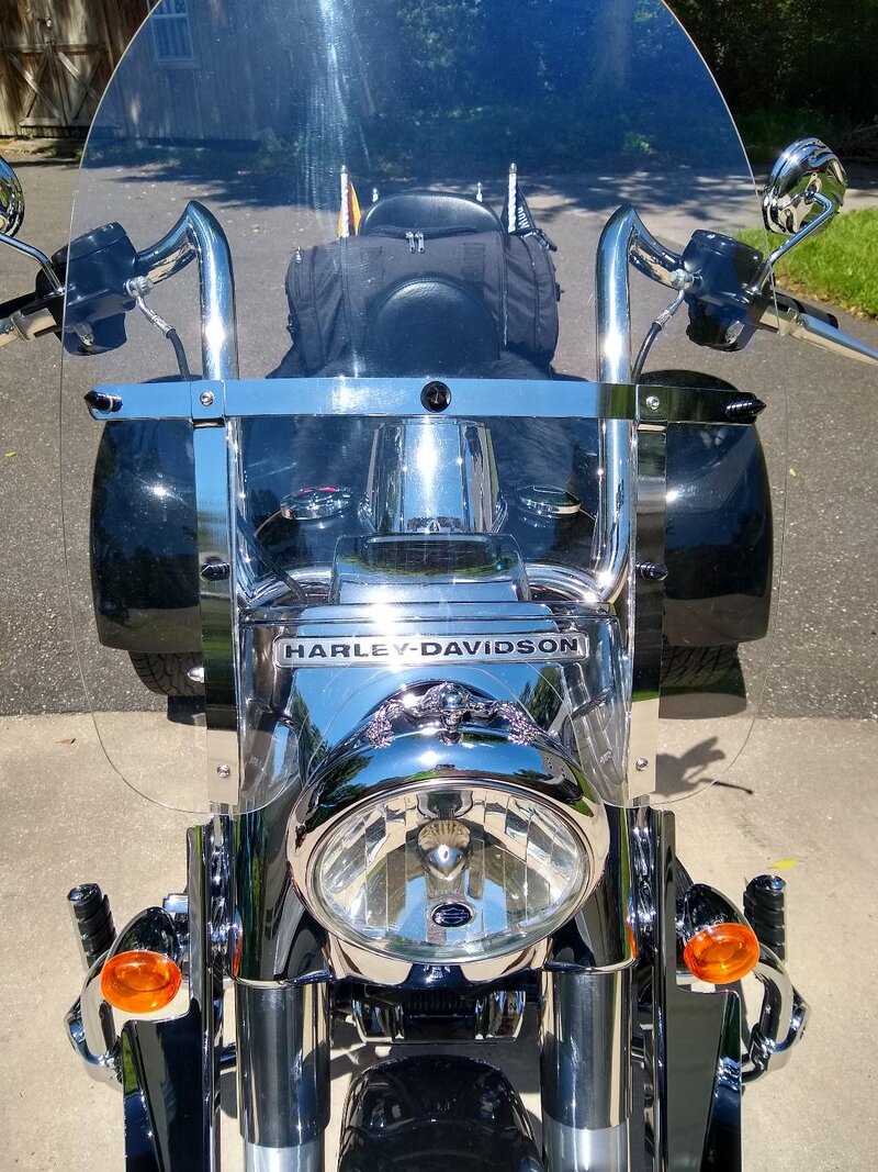

Hey riders, I need some advice. I live in a rural area and it's very dark at night. Last night I almost wiped out into a drainage ditch because I couldn't see. I had a factory light bulb in my headlamp and switched it out for one of those $15.00 LED bulbs a couple years ago. That helped a lot but I'm still having problems seeing. So should I buy a regular 7 inch LED headlamp, the brightest I can find or add a passing light bar? Which would be brighter? Here's a picture of my front end, do you think I have the room for a light bar? Thanks.

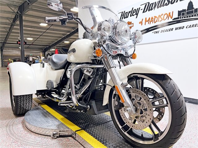

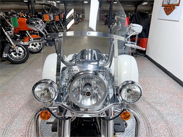

Probably get varied opinions but I would add a lightbar. The two added lights will give you a wider lighted area to be able to see the sides of the road better.
View attachment 113051View attachment 113052
Ah ha, I didn't think about a light bar giving a wider light. Thanks Ol school. I was thinking on getting a brighter lamp in order to save money but you can't put a price on safety. Those are not hard to install and it gives me a new project. Cool! Nice trike BTW
The Freewheeler in those pics isn't our trike. I just posted those pics so you could see what one looked liked with a lightbar installed...

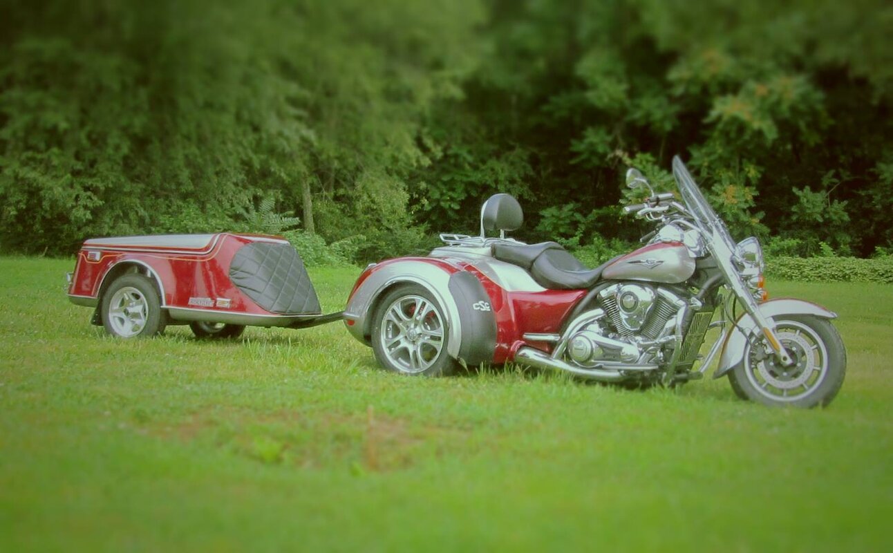

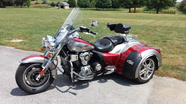

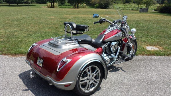

This is our trike...
The light bar that fits the roadking will work. I found a police electraglide light bar complete with buckets and signal lamps( didn't use) on Fleabay.I added led lamps to the buckets. Write ups on how to wire them up can be found elsewhere on this site. The first thing I did when I got my Freewheeler home was order the JW Speaker dual burn led headlamp but cheaper ones can be found online. There is some adjustment in the Auxiliary Lamp( HD term) buckets so I have the right bucket slightly aiming at the right shoulder as it's very rural coming down the mountain from my hilltop fire support/ interdiction base to the 4 lane.
