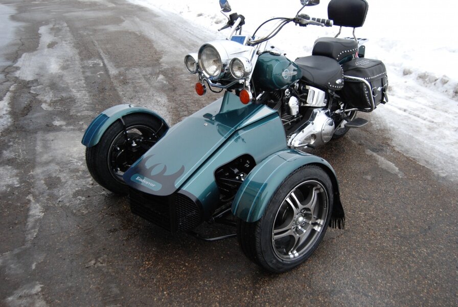

Endeavor trikes all incorporate a 14" thermostatically controlled fan in the nose housing that will come on whenever the engine reaches 200 degrees. (jugs) the airflow is inline with normal air flow and simulates riding at 35 mph even when stopped. I have done HD and Victory with this setup and it does work well.
The fans reverenced above are probably a good idea and will help with engine longevity in the long run. While an oil cooler is a good idea it will not help with the jugs getting overly warm so any added cooling there is a good idea. Much of my time in R&D has been dedicated to airflow not only for cooling but regarding handling and aerodynamic profile.
