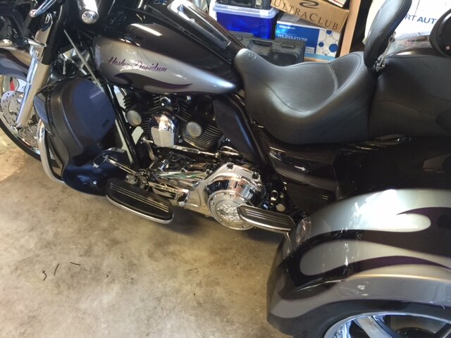

I have a set of Wards Parts Werks fans I would like to install on my new 2015 Ultra Tri Glide.
They came off my 2010 Street Glide and were wired into the "B" terminal under the seat.
I contacted Jason who makes the fans and asked if the 2015 had a "B" terminal so I could plug in the fans.
He said the 15's do not have the connector.
My question is , how did you guys wire them up ? Did you connect directly to the battery or somewhere else.
Thanks for any help you can provide.

I had mine wired up directly to an auxiliary switch on the 'dashboard' of my TG. The fan button is right next to the passing lights button. It's a really neat and fairly inexpensive way of doing it if you have any technical nohow.
The switches and harness cost $80 at the Harley store, and you have an extra button if you have something else you want to hook up to it in the future.
I didn't hook up the thermostat switch at all. I just leave the small switch on the side of the fans on at all times, and I control it from the console.

just got my fans the other day waited a long time for the chrome ones and I'm glad I did.now once the rtv silicone cures on the snap switch I will wire it directly to the battery.just take off the seat and fish the wires to the battery making sure they are all tie wrapped away from the engine
