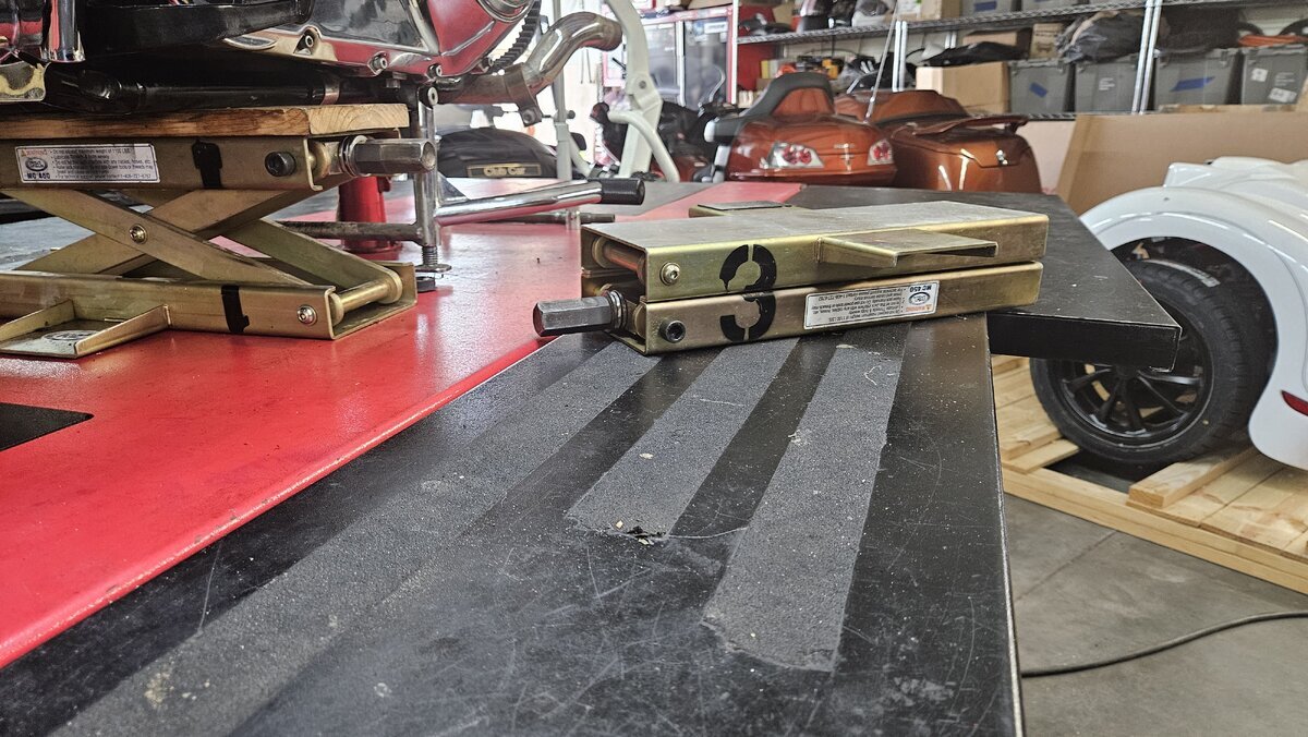

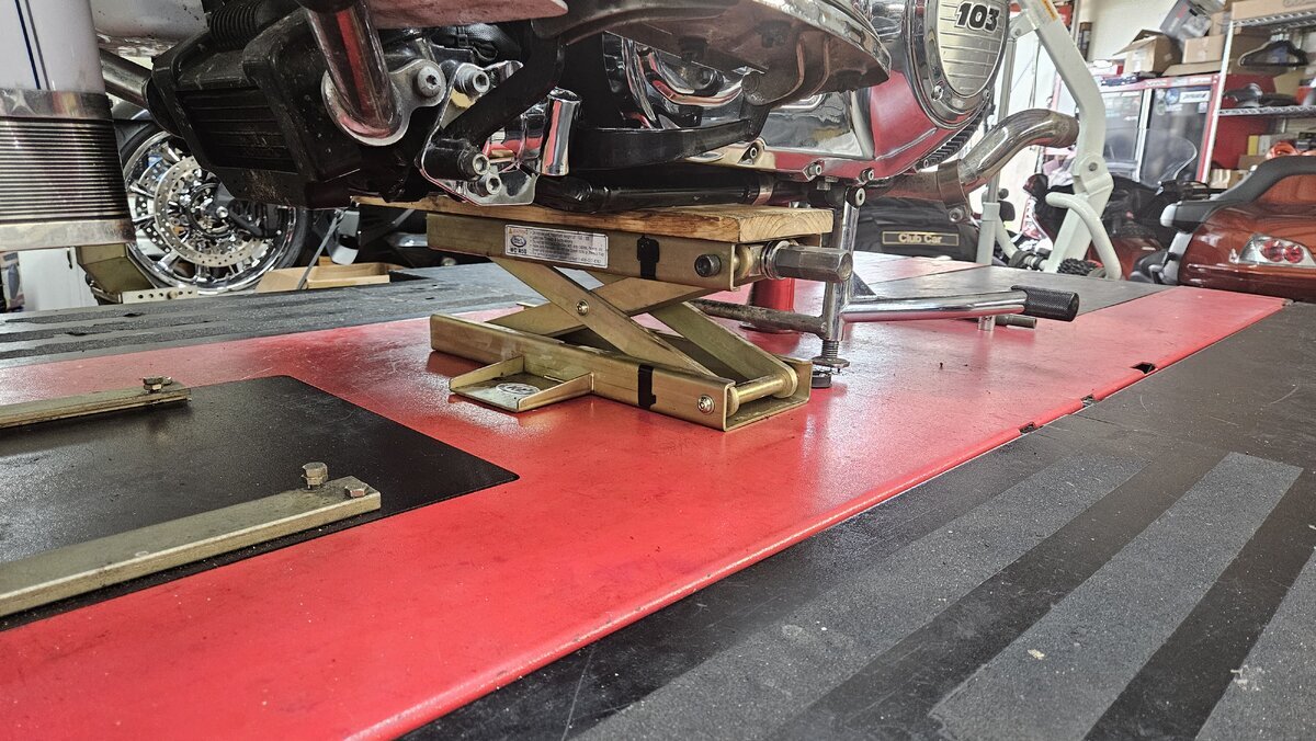

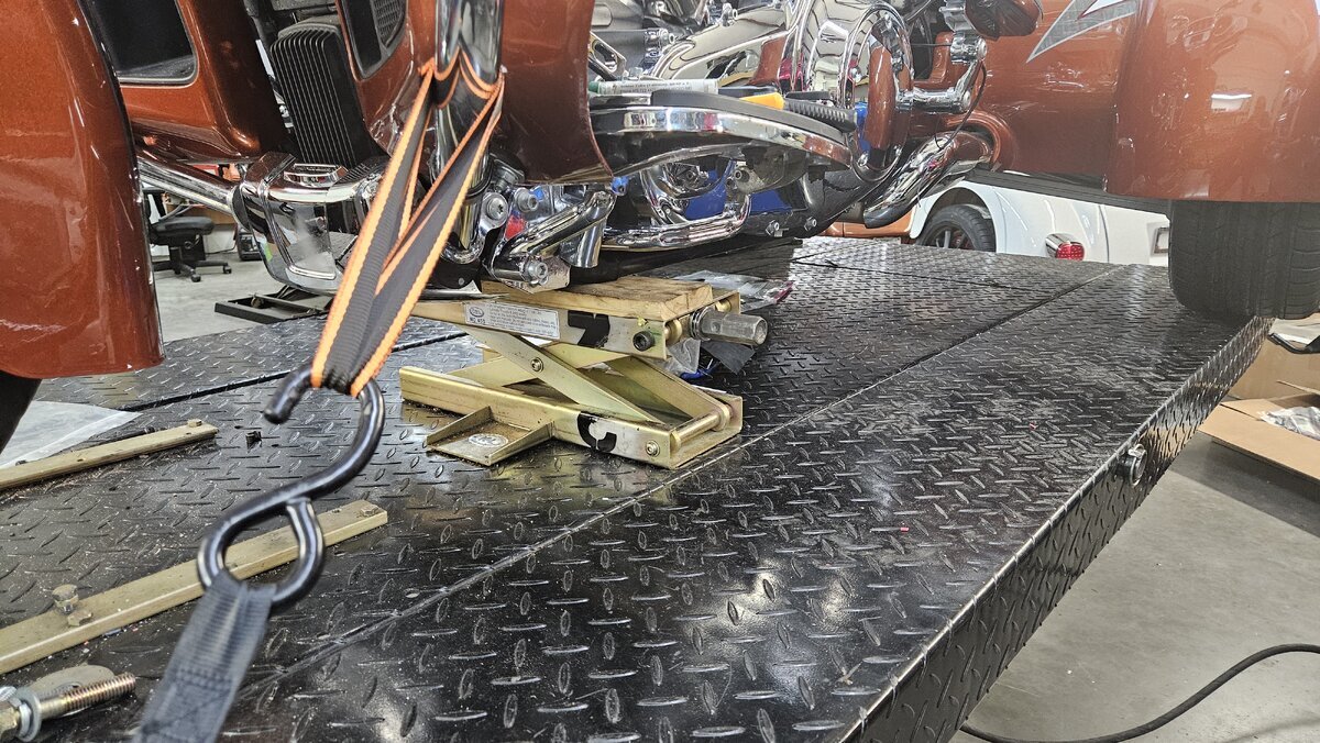

One of the best and most used/useful tools in my shop are my half dozen K&L M450 scissors jacks. They are pricey, but worth their weight in gold. Whether working on your trike from your lift or from the floor, these will slide right under your trike including lower-slung conversions with running boards.
I stenceled black spray painted numbers on mine because they get so much daily use that the thrust-bearings will eventually start to fail and I have to replace them, so this helps me track which ones I have serviced.
(Pro-Tip: Using an impact driver to expedite the raising or lowering of your trike is not conducive to extended thrust-bearing life.)
Years ago, my now ex-wife bought me a Black Widow lift table when I was still blasting around on 2 wheels. I ended up purchasing the extra 12" wide side panels as well as longer ramps to make loading and unloading easier. It came with a similar scissors jack and I agree, they were great for stability. Unfortunately when I went to 3 wheels, especially the CSC which is 60" wide, I could no longer use the lift table because it was 48" wide even with the wider side panels. Black Widow did not make any wider side panels for it. It sat for a couple years just taking up space in the garage. I ended up bartering with a contractor with it to get some work done to my house. He happened to see the scissors jack and wanted that too so it went with the lift table. Bad move on my part, I wished I had at least kept that jack.
Resist the temptation to by the Harbor Freight one, its junk. I burned through a couple of those way back and for my use they are worthless.
