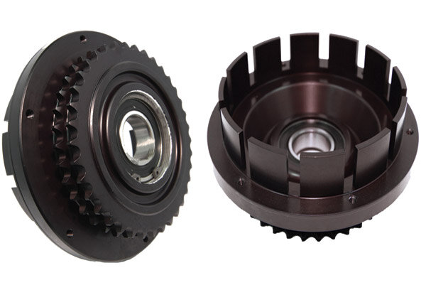

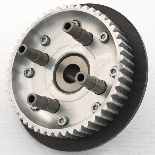

I don't suppose any one has a really good clutch basket for a (tapered shaft) 1989-1993? 80" evo.
Mine is pressed on the shaft by tightening the clutch hub bolt. Has a key also. Is removed with a hub puller.
I see an aftermarket basket for $340.00 in a catalog. should fit my clutch guts.
