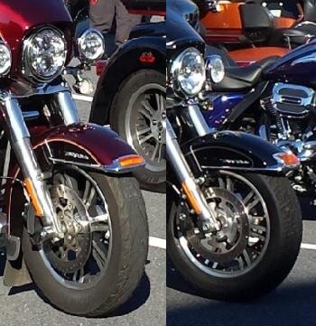

Replaced with Michelin Commander II REAR tire 130/90B16 and I now have 13K miles on it and it still looks like new. I expect to get 26K out of this tire.
Rear tires have almost twice the tread depth as a front. I mounted it in reverse direction per Michelin's instructions for mounting a rear tire up front.
Michelin left .... stock right. It has a flatter profile which IMO adds a bit more contact patch.
