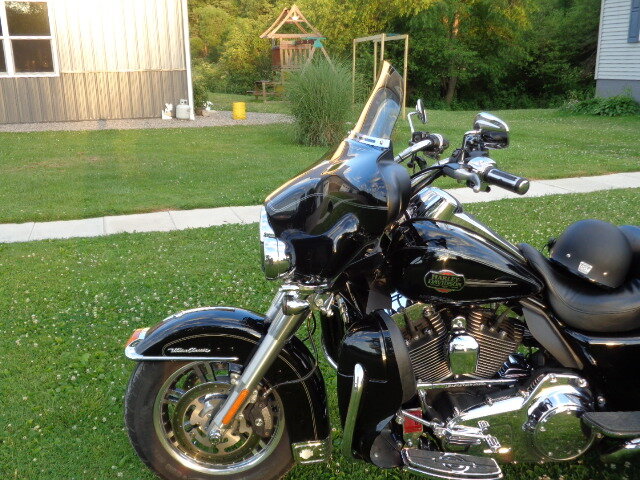

View attachment 87860View attachment 87859

Suggest KromeWerks 2+2 Narrow sweepers. They work well for me and I am also 5' 10" .
The 2" higher and 2" pull back sure makes a difference on a long day's ride for sure. :good: My smashed right wrist needed a little straighter grip the Wide one's gave me. Fred
I just installed the 2+2 narrow sweepers on mine and really like them. Mine is a 2011 all I had to change was clutch cable.:clapping:
12" rise is the maximum you can go without having to change the front brake and the clutch hydraulic lines. You will need to add the short extension jumper for the handle bar switch cables but the existing throttle by wire cable will be long enough as is.
