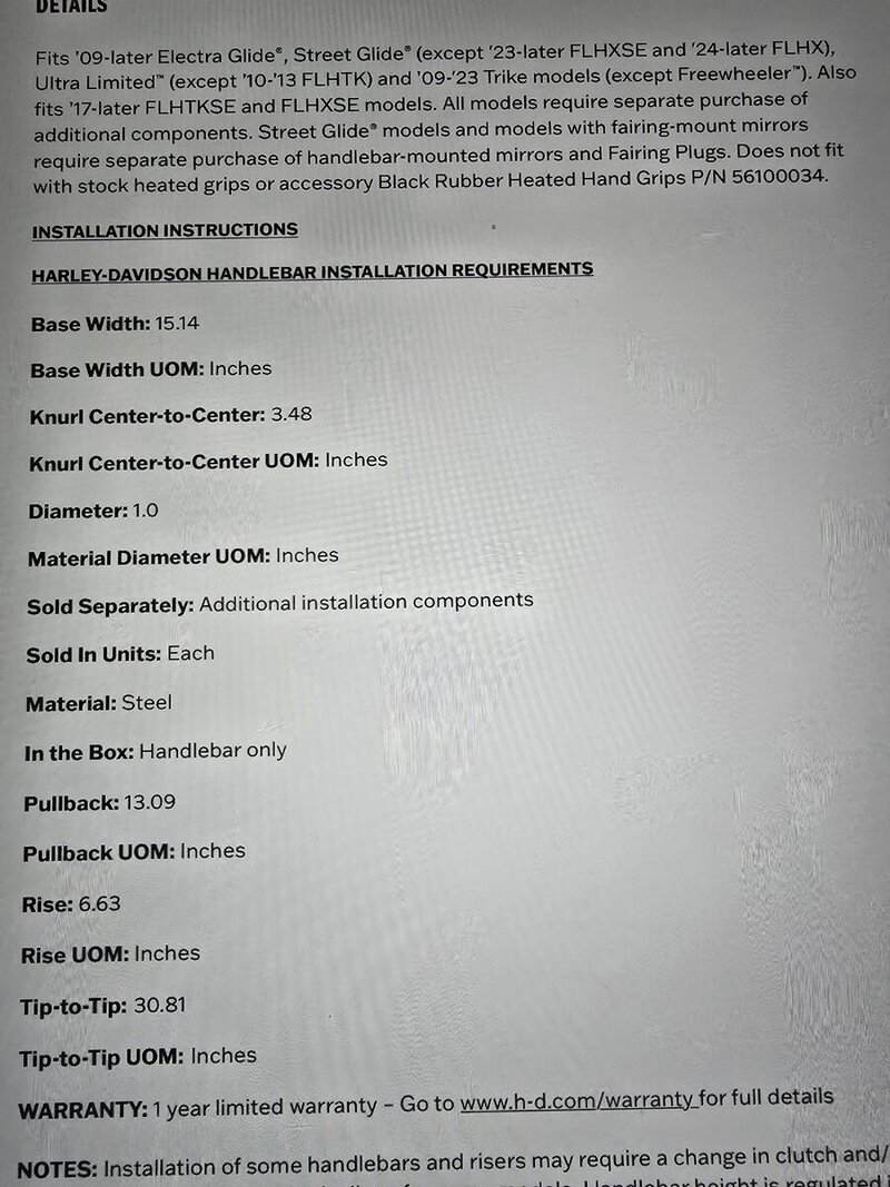

Looking for a set of handle bars, a bit more narrow and some small rise.
I find after two years of riding my 13 Triglide, making tight left turns I almost have to climb onto the tank.
That and the throttle is next impossible to work.
I was at my dealer today and he suggested this set of bars they've use on other trikes.
Do any of you have experience with these bars and could you give me your thoughts.
I'm 5'11".
Thanks for any advice.

I have factory bars now. I have not purchased this part from the dealer, I'm gathering info as to what I may do.

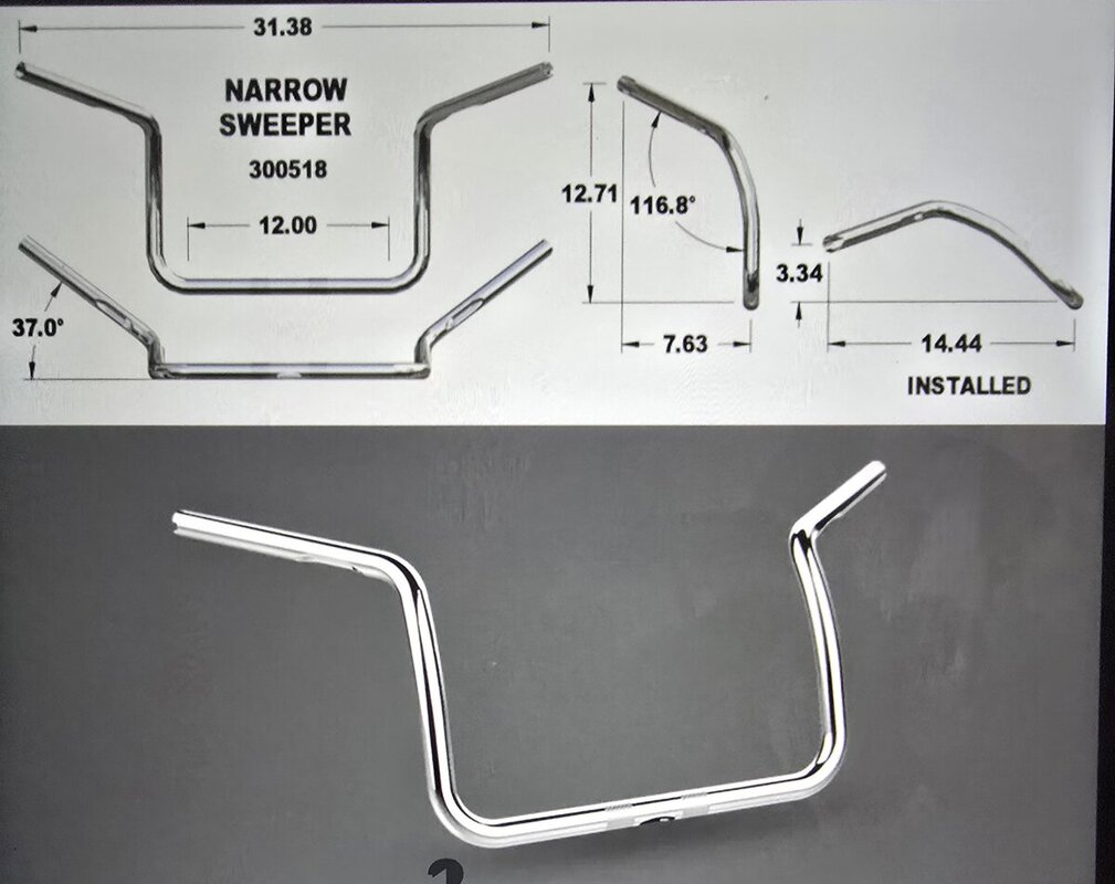

Here’s a size comparison of Harley bars vs KhromeWerks 2+2 Narrow bars. As others have stated, my vote would be for the 2+2.
Thanks, I surely will be looking into these.
From the replys these bars appear to be a favorite.
We have an INDY in town, I plan on seeing them also.
Those Kromeworks 2 + 2 narrow bars have a desirable design feature (for me a 5'10" guy) in that they curve back to you. This means one side of your body is not over extended in reach when doing a tight turn. I would have my bars pulled back as far as reasonably possible to help this as well. I think this is more of an issue on the trikes than on the 2 wheelers.

I took the advice from many of you on the Khromeworks 2 narrow bars.
Quite the difference, I really like these bars. So much better than factory bars. More comfortable and making turns are so much more better, I don't feel so stretched out.

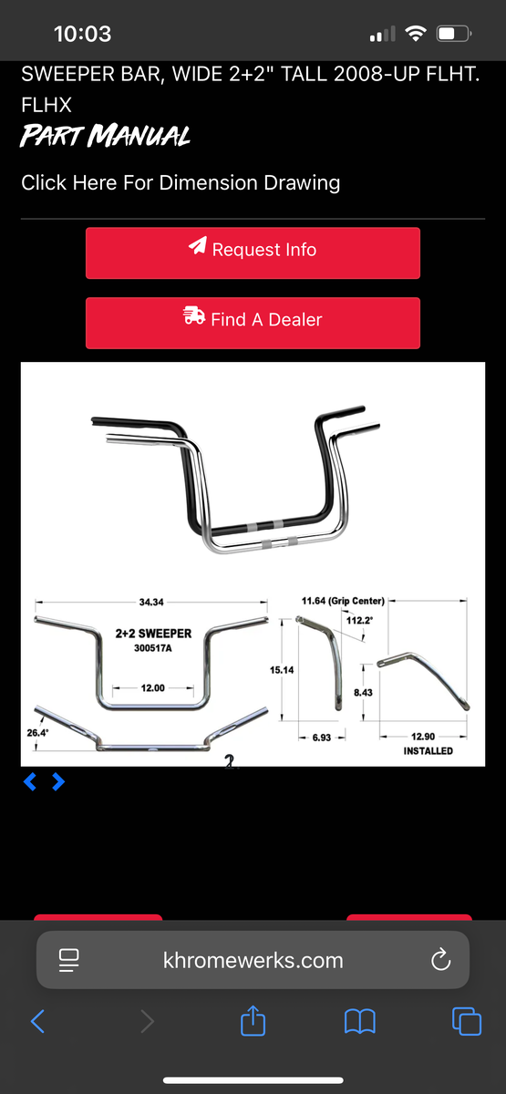

Please help me decide between the Wide and Narrow, 300517A and 519.
I have 2 bad shoulders and I think the wide would give me more leverage but they would make me reach a little more I think, but it's a small percentage of the time you make slow 90 degree turns.
I'm confused.

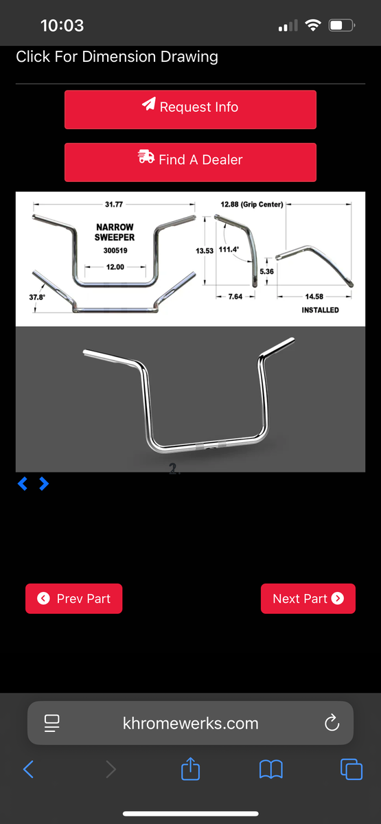

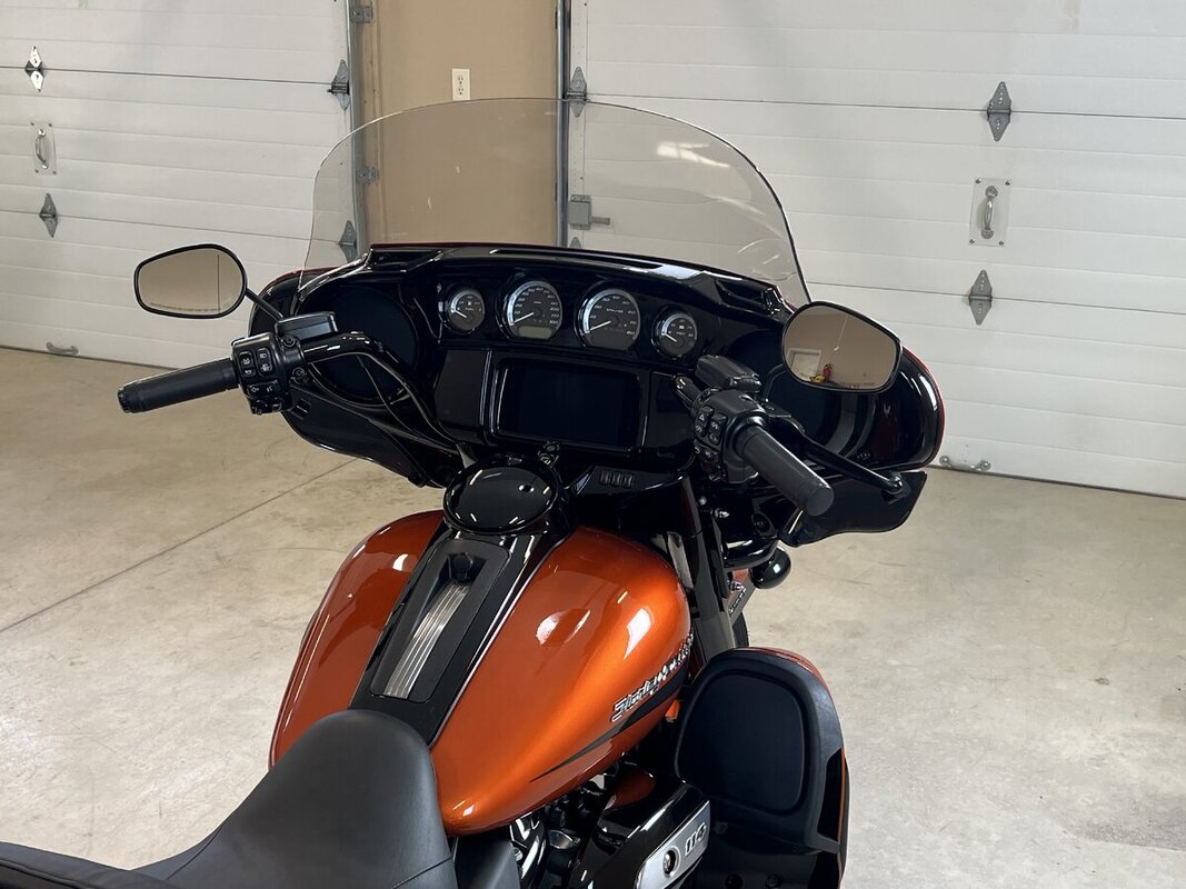

It’s a highly personal choice and only you can decide. I had both the wide and narrow version. They are essentially the same bar. The main difference is the angle of the grips. The Wide is more level and go more straight out. The Narrow are angled in and down a bit. I preferred the Narrow as I don’t have to turn my wrists as much and I can keep my elbows tucked in and down. It’s just a more relaxed and natural position for me, especially on long distance rides. The Wides are a little easier to turn though. Here’s a couple pics of the specs on the Narrow and Wide so you can see the difference in the grip angles. I’ve also posted a pic of my bike with the Narrows to give you an idea how they look turned in and down a bit.

I would recommend the Narrow Sweepers for the same reasons that Zammy and HDUSA1 mentioned.
