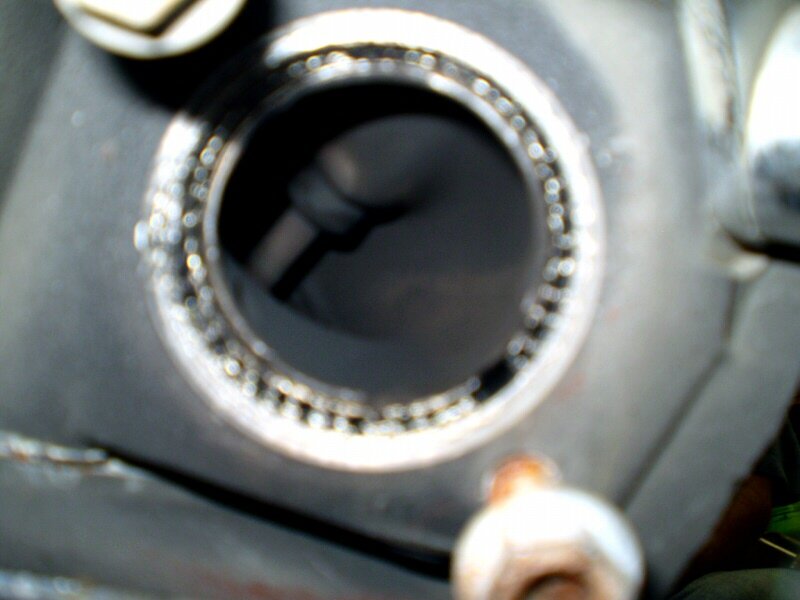

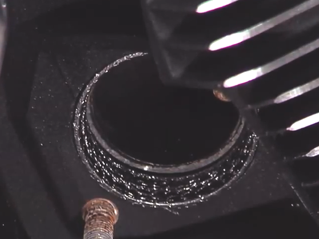

If proper torque procedures are followed with the stock gaskets there should be no problems with them restricting the port opening. Not the greatest picture but here is one with the stock gasket still in place, this is the front exhaust port on my dads 09 Trigide, nothing restricted the port.
Some exhaust manufacturers will recommend a specific gasket, most won't. I know Supertrapp recommends the stock gasket for use with their Supermeg exhaust I run on my 06 Ultra. I've read quite a few opinions on stock vs SE vs other after market gaskets, non have really come up with hard proof one way or the other. I think if a person has radically ported heads they may wish to try something other than stock if the ports are large. The biggest thing you have to watch is when you stray from the stock gasket you can have leaks, sometimes you can't hear them. If you get am exhaust ports leak on an O2 sensor equipped vehicle your going to give the sensors bogus gas mixtures to read.
