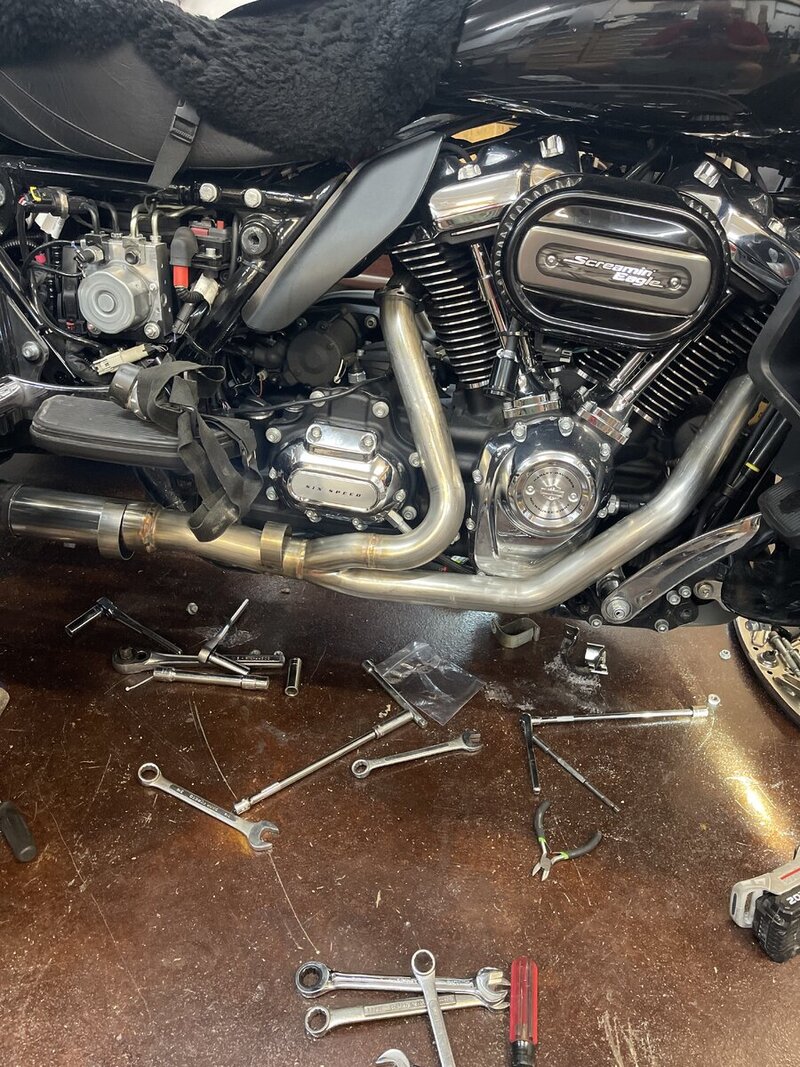

I ended up with a Fuelmoto stainless headpipe and a power vision 3. Kept my S&S grand National for now. They do ok . They are great for touring , medium bark when you get on them but subtle when cruising.IMG_4795.jpeg
