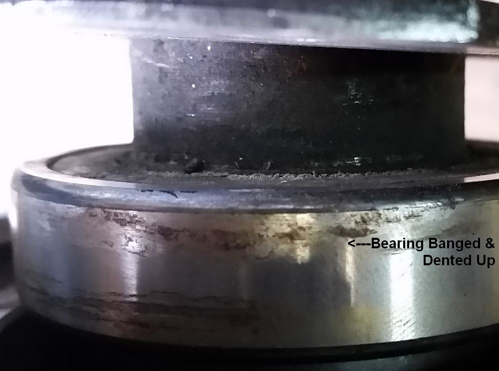

I believe it was around 44k miles when we discovered it. Don't know how long it had been going on.
Since then we have looked at several other Trikes.
1 at 5k miles had no signs of the plates deforming or the bearings knocking around in the housing.
Another at only 3k miles had deformed plates, banged up bearings, but very little wear on the splines.
Another at 52k miles, all aspects looked worse than mine did at 44k miles.
The last one I saw had 30k miles and looked about the same as mine.

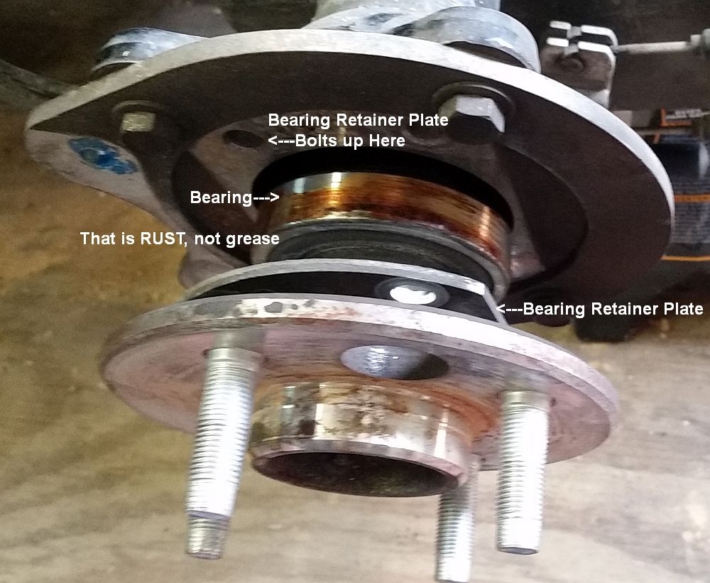

I was going thru the Trike, getting it ready for our big summer trip, and one of the things I did was grab hold of one the the rear tires and shake/push the bike back and forth sideways to see if all was tight. I felt a little slop. Thought it was the heim joints on the panhard rod.
So I replaced those, and adjusted the panhard rod per the FSM. Still had that little clicking when push/pulling the rear tire sideways. (Could not hear the clicking/movement, but I felt it).

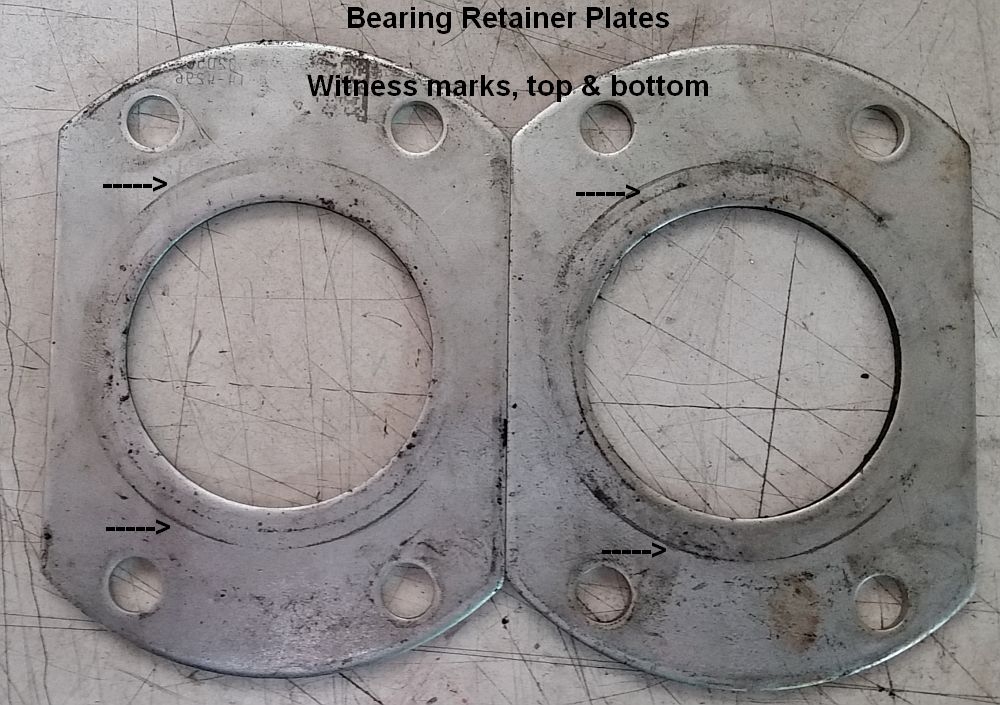

So I started taking stuff apart to see where it was coming from. You can imagine my surprise when I saw the chintzy factory retainer plates that were bowed out...and even more surprise when I saw the beat up bearings, axle housings and worn splines.

AXLE BEARING RETAINER PLATES For HD TRIKE MODELS
With the DK Axle Bearing Retainer Plates installed, the bearings are held firmly in place, resulting in the axles being held in true.

So, I think it is what Jack said, it is a really thin stamped piece of metal and it could start off loose (not completely flat), brand new.

The ever changing end play with the cheap axle retainer plates will beat the hell out of the axle housing and eventually ruin the splines IMO

Yes, it is recommended to replace them. They are relatively inexpensive, and the likelihood is high that they will sustain damage when being pressed off.
Kevin, I’m a little late to the thread, do you need to replace the bearings if they are low mileage? My concern is that pressing them off and on again will create issues with the wear pattern established. Thanks.
Always use a NEW bearing, Bad Ju Ju with pressing on and off, the bearings cannot take that loading. I have pressed many bearings in my lifetime, after trying to go cheap for 1 customer, Never again.
