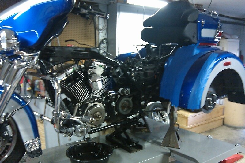

Once you've done it a couple times you will be able to do it by feel afterwards. I've changes fluids so many times I don't even have to look anymore, granted life is a whole lot better with a table lift these days.
