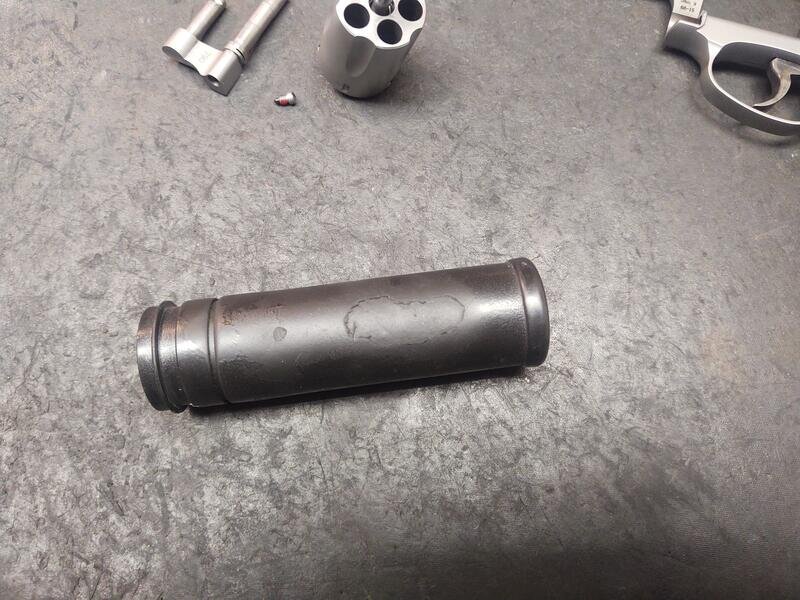

Noticed today that my throttle side factory grip on my 2021 Freewheeler was peeling apart. Thought maybe it was dirt or grime or something, but the more I fooled with it the more of the rubber came off. Not a good look. Ordered HD Kahuna grips. Any tips on installation I should be aware of?

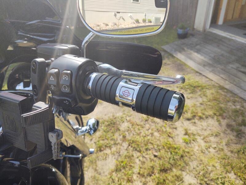

Got my hand grips on! The throttle side that I was worried about was easier than the clutch side. On the left grip they neglect to tell you that the function button on the housing has to be removed and there's no mention of how to do that. I learned it can be pried off with a small flat screwdriver, then the housing halves can come apart. Anyhow, after checking to make sure everything was working right I buttoned it back up and then realized that the right side (throttle) grip emblem is UPSIDE DOWN! I've already got an email into to HD about it.
Is the clutch side grip the same??
Looks good, the trigger button had to be removed? I did not have to on my 2 freewheelers
Couldn't get the housing off and couldn't figure out why. When I popped off the button the halves fell off.
HMMMM, glad it worked out for you, I bet the new grips are more comfortable and easier on the hands
You really dont have to worry about the switches, it is HD way of doing things from years gone by
I changed my 15 and 17 without any problems
