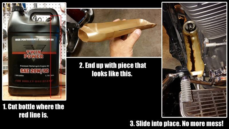

oil change
I go to the pet store and buy a bag of absorbing rags for dogs to pee on. I tuck one of these under the filter it soaks up the spilled oil and leaves no mess

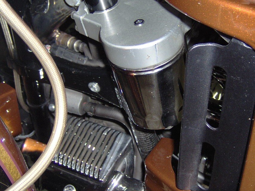

Who would be interested in having a way to relocate the oil filter away from the stock location, in a spot where there was nothing under it, and you could just put a drain pan under it and take it off and let the oil go into the drain pan?
This is something we are looking at doing...been thinking about it off and on for over a decade, and we're going to finally be trying it soon.

You might check out these folks for some ideas http://www.mooresensible.com/, I've seen a lot of positive comments. Every once in awhile I toy with the idea of installing one of these kits, then talk myself out of it, I don't mind the mess that much.
Yes, I've looked at the website a dozen times over the years, but never pulled the trigger either...for the same reason. But now that we're working on an oil cooler for the wetheads, it is making some sense to move the oil filter...killing 2 birds with one stone.
We may work with Moore, or we might come up with a different set-up. We'll know shortly.
