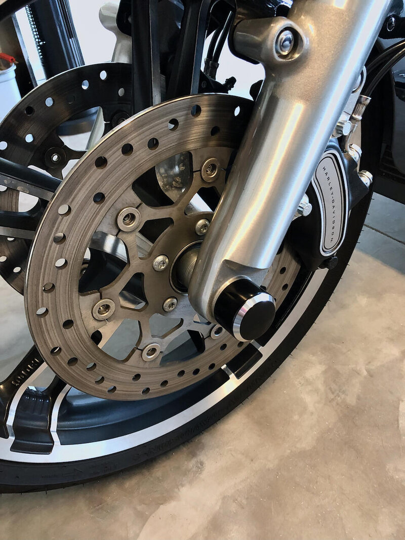

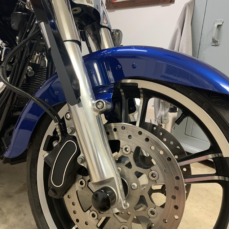

Looks like the calipers on my 2015 measure the same as your 2017. I don’t buy a lot of doodads, but the calipers sure could use a little “dressing up”.
I didn’t remove the factory “decals”. I just masked over the white line with the tape up to and under the decals. Then scuffed them with fine sand paper and wiped with alcohol. Then a coat of self etching primer followed by several light coats of black.
Those factory decals look to be a very light gauge aluminum applied with double sided tape. I’m pretty sure they would be destroyed by any attempt to remove them.
We’ll see how the job holds up.
That looks great dude ... how exactly did you paint them? I'm assuming they stayed on the bile. How did you keep that perfect outside trim line
When I painted just the ends of my Mufflers (Red)…I coated whatever I didn’t want red with a heavy coat of vaseline then when the paint dried I just washed the Vaseline off.. I learned that trick from an old school painter when touching up scratches and chips on cars..👍
Ok so disregard the “trim line” question and please allow me to ask what type of paint … flat, gloss, enamel, acrylic … and did you use a brush?
Thanks so much … really like them
I used Rust-oleum rattle cans, both the self etching primer and satin enamel. I probably would have used gloss for more contrast but I used what I had on my shelf. Consider high temp paint if you’re concerned, I wasn’t.
Thanks … how did you protect everything around the caliper from overspray? You didn’t remove the calipers did you?
First the tedious job of taping the perimeter of the decal. Then I used pieces of aluminum foil. Foil can be made to cover odd shapes pretty well. Then more tape, newspaper and some old towels (over the fender, forks, in wheel spokes, etc). Use your imagination, then double check your work. Good luck.

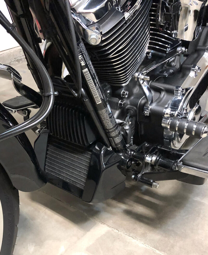

Hey RD ... Did you see the pic of my Vivid Black oil cooler cover. Sent it to the guys at The Factory Match in SD so they could do all that stuff. Came out super. Looks like it was always that color :) can't send out the inserts, couldn't do the right stuff myself. Great work very reasonable
View attachment 113270 View attachment 113271
Looks like they did a professional job that will last a long time. Pop off your calipers & send them out .
