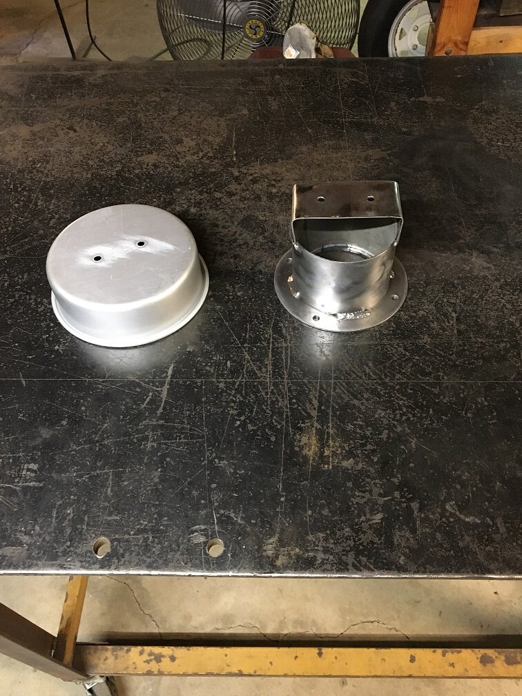

I put this together. It's a pan and a piece of exhaust pipe and a few other pieces.
It's supposed to look like an air intake. I don't think I'll put it on. It's sort of practical in that it lets more air into the engine but it adds another thing that could vibrate and break. I also thought that area would be a good spot to roll up and tie a canvas tarp to use to cover the trike when we go camping.

My dad told me to always keep a tarp with my bike. It was so if I ever got caught in a rain down pour, or you have to sleep where you are that night. Used it a few times for those heavy rains, but always made it home. Well if things do run a bit warm you do have an idea to get a bit more air flow.
