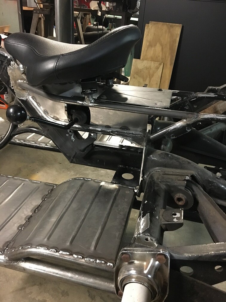

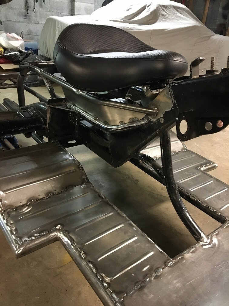

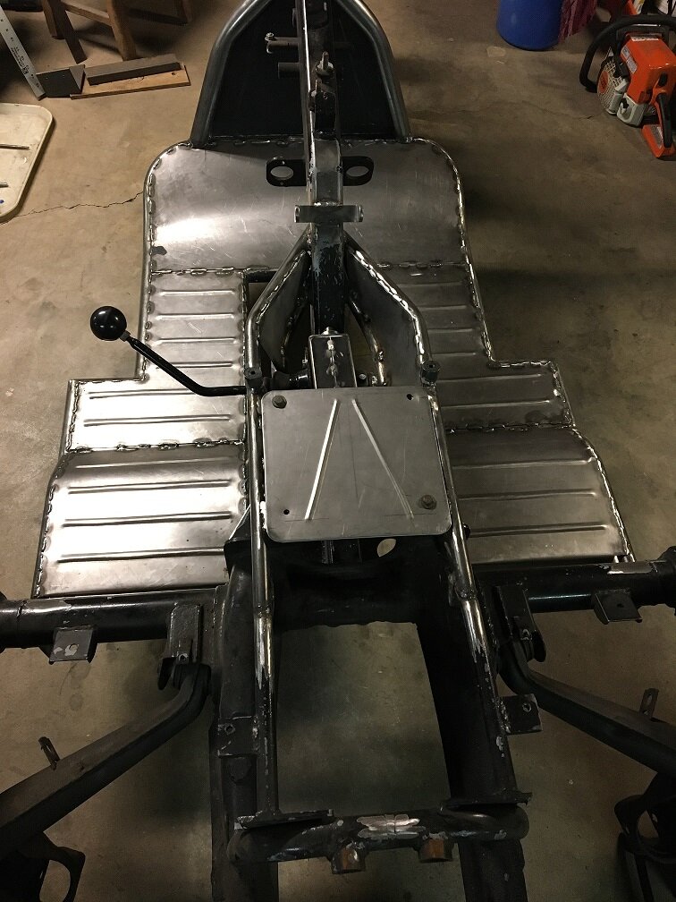

These were the fill pieces I had to put on the frame. They cover the area under the seat.
The side pieces are welded on and the top one is bolted on.

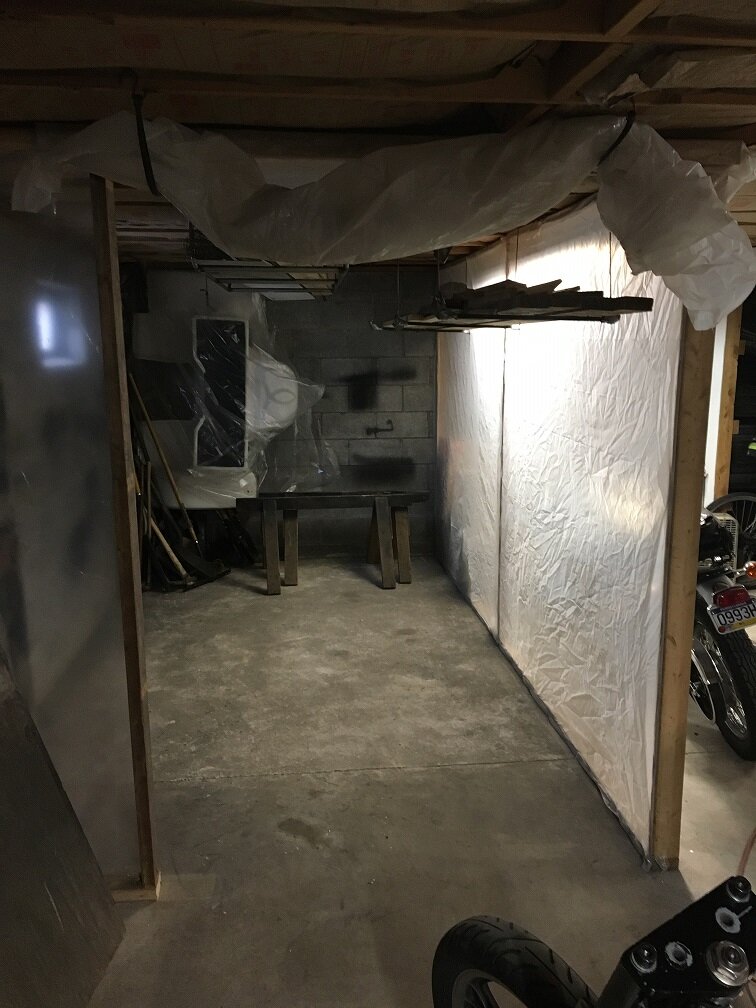

I spent today moving things around to get to the corner I had my paint room in. I'm getting close to cleaning up and painting. That will be kind of boring and time consuming but it has to be done.
I haven't done much to the trike. I did get all the holes drilled to mount the fenders. I've been working on my paint room.
It's pretty much ready to use. I have a little more to do to mount a fan in the window to keep the fumes out of the house. When I built my street rod it worked really well for painting and fiber glassing. It's a little dark in there even with a light so I might paint the walls white to brighten things up.
I need a bigger basement for all the stuff but I know if it was bigger I would have more stuff.

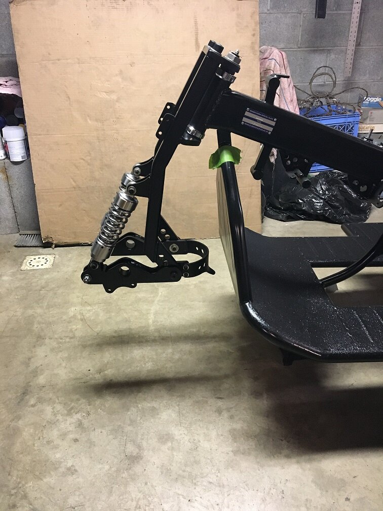

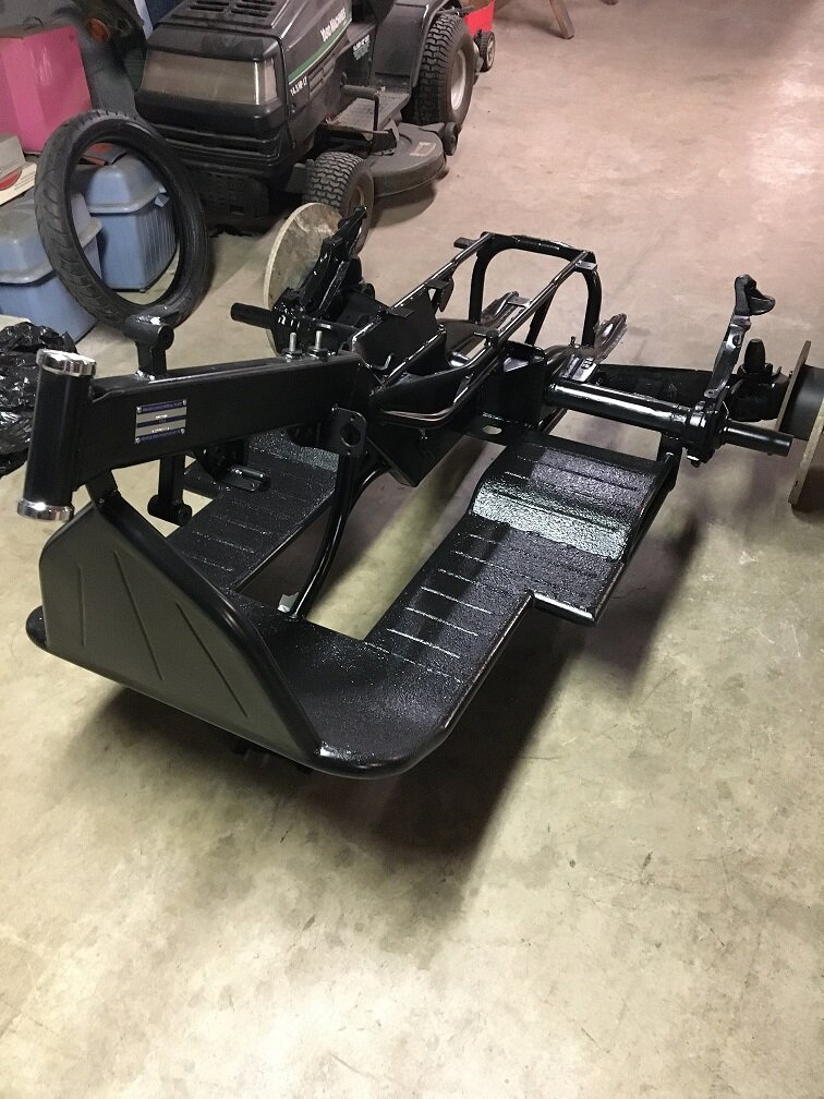

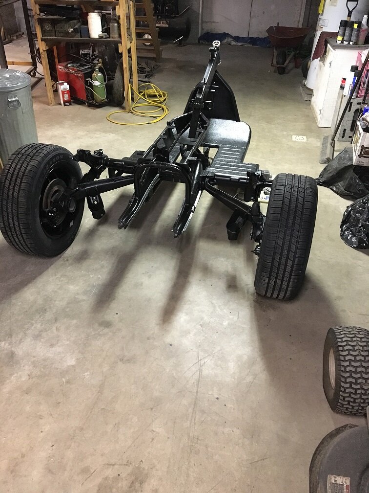

The main frame was cured enough to take out of my paint room.
I got the floor boards covered with bed liner. You can also see I started reassembly. I put the first piece back on, the vin. tag up by the neck. I have the front end all painted and drying. The rear calipers got cleaned up and a fresh coat of paint.

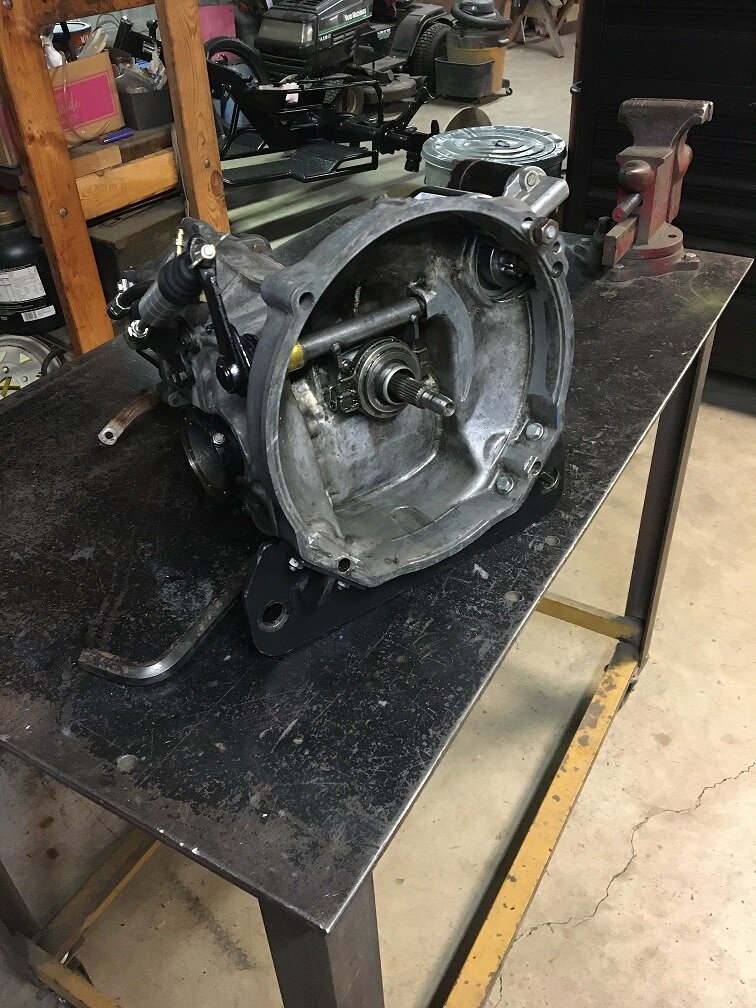

You can see the old front tire that I took off. I have to get a new one ordered. I have gaskets coming for the engine to set the valves and change the oil. I also have a seal coming for the input shaft of the trans. I think it was leaking a little. It's the original from 1973 so no shame for it.
Looking at the transmission picture I remembered that I had done away with the rubber mounts and made it a solid mount when I put it together 12+ years ago. I did it because it was such a short distance from the shifter to the trans. that I thought the torque twisting would knock it out of gear or mess up the shifting some other way. The VW boxer engine is balanced really well so vibration isn't a problem.
On the output shaft where the CV joint bolts, above the allen wrench, you can see a small magnet that is used for the sensor for my speedometer. It's an Acewell and works great. You can calibrate it so it is very accurate.

I put the front end together as far as I can without a tire.
I brushed the chrome on the shocks with a Scotch Brite to take the shine off.

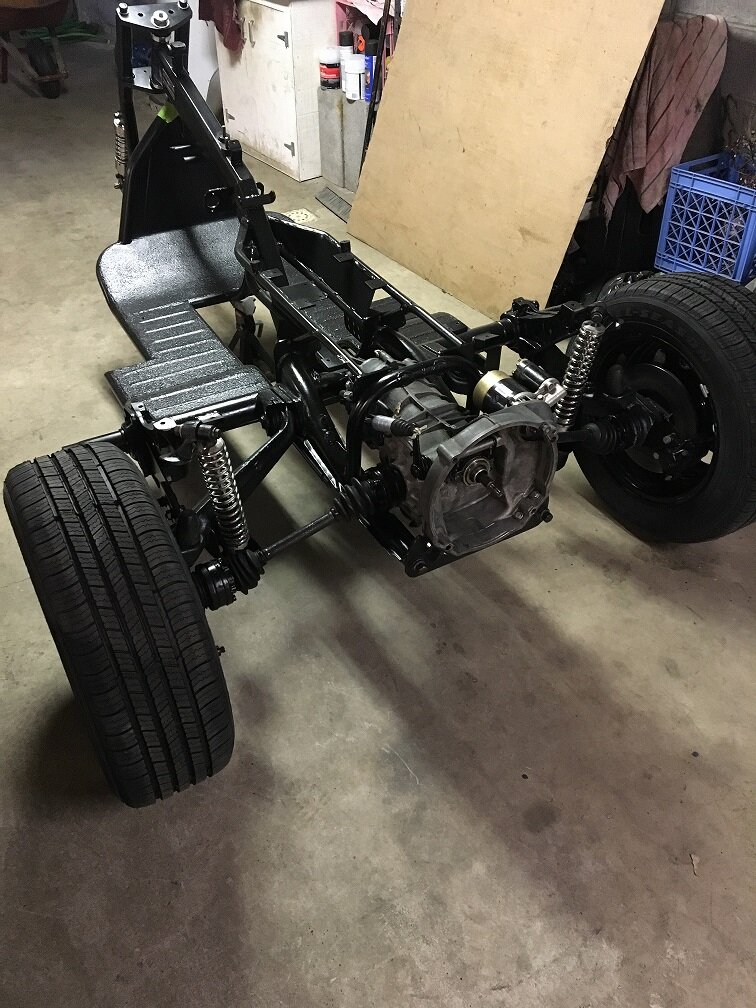

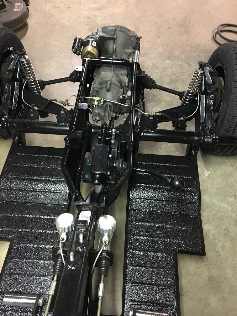

I mounted the shocks, transmission, and axles in the rear.
I can now start to put the plumbing for the clutch and brakes on. You have to think a couple steps ahead so the stuff you need is painted and dry when you need it.

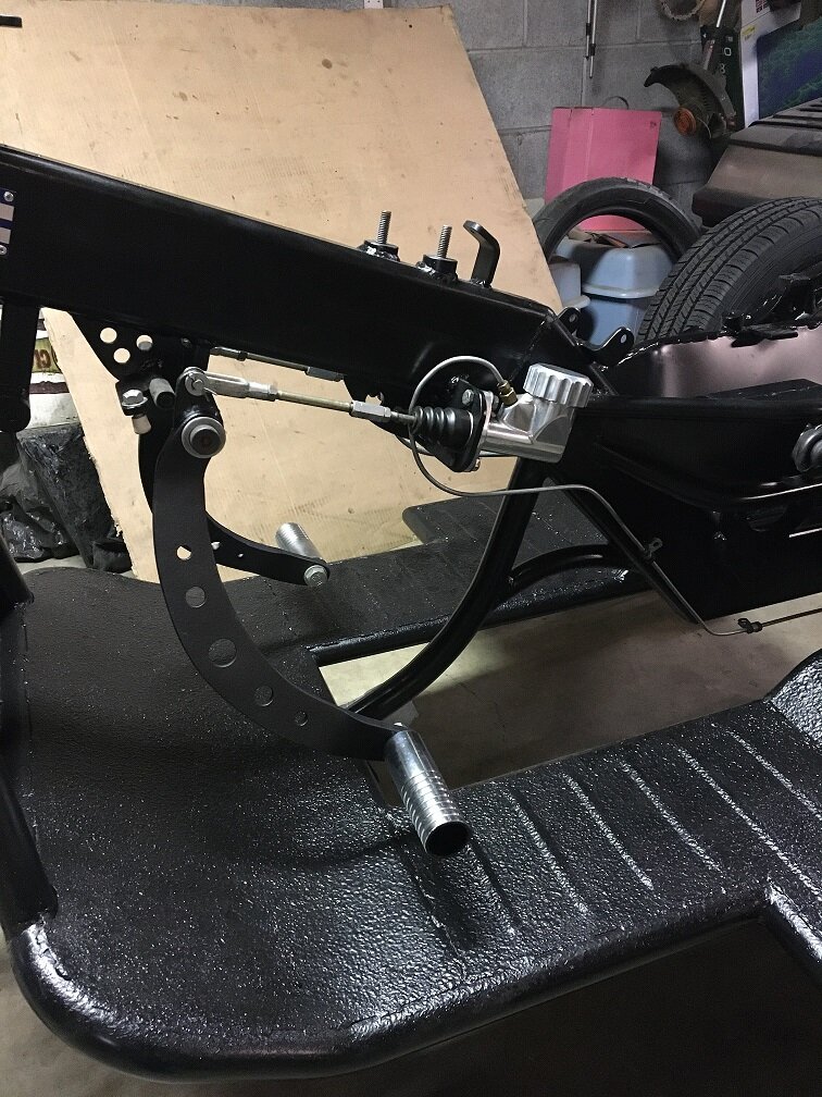

Brakes and clutch all plumbed and bled.
I got the shifter assembled and put on and adjusted too.
This is my clutch and brake setup. Dune buggy master cylinders, about 8 to 1 ratio on the arm, and the pedals came from Walmart. They were the pegs the kids put on their BMX bikes on the axles to do stunts with.

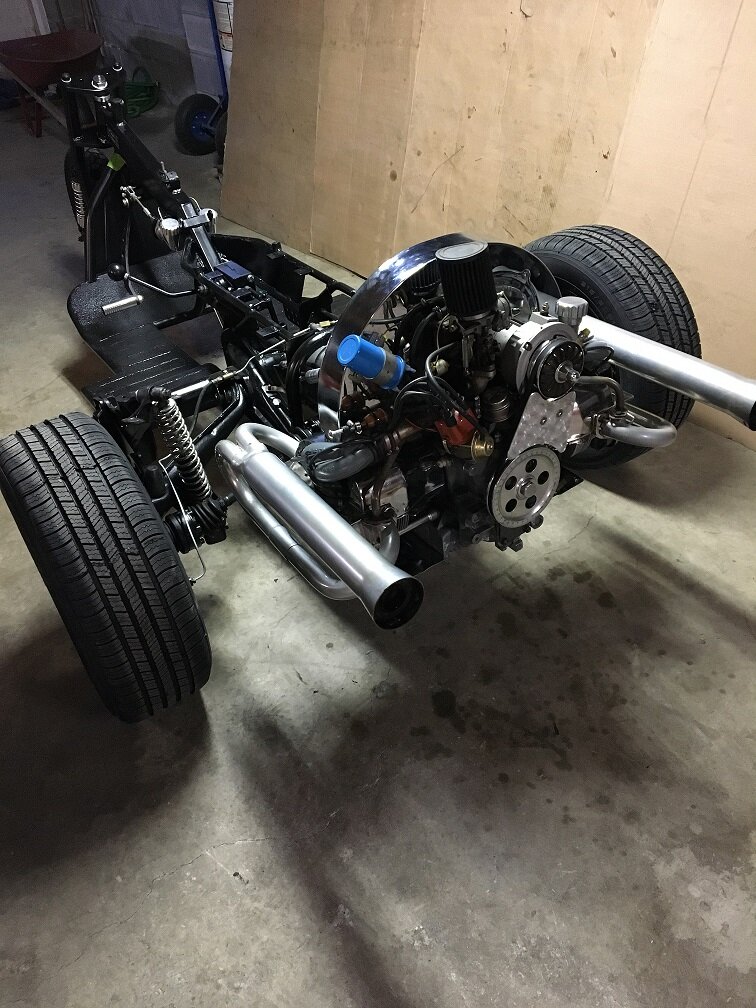

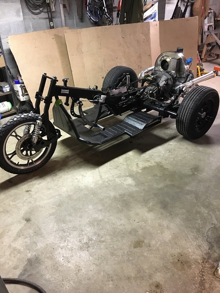

She's a roller.
I got the front tire mounted and on. It's a Continental TKC70. I also cleaned the engine some and put it on. Now that it's hanging on the back I will change the oil and set the valves and a few other things.
I did a little painting on some front end stuff so it can cure while I work on the engine. I'll soon have to get my paint for the body ,tanks ,and fenders.
