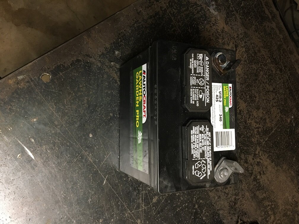

I have a stock 1600cc engine and I don't run it in the winter so I don't have to deal with cold weather starting. This garden tractor battery is plenty to get me going.

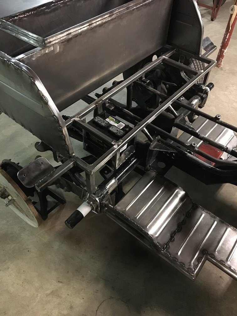

I got the battery box done and welded in.
The rear seat will cover it. I'm going to put a battery disconnect switch somewhere I can get to easily in case things go wrong. If the wires started to fry it would take too long to get the seat off.

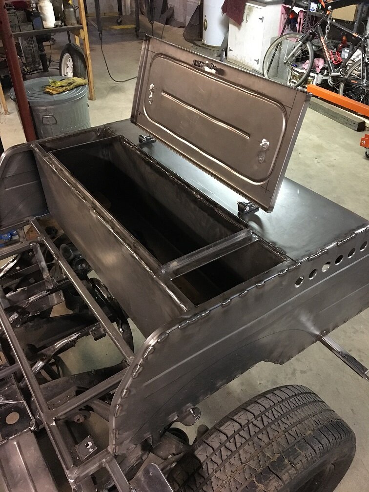

Today was a hinge day. I had the hinges off the old trike for the storage compartment but they had to be modified some.
I had made these hinges before but the angle was a little off so cut and weld.
Here they are all bolted up. They lift the cover up then back. Hinge geometry can get a bit tricky to get it to do what you want. That's a garage door handle I used for a latch. They work pretty good and you can lock them.
All opened up. I have to fill in the spaces beside the door yet. The compartment is the full width of the body.

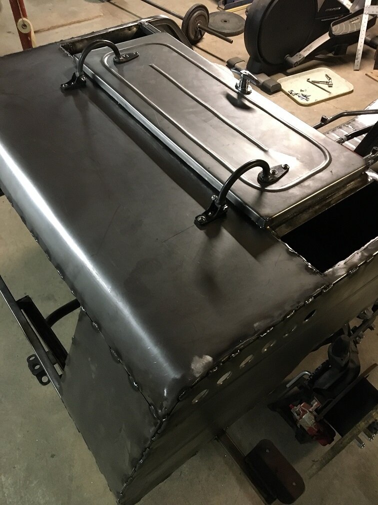

I'm going to build hinges for the engine hood lid. They will be about the same as the storage lid ones.

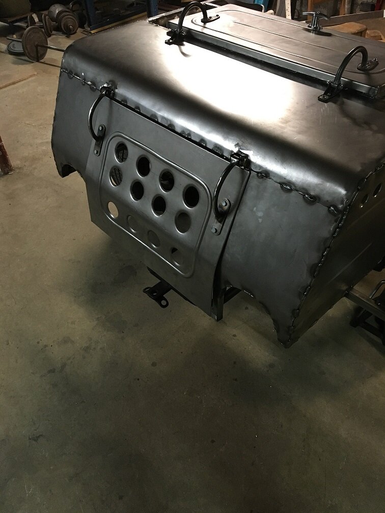

I did some studying on the engine lid hinge situation. I was trying to come up with a hidden set up but I guess my brain isn't big enough to figure out anything that I liked. I took the easy way out and made some hinges like the storage compartment ones.
They work fine and I could use them for a tie down point if I wanted to tie anything on the back. I need some latches to hold the lid down. I was thinking of the spring loaded ones like the Jeeps used to have to hold their hood down.

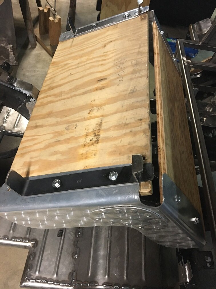

This is how I'm mounting the passenger seat.
The hooks on the back will hook on the square tube at the rear and I'll put bolts through the 90* tabs on the front so two bolts and the seat comes off to get to the electrics.

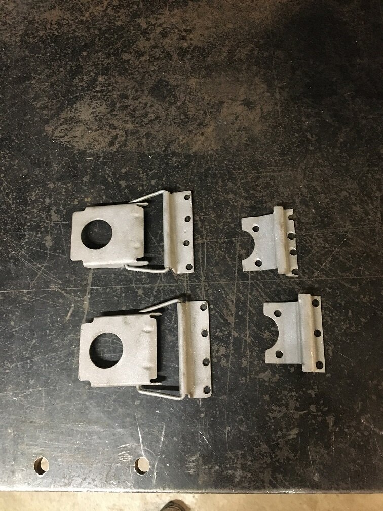

I took Kiwi Mark's idea and attacked a couple of ammo boxes.
These are the latches all cleaned up. The older box I had was really hard to drill the spot welds out. They must of had better welders back in the day. I had to bend the brackets on the main latches to mount the way I'm doing it. You have to get the parts the right distance from each other so they snap over center when you latch them. I had one box and my brother gave me another. You can't beat free latches.

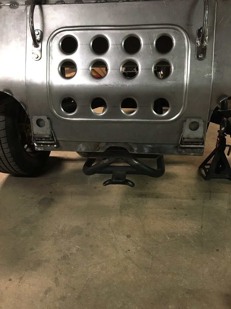

Success. I got the latches all welded on.
And unlatched.
I had to put them on this way because upside down the other way would have had them hanging below the frame. A little tweeking with a medium size hammer had them snapping over center. I like the look. It will be interesting to see how many people recognize them and where they came from.

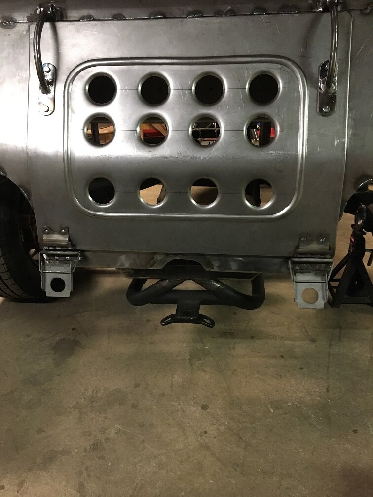

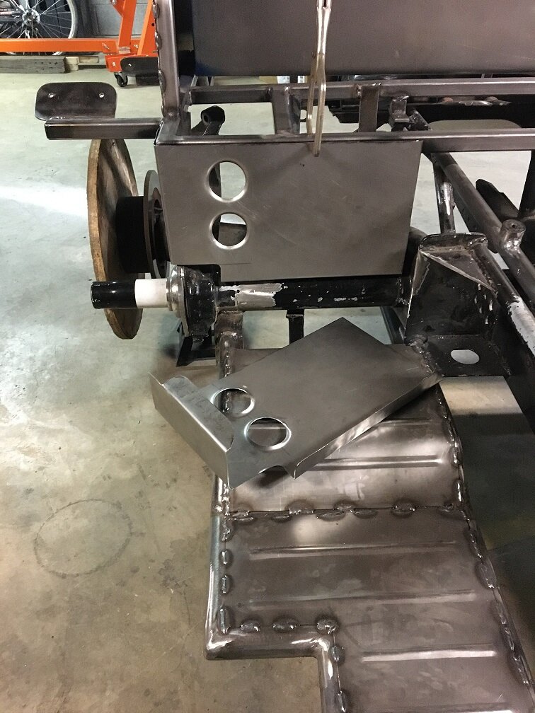

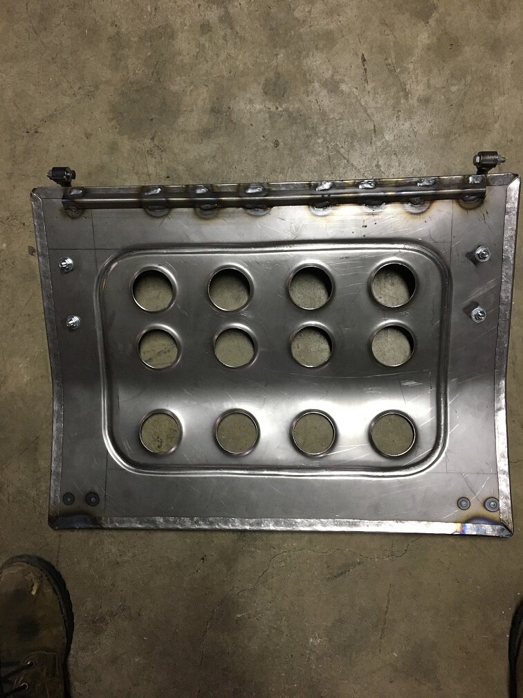

Today I worked on the body fill pieces on the front of each side.
They are a little complicated. I put the bends in them for strength. There will be a brace behind them. The holes are to let more air back to the engine. The right one hides the battery. I think the big empty space on the left one will be a good spot for my battery disconnect switch. It will be under the front edge of the seat. A power outlet would be nice on that side too so we can charge phones and stuff.

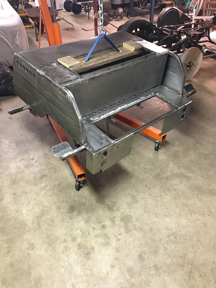

Yesterday and today was mostly welding. Not too exciting. I welded today until I ran out of gas for my mig. I cleaned things up and went for more.
You put all that weld on then grind half of it back off to smooth things up. The joints will get a light coat of body filler. I have all the panels on the body but there is still welding to do on the rear. There is still a few fill pieces on the frame to do.
