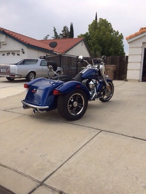

Just bought my most amazing freewheeler a few days ago. LOVE IT ! I'm new to riding..about 6 months, and previously rode a 2006 Honda 750 motortrike. Now, on my new beast..I'm having to learn and get settled in. I noticed after riding 39 or so miles the HEAT from the right side of the bike is really. .HOT. Almost so much so that it is uncomfortable. I ride with jeans and proper riding boots. After a relatively short ride yesterday, I took pants off (at home..lol) and noticed the inside right calf of my leg was all red and splotchy....like when you get burned. It did fade over time and today doesn't bug me at all. Went to the HD shop and told them and they ordered heat deflectors.....waiting. seems like they are going to be placed up higher than the lower leg area though. So....wondering if any other freewheeler owners have noticed this exceptional heat on the right hand side and if so...what did you do about it? Thank you, sincerely, in advance for your time and any suggestions and feedback.

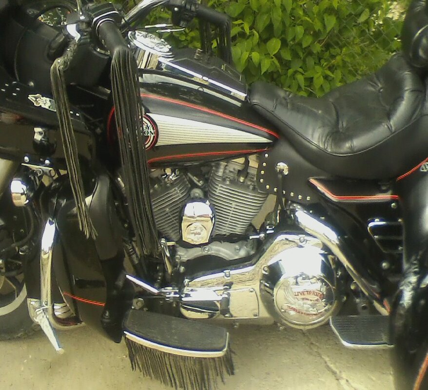

Okay ... I must be dense ... I still don't know where they go. Where are they highlighted.
You can see the extensions in these pic's. Look between the floorboards and where they mount to the frame, there you will see a 1" extensions. The kit comes with 1" spacers and longer mounting bolts. (It takes longer to poor a glass of tea and get the tools out than it does to install them)

Hopefully you will be able to see them this time. 1" Floorboard ext, the 2" V twin manufacturing ext heal shifter arm and the 3 1/2" LA Choppers front ext shift peg.
Yes, the floorboard ext are pretty easy to install.
