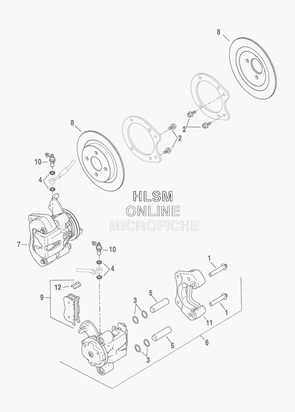

I will be putting on new rear brake pads and was wondering if there is any thing special or problems I should be looking for when I do them. First time doing them. Thanks
Just follow your maintenance manual and you'll be fine.
You will have to slacken your parking brake before pushing the pistons in. Flush the rear brakes good. Before pushing the pistons in remove some of the fluid from the master cylinder. The fluid level will rise as the pistons go in. EBC are very good pads and come with new hardware. Here is your rear brakes exploded view. Clean and lube #1 pins
