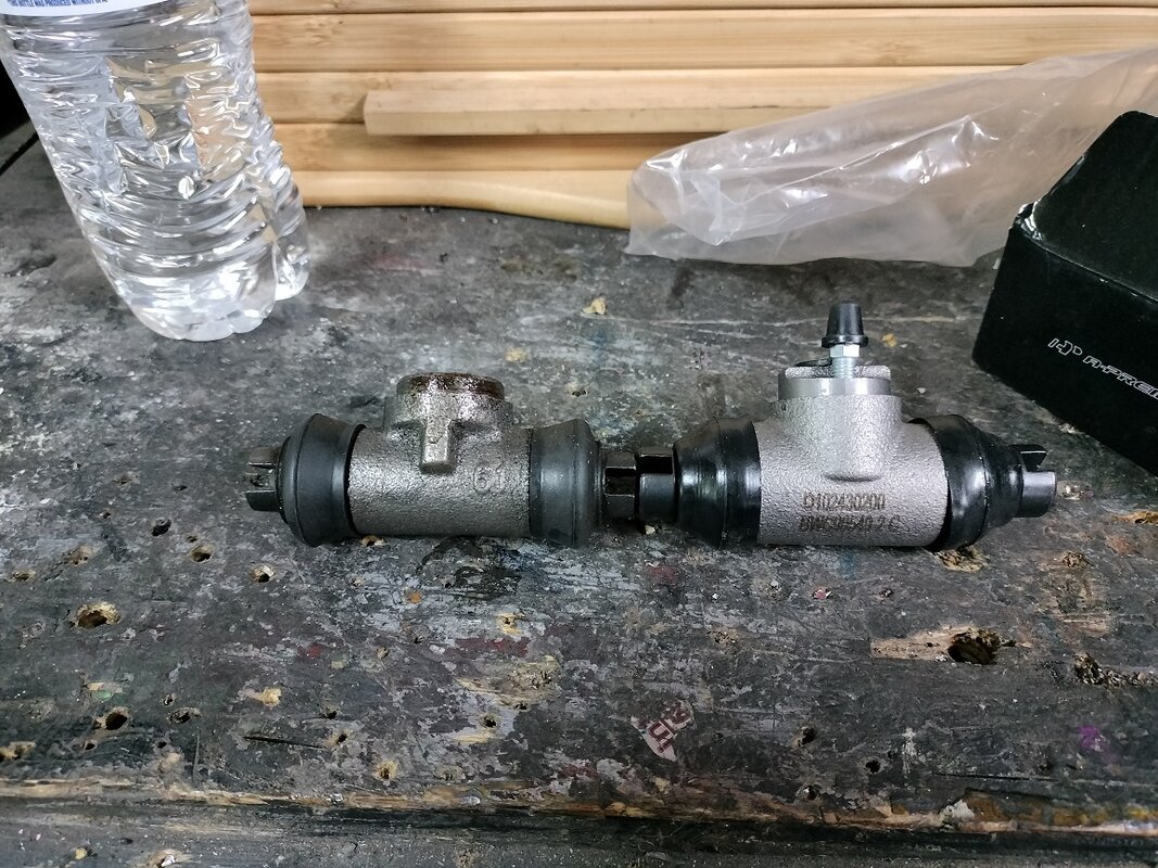

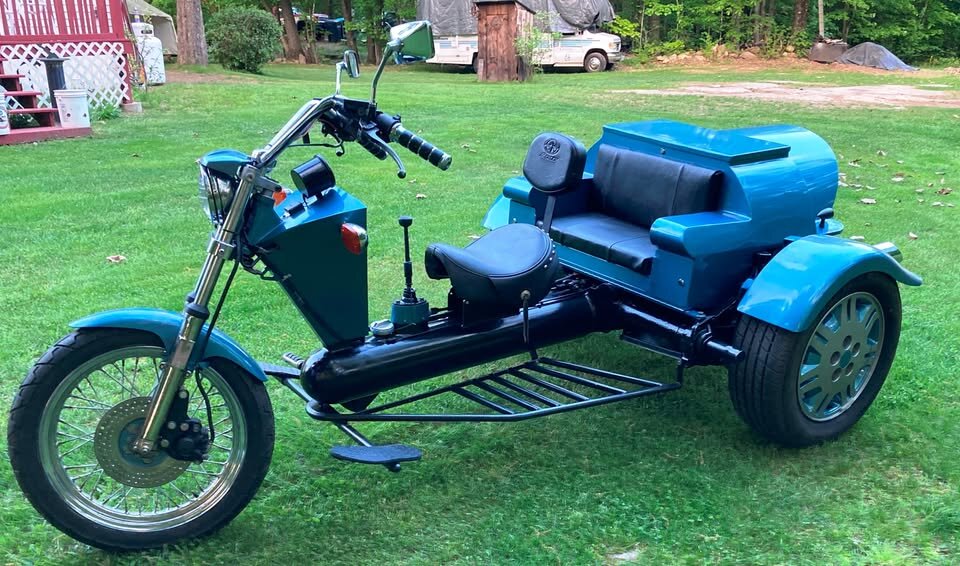

I just bought this VW trike. Haven't taken it out, rear brakes seem to be worn or not working properly. Took 30 feet to stop from 10 miles per hour. Going to the shop on Friday for a rear brake job.
I just rebuilt my rear brakes. They are drums also. Once done the brake were hard to push. I replace the brake cylinders again but this time I used brake cylinders that were meant for the front. The brake cylinders have to be "matched" to the master cylinder.
See the different sizes of the front and the rear. The Front cylinders are bigger.
My brakes work great now.
