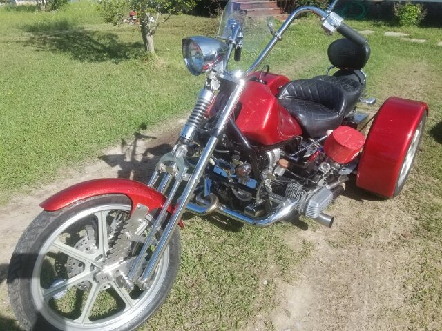

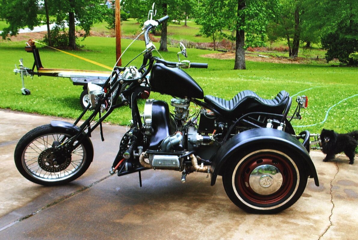

Above is mine with the extension....albeit heavier duty built as I am pushing considerably more hp than normal.

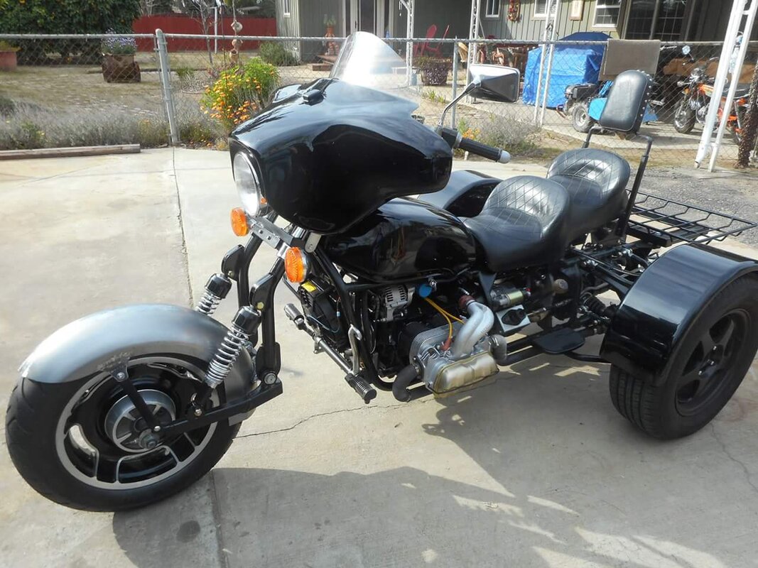

Here is an internet friends no extension with full type 3 fan and tins.

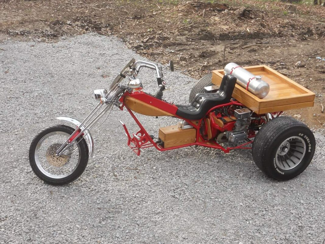

Here is another internet friends with the extension. He has gotten it to the point he can pull a trailer with it.

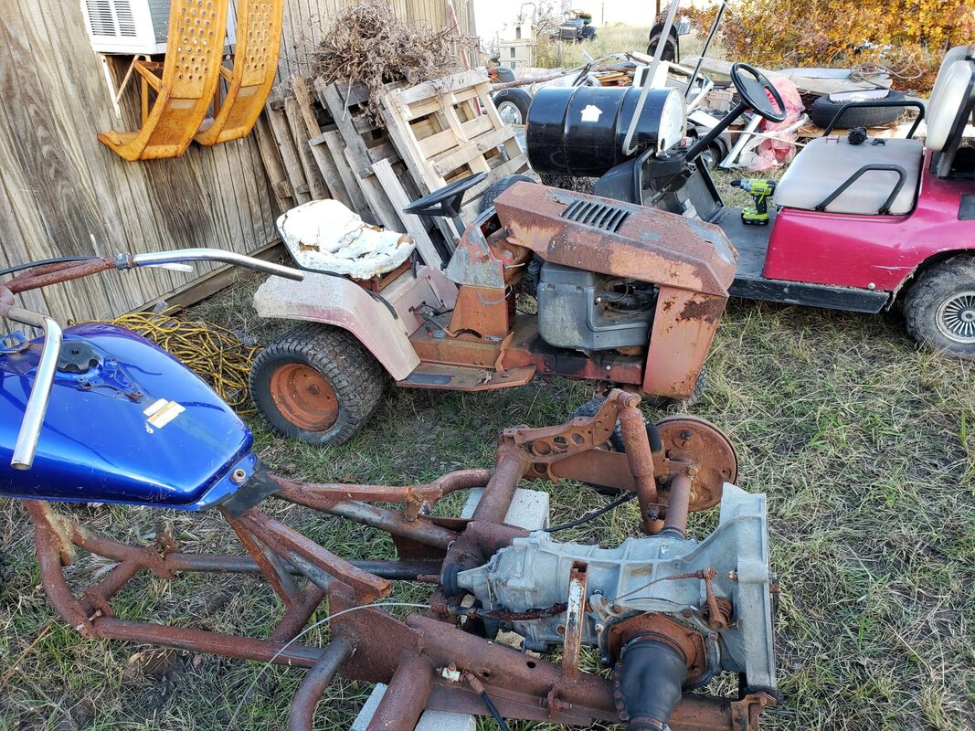

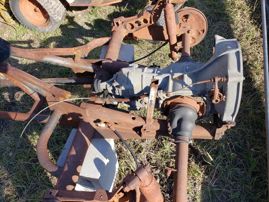

So I didn't make it out there to play this afternoon …. But in reading this ….
I Have a VW trans-axle …..
If I and turn the trans axle over around so input shaft is facing inward that gives Me a automatic to sell …. and all I have to do is get a adapter plate to mount the trans-axle put the corvair motor on it ….. I will look at mounting options …. the Corvair motor has a back motor mount & springs if I can just get them hooked up to a Cycle frame ….
