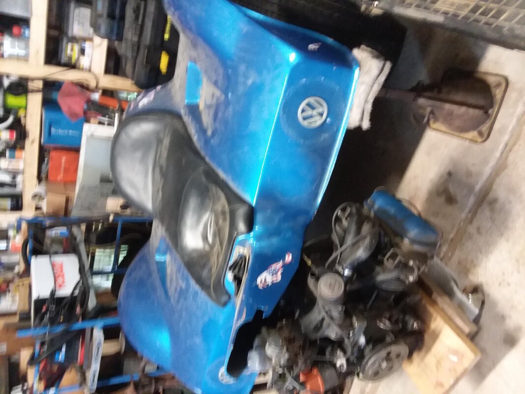

This is a VW Trike a friend bought for $500. It wasn't running and NOTHING worked. I tore it down and once I go through and rebuild the engine and transaxle will start rebuilding it. The picture shows the body flipped around as I want to convert it to a mid engine. (The red rag in the bag sits on top of the neck which will be removed.) Now for my first question, has anyone made an extension or spacer between the front of the transaxle and rear of the engine? I need to move the engine forward 15" for my idea. Fabricating a spacer from many pieces of tubing isn't a problem, but the "driveshaft" is.
Anyone done or know how this is accomplished? Swiss mid engine trikes appear to use a second transaxle case for the spacer, but no details on extending the tranny shaft to the flywheel. I plan to hit the local machine shops about turning one with external and internal splines.
And to those that say I'll end up with one forward and four revers gears, it has the transaxle with plates on both sides so I can flip the pinion gear over. Not sure why the image rotated 90*...

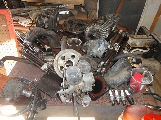

Engine Tear Down
Tore into the engine today. Bringing the block to a machinist late next week since that dang flywheel nut kicked my butt up one side and down the other. With luck they will have a BFIW ( Big Frigging Impact Wrench) and spin it off for me. Did measure the bore and stroke coming up with 1597cc. I do like the heads comming with their build in carrying handles too!

Hhmmmmm, not sure who's thread this is now, but I'll keep posting on it anyway. I have the engine torn down to the block and to me, everything looks great. Smooth cylinder walls are a relief but don't know what the bearing look like yet. Still need to break the flywheel nut loose, but trying to shake this flu and stuck home. I'll be replacing the head studs due to one being broken short and one being hit with a grinder. One spark plug is larger in diameter than the other three. I bet it had a helicoil in it which failed and they screwed a spark plug that fit the threads. I think I'll tap them all out to accept the larger plug. The owner saw the engine torn down and I think he is concerned!!

maybe the heli-coil unscrewed with the plug? lol.....here's to your friend, hoping you don't lose interest in the project! Some folks get nervous when the see their stuff scattered all over the floor! Good luck with the project, and the flu! larry
That odd spark plug......somebody had problems.
Avery good reason to inspect those head for cracks. Especially from the spark plug hole.
Cylinder/piston kits are cheap enough that they are not a worry.
Heads and/or head machining can be pricey.
Internal case machine work such as line boring can be a bit expensive if you do not have a vw shop in town and have to ship the case out.
I'm with Larry on the spark plug. Doesn't look as new as the other 3. Check and see if it has a different p/n on the porcelain insulator. If the same #, inspect the threads closely and you will see the helicoil threads under the gunk. You can probably install a new helicoil with some Loctite and be good.
I'm with Rex on the check the heads for cracks too. Typical cracks are from valve seat to spark plug hole or between valve seats. They can be very obvious or teeny-tiny hairlines so inspect carefully. If they're cracked, scrap the heads. Check out "Need VW type3 DP 1600 heads" thread for pix.

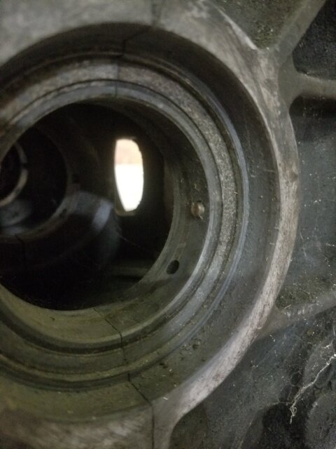

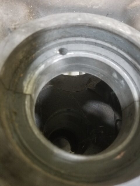

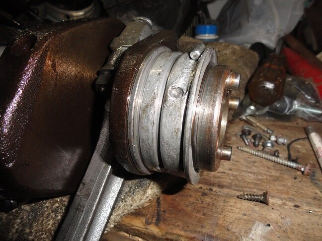

Finally got the Gland nut off today. Snapped the drive off of my 3/8" ratchet, but got it. Split the engine case in two and a quick inspection found only one problem. The rear crankshaft bearing looks like it tried to spin. Once the block is cleaned up, I'll be examining it and the heads as best I can. That one "oversize" spark plug did not have a helicoil on it, so it makes me believe the prior owner had a helicoil in it, probably came out, and just stuck this spark plug in it to sell the bike.

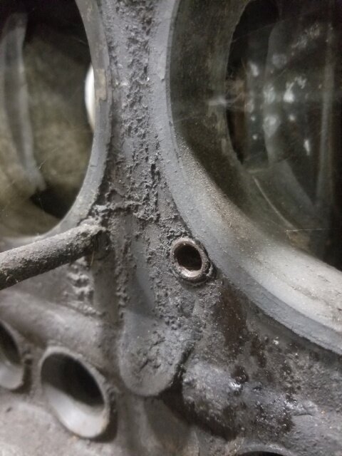

The case has a small raised portion where the pin tried to bend over. Other than that (from what I can see) it looks fine.
I removed the jug bolts and noticed each one has a helicoil in the block. One did come out with the bolt, but other than sitting just above the block, the others look good.
No grooves or damage on the crankshaft and the rod side clearance came up at .012" which is well within the books spec's.

Check that bore for the thrust main carefully.
I have not ever seen one with a bearing damaged that bad that the case was not loose on.
A good used case might be stained on the bearing saddle but you can not feel any step to it. No step feel? Then it is time to torque the case and get out the micrometer.
If you can see or feel a step then it is most definitely bad and needs a line bore.
Case head stud inserts are a good thing.

The bearings fit nice and tight except in the center. That one slides in and out of place quite easily. Waiting for my new dial caliper to arrive for proper measurment.
Does anyone have a shop or business to recommend sending my engine case to for line boring? Can't find anyone withing 200 miles of my house. Or, directing me to a line boring set/kit that a DIYer can do it himself?
