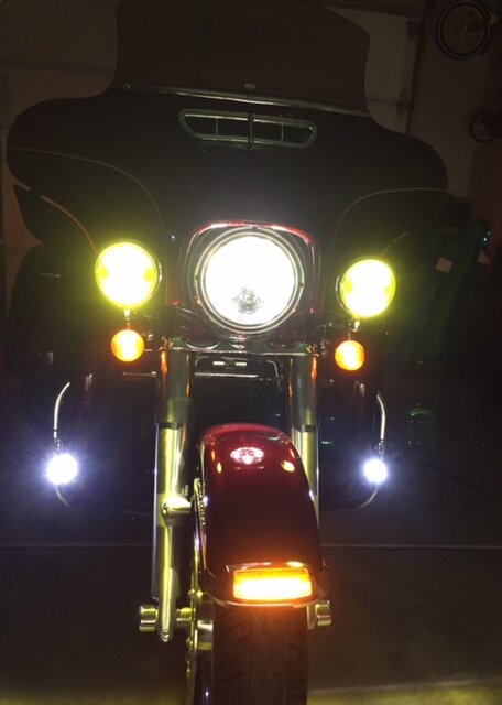

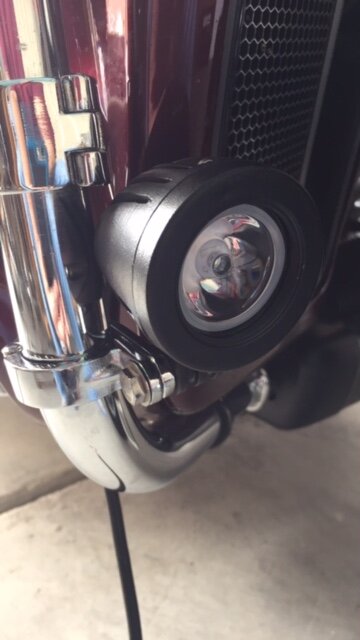

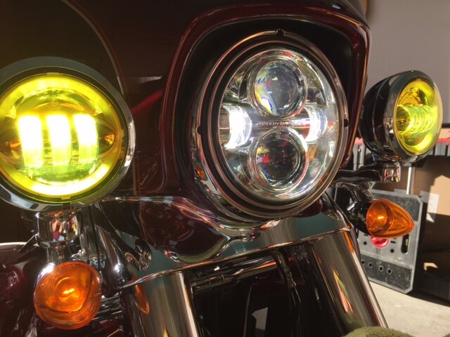

The lights on my trike were a mess. I checked the alignment using the method in the maintenance book and they were sure off. I got everything in alignment then I added the running lights and the tint to the passing lights. You can see them in the post 1268. I sure am happy now.

Gorilla was correct with the distance and height. That 25 ft is an important measurement, HD says 25 ft to the front axle. The height is also adjusted on the low beam led light.
I am sure having 2 up could make a difference. I made sure the air pressure was accurate and had the wife on the trike in the riders seat, not the passenger seat as the trike supplement states.
I refused to buy a 100.00 socket to adjust the passing lights. I made my own special socket. A six point deep thin wall socket and a hand grinder and a few minutes and I have a socket that I will probably use 2 times in my lifetime. Jim
Desertclassic, That is a lot of lights in the front! How is your night driving, is it bright? I have a set of driving lights in front, low to the road and they give me plenty of "frontal" lights when traveling at night.
Great job on your front lights.
Rosy
Rosy
I have only taken one ride at night since the install and alignment, very good. It is so bright here in the desert that I wanted to make sure that I was seen in the daytime. Jim
