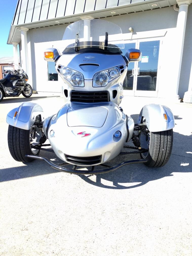

Brought it home from the Hannigan factory where it has been since the week after Thanksgiving last year.
WOW, a Honda Roadster. You have to let us know how it handles!

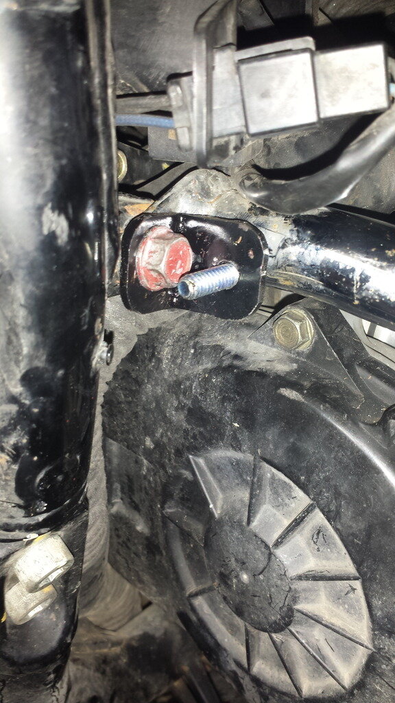

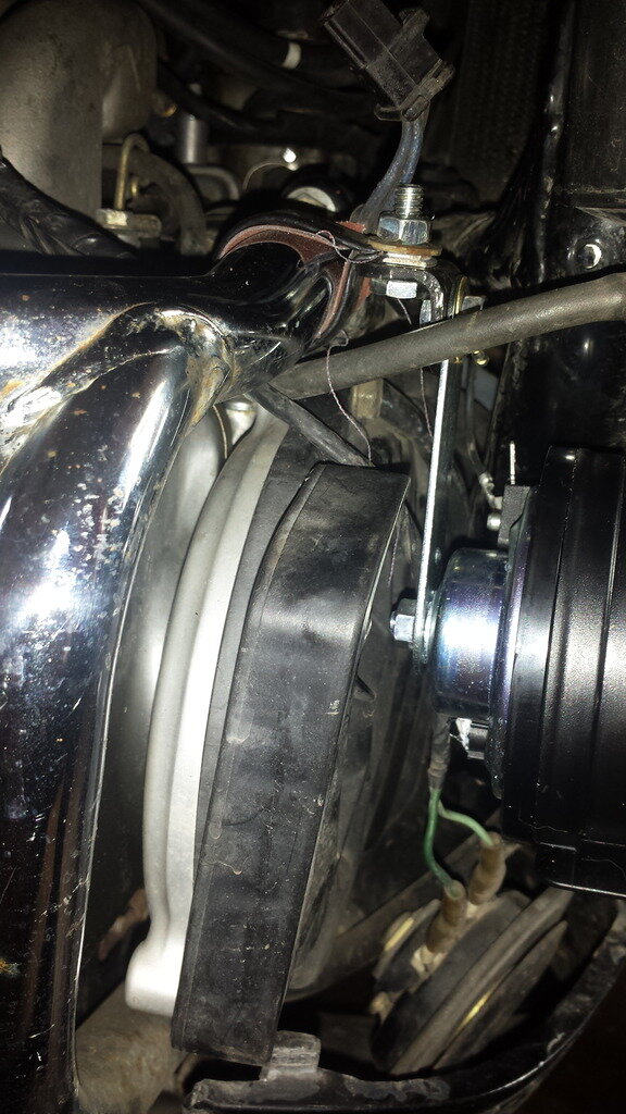

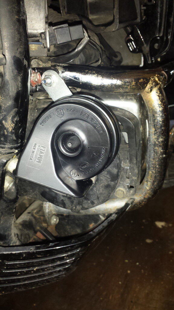

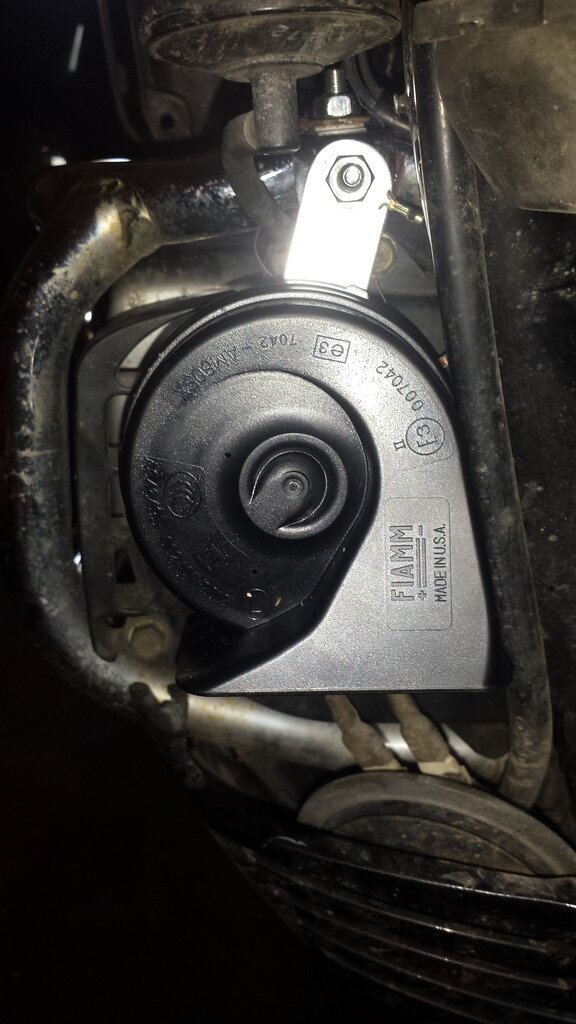

Mines a 1500.Just using blaster dual tone electric horns.It only has 1 now.I probably should study lube more but its missing the pull cable and i'm adding it back.I can take pics of the install.
OK took a few pics of the install.I guess i'm lucky not having corning lights at least for this purpose.I put a relay under the right fairing pocket.I made a few L brackets first.On the left I just mounted it the mounting bolt for the engine guard.On the right I used a P clamp and mounted the bracket to that.The horns are where the lights would be so there was room in there.I used a high and low note 130db Freeway Blasters and compared to my single stocker the improvement was huge.20170224_105526_zpscxkt4ay0.jpg20170224_105515_zpsgjvojnbv.jpg20170224_105454_zps9aoek8r3.jpg20170224_103012_zpsu8motj1j.jpg
