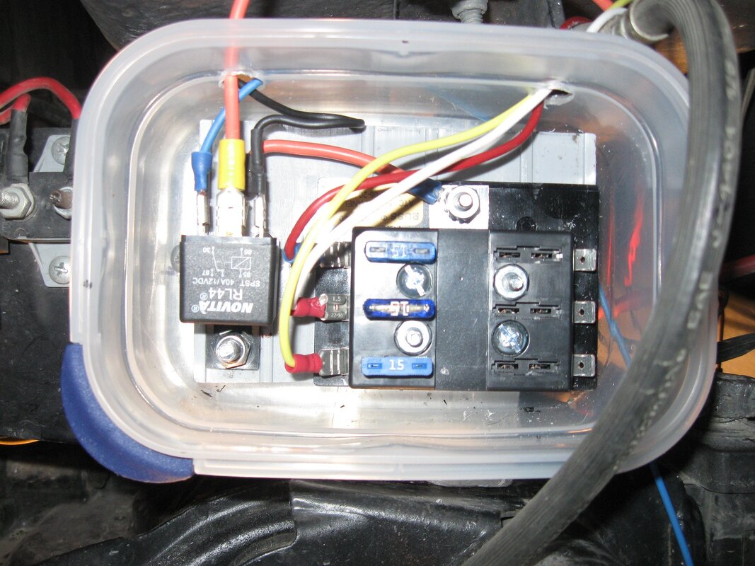

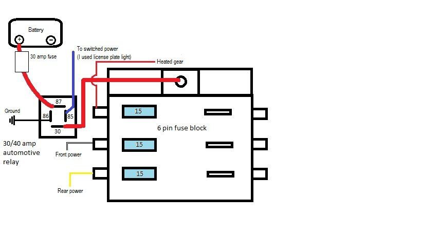

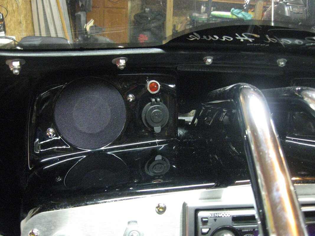

Installed a power block on the Roadhawk. I got a 6 pin ATO fuse block, ran power from the battery through a relay connected to the license plate light so it is only hot when the ignition is on. Mounted both of these on a plastic base and that rig went into a small Sterilite box from Wallyworld. These are sort of like Rubbermaid containers but they have a locking flap on each side so the lid won't come off. Drilled holes for wires on the top and a weep hole or 2 to let any moisture out on the bottom. The best mounting place near the battery was low on the frame and i didn't want road grime,rocks or spray to mess up the power block, so that's why the box. I installed a coax power outlet for Gloria's heated jacket liner on a side panel, a cigarette lighter style outlet on the dash and another below the left passenger armrest.
If anyone is interested I can take some pictures and make up a diagram of the set up and post them tonight.
WOW, doing all that and the Holidays to boot, you were very busy.
That is great you took pictures, a picture is worth a thousand words! Did you think of RTV on the box and wires so no moister could have gotten inside to box?
Did you put your wife's heat jack on a potentiometer so she could regulate the amount of current running to her jacket?
Thank you for sharing?
Rosy
Well, This seems like it will be a bit long.......
Took a while but here is what I did with the power distribution box.
I had already had the 16 gauge wire in different colors, the gray plastic for the base, a length of 10 gauge wire for the battery connection and ring & spade terminals. I bought the relay, ($6.99) fuse panel ($10.00) and the plastic box at Wallmart ($2.85) Less than $20 not including the stuff I already had. You can buy a relay controlled power distribution panel from $40 to more than $100, but this is easy to make and save some bucks. IMG_0916.JPGMounted on trike. The brake line looks close but has plenty of clearance. I didn't use a ground block, I grounded each outlet to a handy frame bolt to lessen wire runs, but a central ground block works, too.
Roadhawk powerblock.jpgHere is a diagram of what I did. All wires are 16 gauge except the power cables, they are 10ga. It is mounted on a plastic block and in a food storage bowl. The whole thing is on a bracket I made out of aluminium to mount close to the battery.

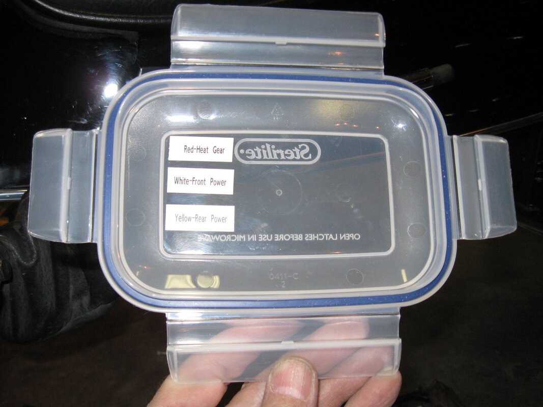

IMG_0918.JPGIMG_0919.JPGHere is the top showing the locking tabs, and the cover mounted. I marked the pins just in case. Rosy asked about RTV - I didn't want to seal it in case I needed to make changes or add circuits, and I didn't want to seal in moisture.

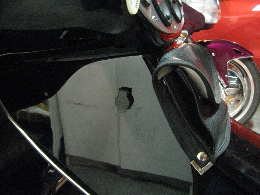

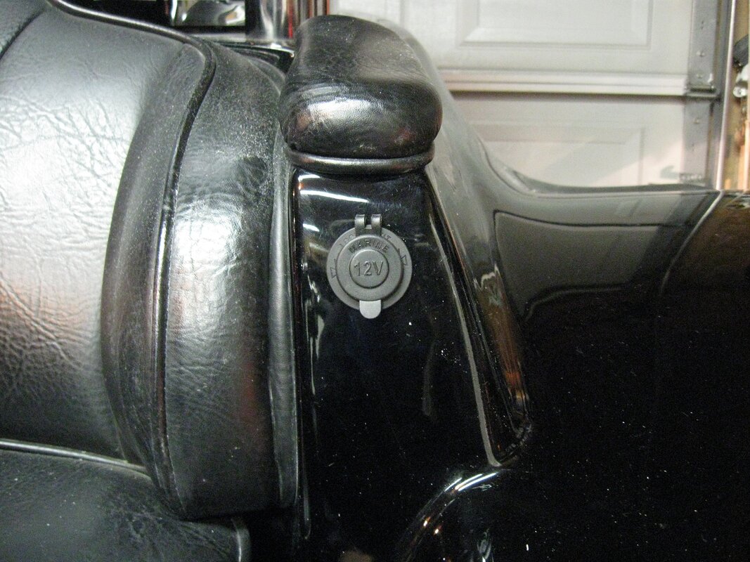

The reason for it all - the rear outlet under the passenger armrest, the front coax outlet under a spring loaded cover (Gloria will plug in the Gerbing's temp controller here.)The trike is jet black, it looks a bit gray due to reflection of a white cabinet. And lastly the front power outlet. I'll be adding a set of LED's in the rear, and that will leave 2 pins for future use.
