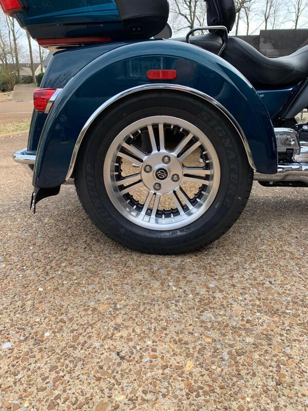

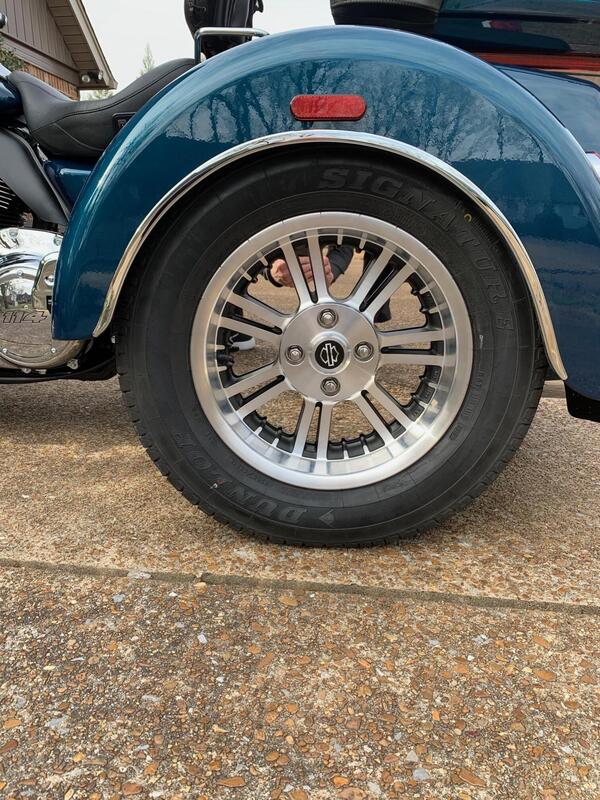

So today I installed the wheel discs I've had for a couple months. Just waiting for that new knee to cooperate so I could get down on the floor . . . and then get back up, lol. I did and it was no problem.
I've thought about doing this off and on over the years. Looks good!
What is really interesting is I got a call from RJ last week asking for a favor. He said that some of his Customers were complaining about a ticking and knocking noise after installing his wheel discs.
After some research he discovered that it was not the wheel discs making the noise. It is the loose/bent OEM Axle Bearing Retainer Plates letting the bearing knock around in the housing...that noise was always there, but the wheel discs was "trapping" the noise and making it echo off the wheel discs.
We worked out a deal that anyone that gets the wheel discs from him, and then wants to upgrade with a Axle Bearing Retainer Plate Kit can get a discount on the kit from us.
Never talked with him before. It is good he got that tracked down, because those really add a nice look to the Trikes, plus cut down on the brake dust on the wheels.
