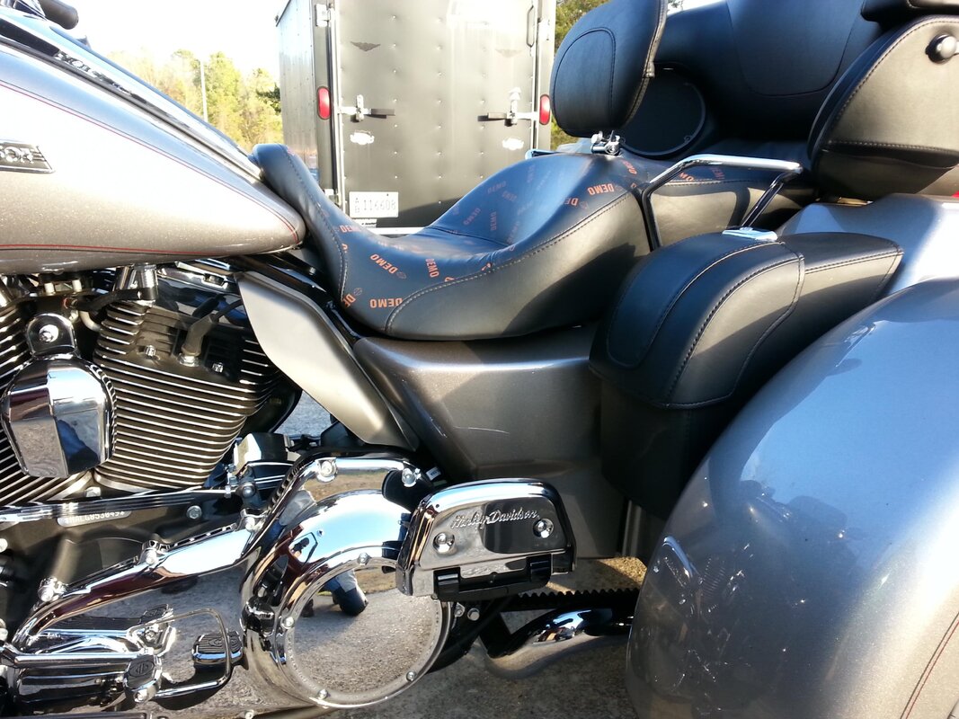

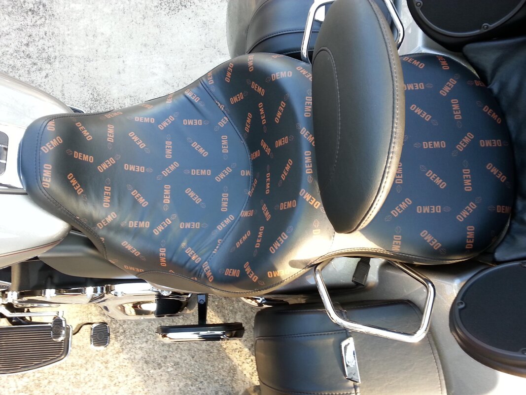

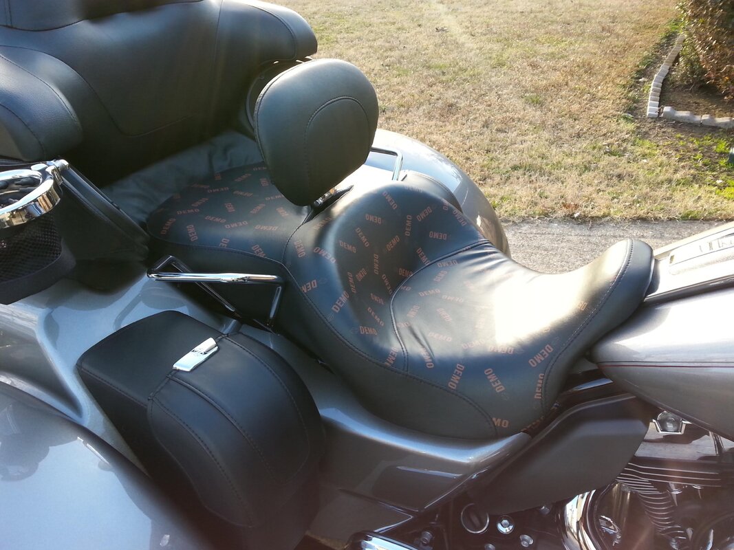

Weather finally allowed me to take Harley's Pre-Rushmore Sundowner Smooth Deep Bucket Demo Seat for a ride. This one is Part Number 52093-08A and it has a wider riders (16") and passengers (14") seat than the Sundowner Rushmore Model. Much deeper rear pocket that nicely supports the tuchus and is comfortable to the tailbone area. Was able to get a 196 mile ride this afternoon

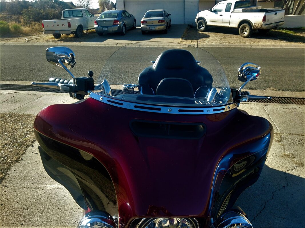

Busy Weekend

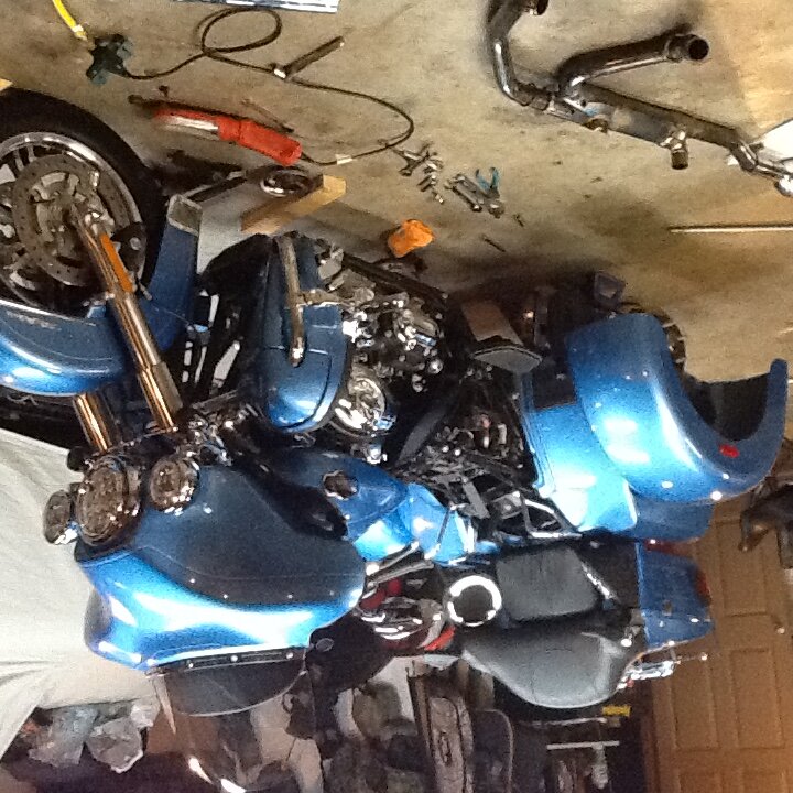

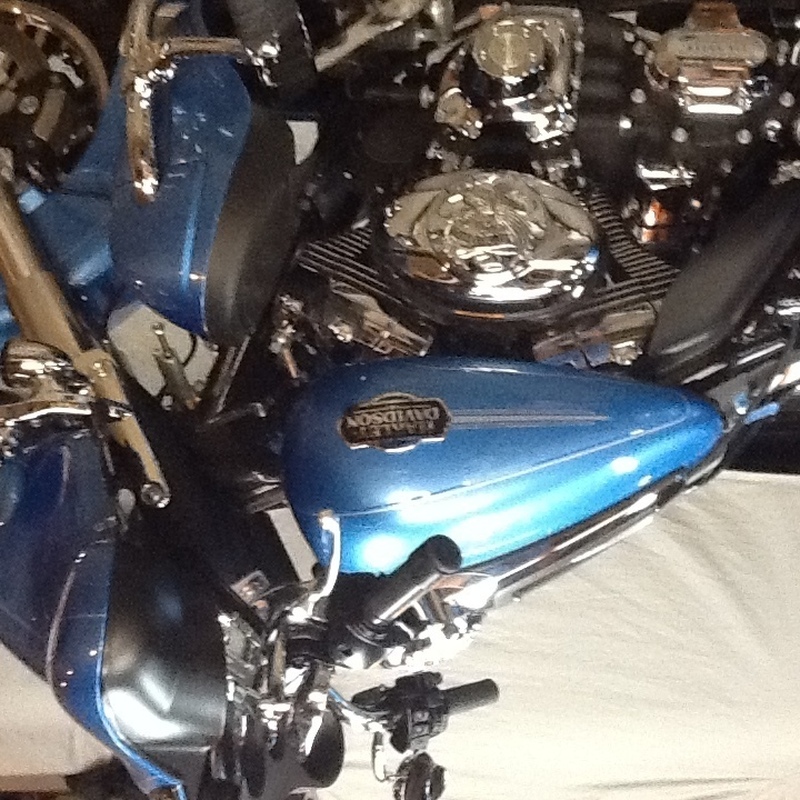

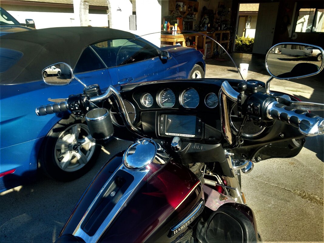

I had a very busy weekend beginning Thursday night. did the teardown for R&R of new 12" Mayhem bars and ended with installation of a decatted stock headpipe. A few takeaways from the handlebar war as in the handlebars and wiring harnesses being at war with each other. The bars won. For some reason I thought I could fish everything inside the bars. Not saying it can't be done, just not by me. Also, the TBW and right switchpack wiring harnesses are extremely tough. Had I not wasted 6 hours on trying to be Mr. Wiring ninja I would have had the whole job done in about 4 hours. In the end, I went external with the right side wire harness and the left internal.
Put about 250 miles on Saturday and I really like these bars. It steers a ton easier and I feel much more stable because of the extra width.

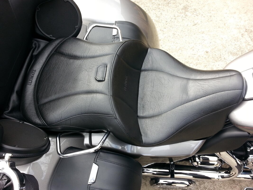

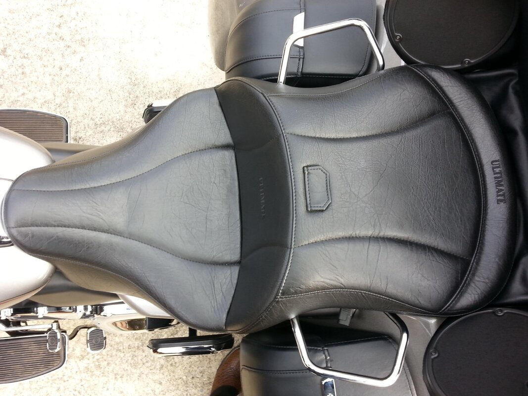

Ultimate Touring Tall Boy Heated Seat

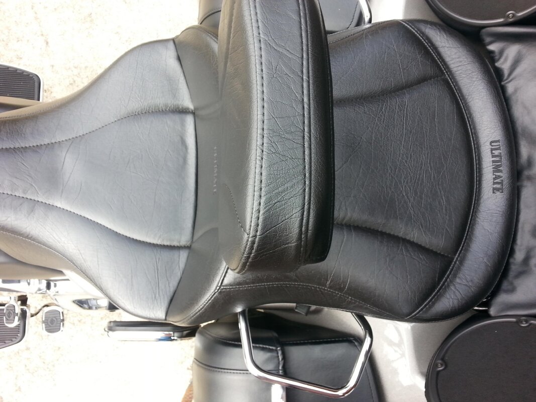

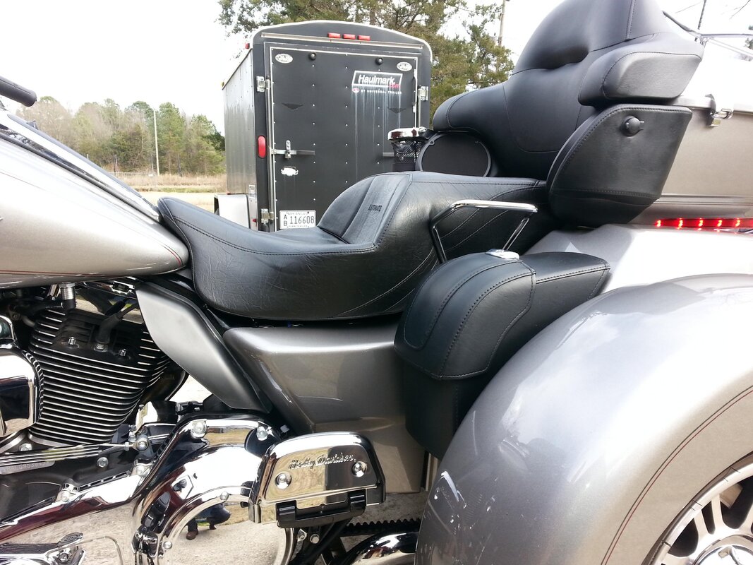

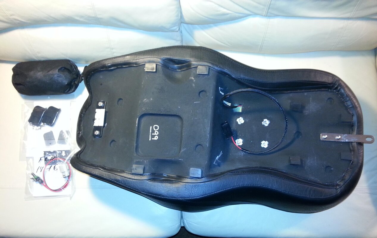

My new to me Ultimate Touring Tall Boy Heated Seat. It's for 2014-Newer FLH and Tri Glide Models. Got it from Ultimate Seats Florida location and it was offered as a demo seat sale. A very comfortable seat for me. Only negative was my Mustang Backrest and Mount had to be removed. Replacement backrest along with tour pak relocator next. Only need better weather for more ride time.
Manufacturers Description:
• Same height as oem stock seat and 1 1/2" further back from stock handlebars.
• Driver section 17" wide. Passenger section is 15 1/2 inches wide.
• Total seat length is a full 1" longer than the stock seat.
• Drivers backrest mounting hardware built into seat.
• Ultimate Heated Seats are activated by remote control.
• All Heated Seats come standard with optional Ride-On Rain Cover.

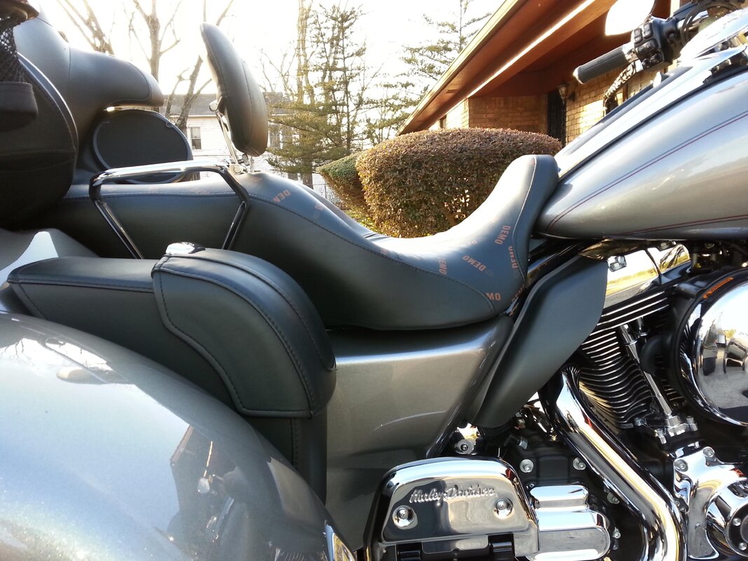

I installed the Mustang super touring seat that I ordered. I got out for a short trip. The seat seems to be comfortable enough.
Philip, I purchased a heated Mustand touring saddle for my 2018 TG about a year ago. It is a great seat and a big improvement over the stock saddle. I've had many CVOs and lately they've been equipped with the H-D Hammock saddle. This Mustang is much better imo. Enjoy.

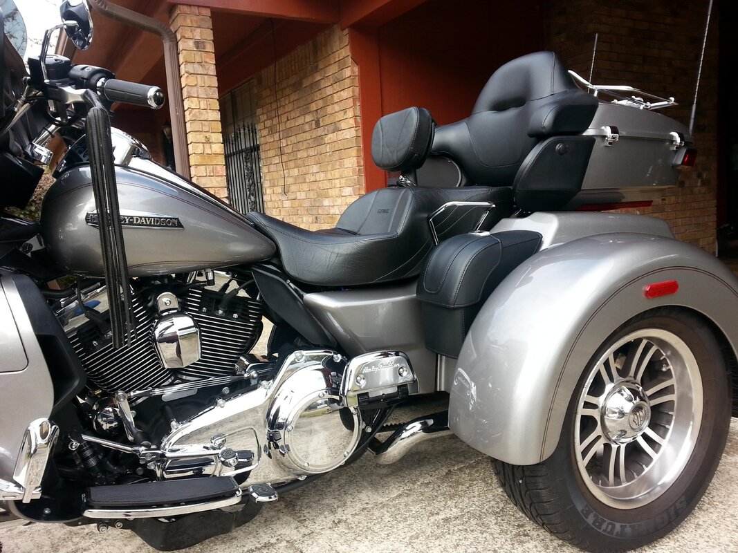

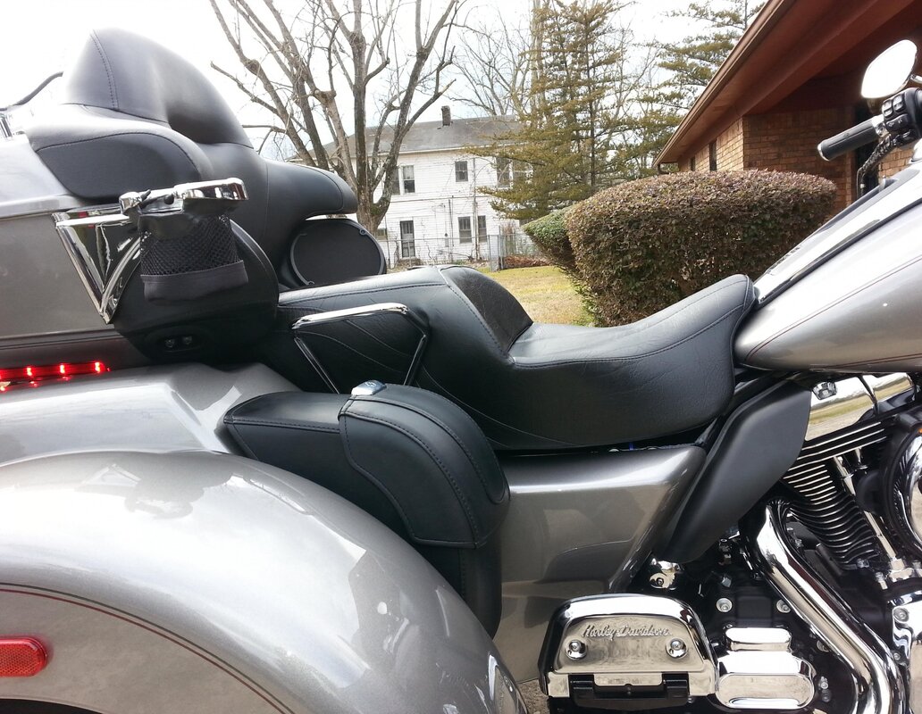

My order for a Backrest for the recently installed Ultimate Seat and a Tour-Pak Relocation Kit arrived last week. Did a one person install of Relocation Kit this past weekend. Up next is installation of the DK Convertible Lift Kit, if warmer temps stay around. Eating this upgrade Elephant List one bit at a time.

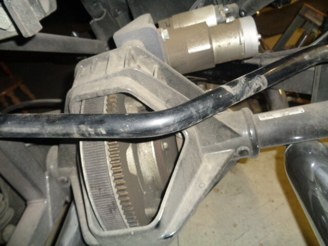

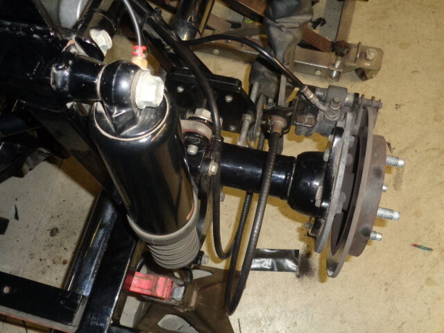

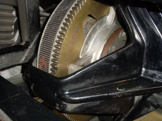

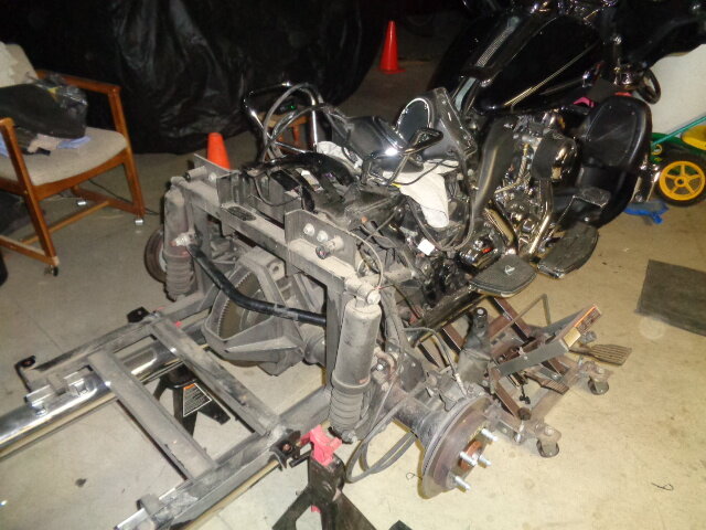

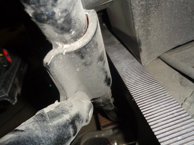

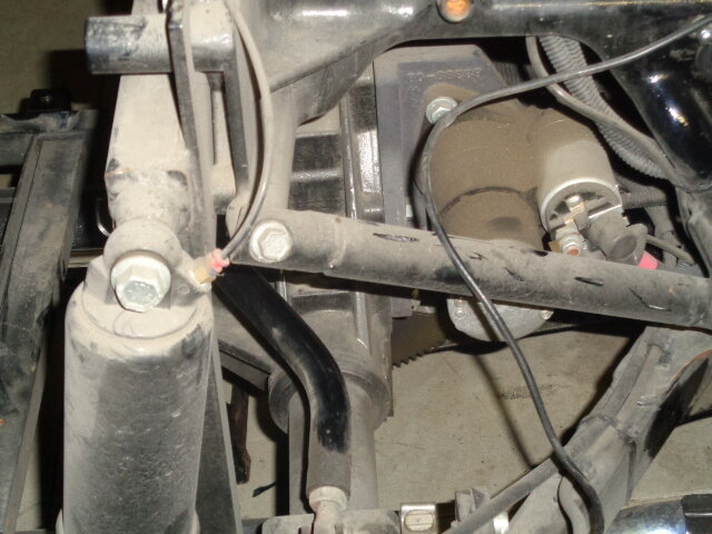

Took old Shiney apart alignment job and as it turns out brake job general cleaning, and repair of one connector taped before we adopted Shiney.
As you can see from the last picture the drive belt was hitting the battery box need to adjust a little to the left.
DSC01094.JPGDSC01096.JPGDSC01098.JPGDSC01105.JPGDSC01106.JPGDSC01103.JPGDSC01108.JPGDSC01109.JPG

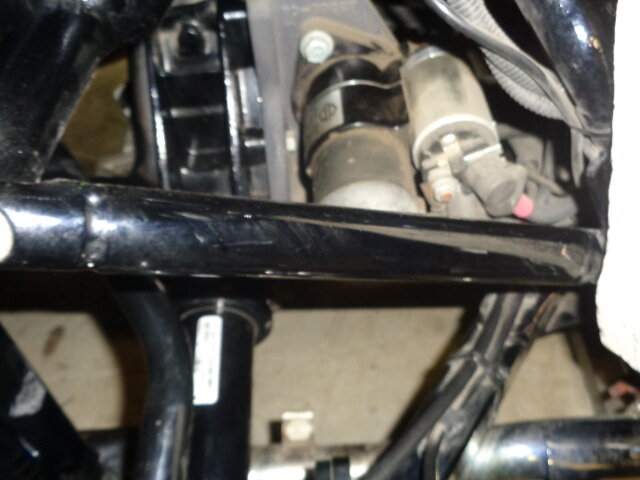

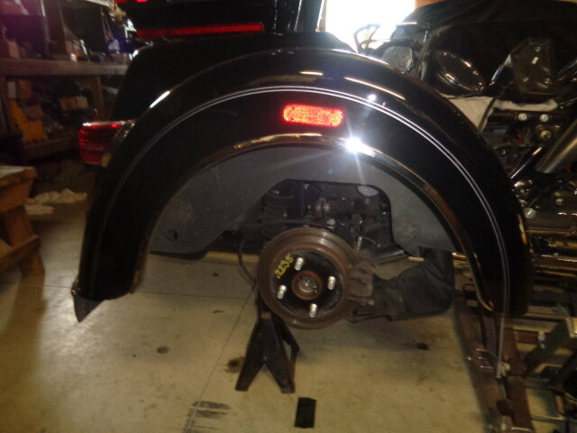

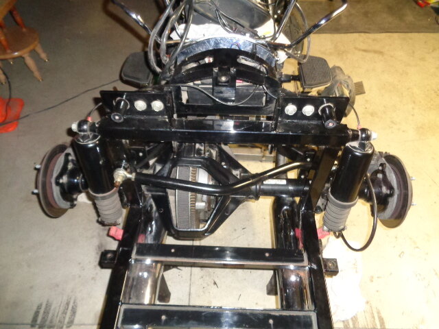

View attachment 67543View attachment 67544View attachment 67545View attachment 67546View attachment 67547View attachment 67548View attachment 67550View attachment 67549
Nice job cleaning everything up...it can get pretty nasty under there.
Trust all goes smoothly with the alignment!
Kevin the alignment went without hitch as I posted else where the supplement doesn't mention disconnecting the panhard rod but a third grader would see it must be off to move laterally. That is when I found a worn Heim joint so I replaced both. Magnetic Laser Levels made this job simple. I'm waiting on a few other things I ordered before re-installing the body. It will be interesting to see how close the spacing is now on the fenders I have always had more space on the left side of trike (primary side) we shall see. I believe everyone with the tools and time should at least take the body off and look at what they are riding it's really neat to see, I believe I have a better understanding of what makes it so much fun. travel safe Fred
I was thinking about trying one of those was not sure how good it would work. May pick one up.
They work everywhere especially behind the rotors on the hubs. Wash it out when done and when worn out replace with a sponge cut in a circle great tool. Fred
