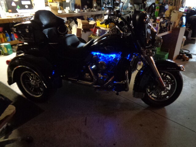

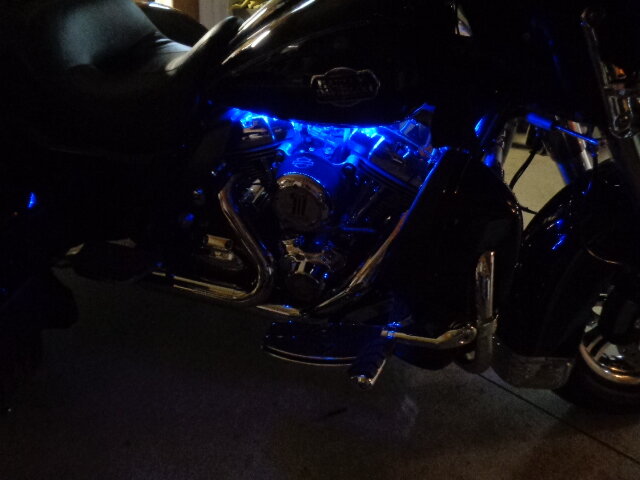

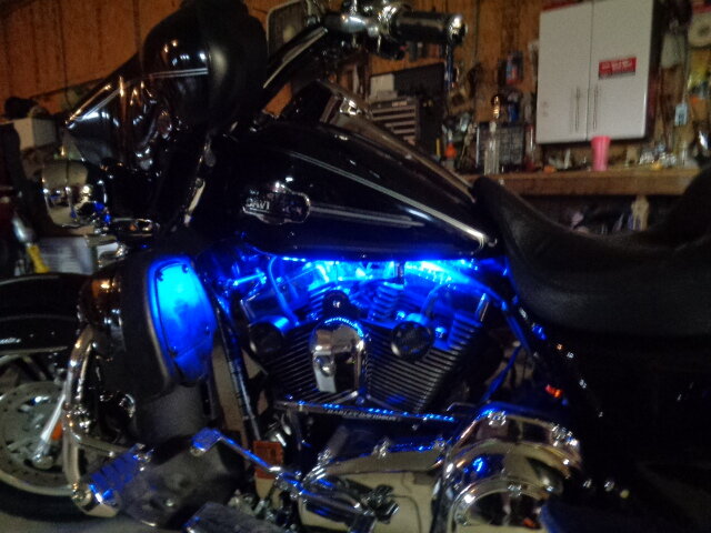

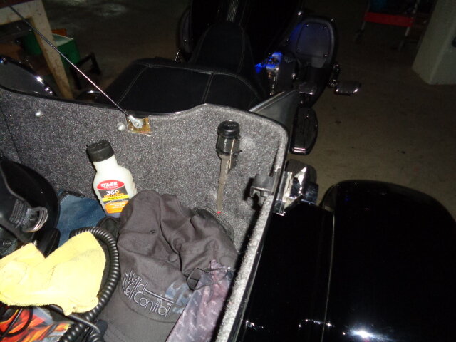

I have been planning to install power port in TP for sometime finished up today after church. I used 14 gage wire fused just off battery so not to have any problems down road so to speak. Last fall we stopped for fuel and an Ultra Limited there also was all pimped out with LED's bride liked them so.... for her I added a few under the fuel tank don't believe I will add any more though. :friends: God Bless America :high5: travel safely Fred

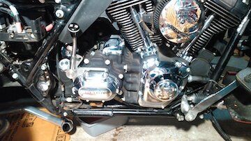

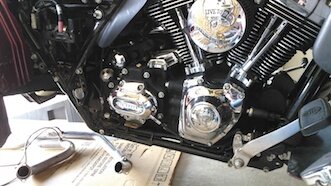

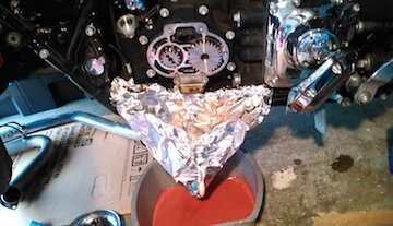

I got the garage arranged for working on the trike, got it up on ramps and took the exhaust off so I could get to the transmission side cover.
Going to add a few things while I have access room.
Clutch cable and reverse

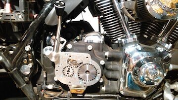

While I had everything apart to replace the cable, I installed a mechanical reverse.
The foil does a good job of keeping the trans fluid off of the frame.
Notice the two new gears.
Added the gear housing.
Assembly complete with new clutch cable.
Now I have to put the exhaust back on. It came off a lot easier than it went on the first time.
