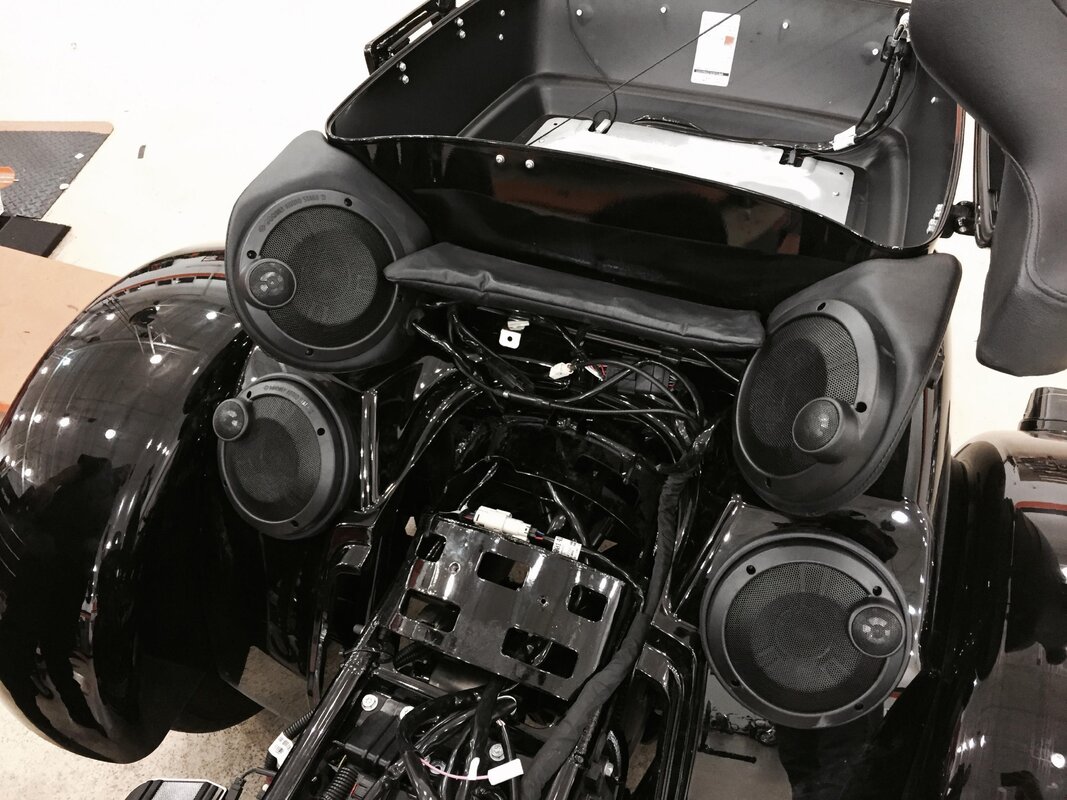

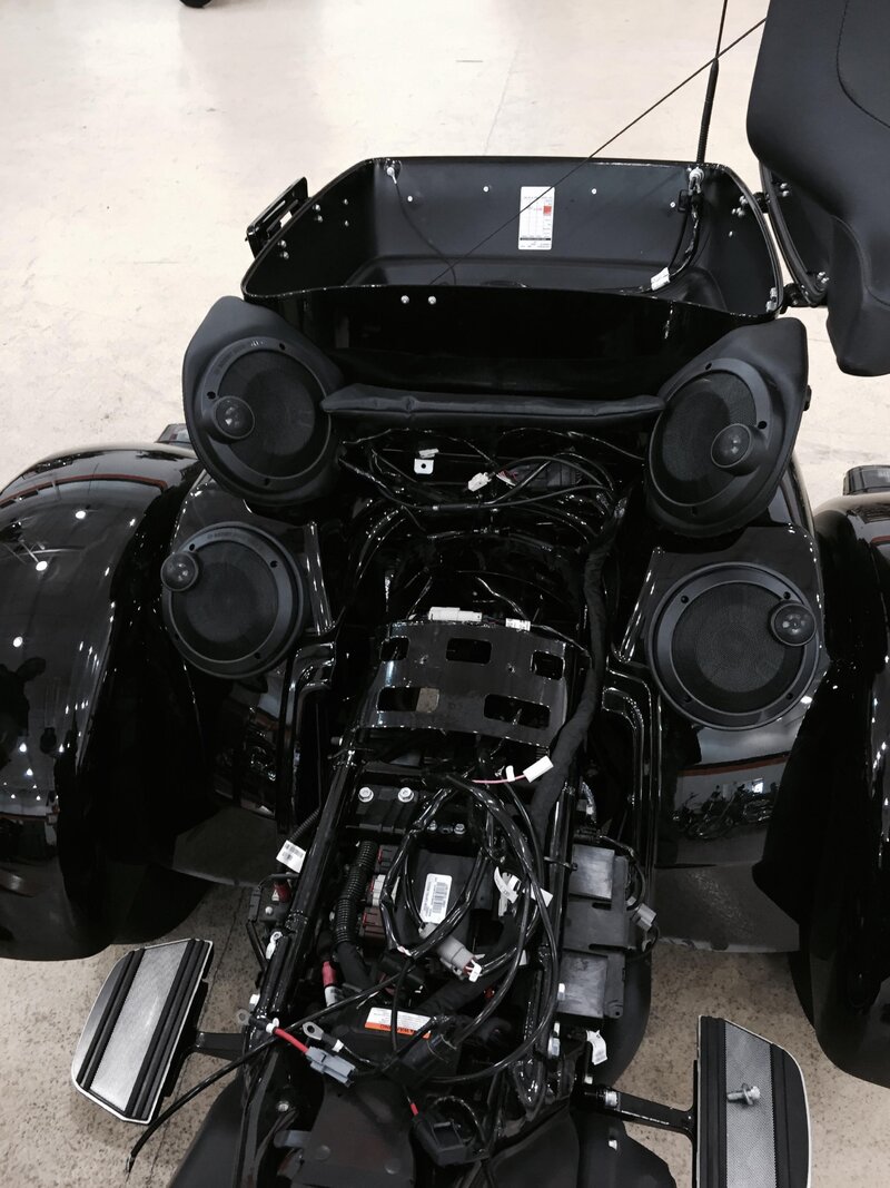

Thanks for the compliment.
.....I like holes :D
Who doesn't? ;)
Looks great. Think it gives more of a finished appearance than flat aluminum, light old school ( I hate that term, but it applies here) lightening holes ThumbUp
Awesome! I was washing gigi last week, and as I was doing that flat portion next to seat, I was thinking that would be a great spot for speakers. Seeing this pic makes it even more a desireable mod sometime down the road (hopefully soon). Using the same speakers as the passenger-mount ones really completes the look. Kudos for taking the plunge (scary cutting into body parts without knowing how it will look/perform) ThumbUpThumbUpThumbUp

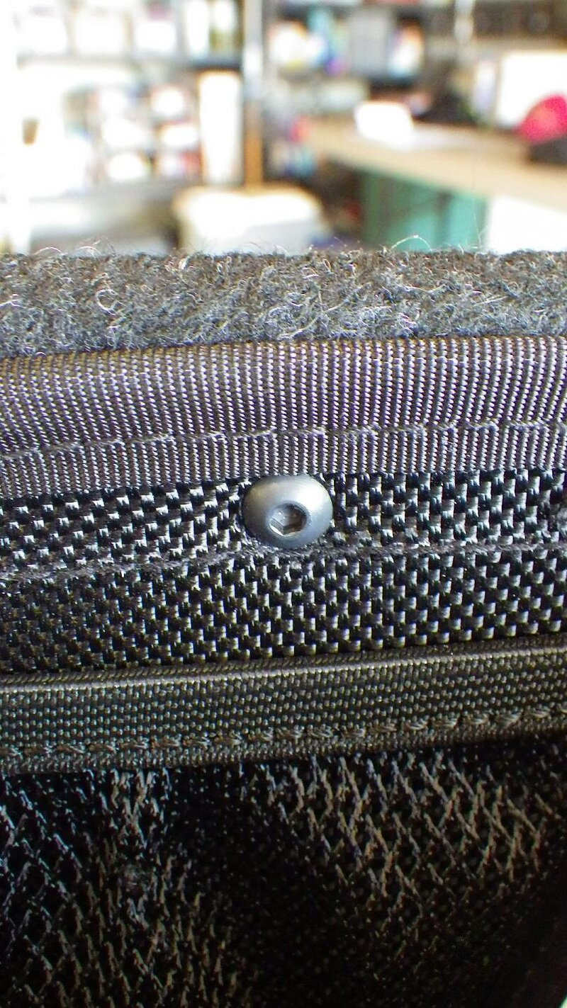

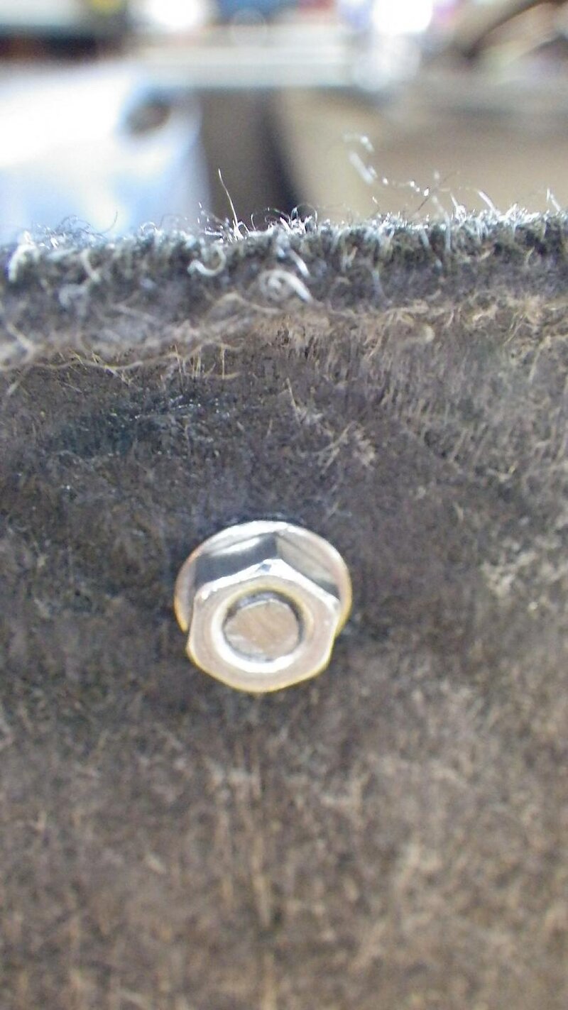

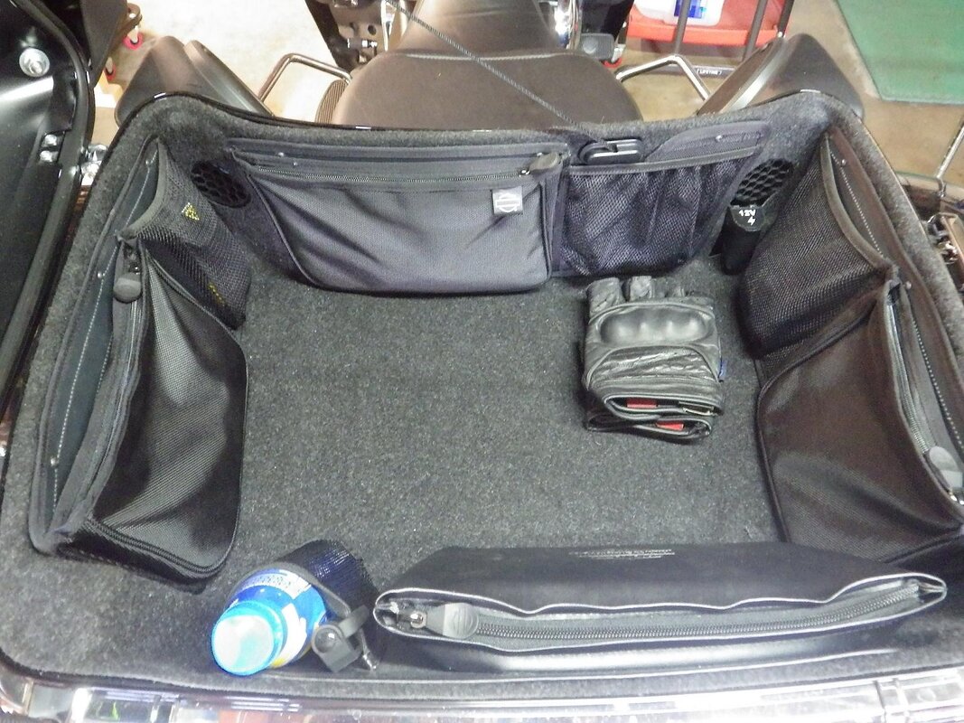

One of the first things that I got after buying the Tri-Glide was a 3 piece Tour-Pak wall organizer part #53000303. It came with long velcro strips that Harley calls "hinge strips" and are supposed to stick to the liner walls. But since the liner is a felt like material I wondered how well the hings strip would stick to the felt. Without the strips the velcro already sewed onto the back of the organizer pockets stuck to the felt so I just pressed them up against the sides and forgotaboutit. But....they did not stick that well and often slid down while on a ride or came off whenever I tried to put something in or out of the pockets. So I decided to secure the pockets myself.
I first tried Pop Rivets, but the ones that I had were too short and did not hold well. So I removed the Pop Rivets and bolted the pockets to the liner with 4MM x 8MM black button heads and nuts. I had to shorten each button head by 1-2MM so the bolts would not scratch the inside walls of the Tour-Pak, but now all three pockets are very secure, and I can remove them if I need to.

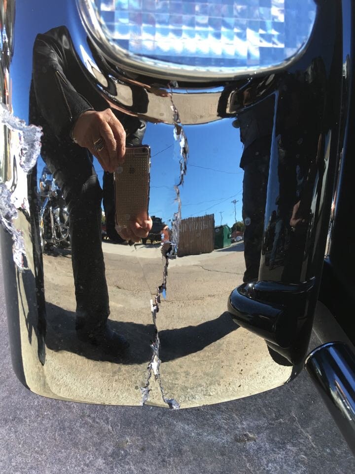

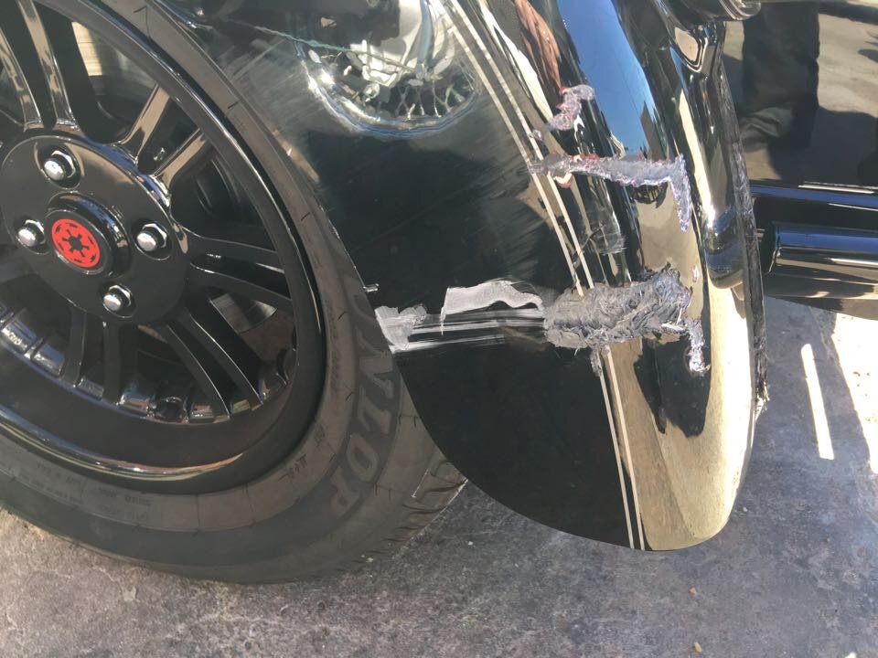

Went on a little 550 or so mile trip today with a few friends.. Sadly, for me, one of them was a bit too close, and not paying attention while we were entering a toll road.. I was 3rd bike (of 5) to move out, and some jackass in a Jeep decided to punch it to get between us.. I stopped, my buddy didn't.. not until he smacked my fender anyway :(
Oh well.. nobody hurt.. no dmg on friend's bike.. will find out Monday what it's gonna cost to replace. Glad the light didn't break because that would have added a hefty $$ to the sum.
