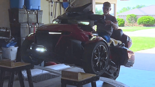

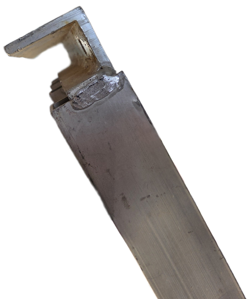

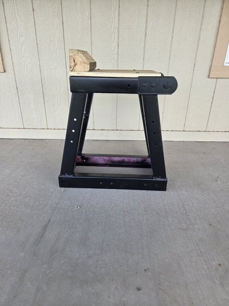

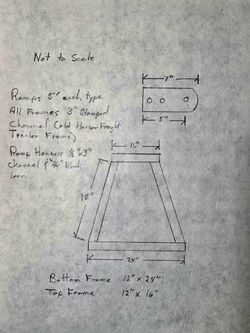

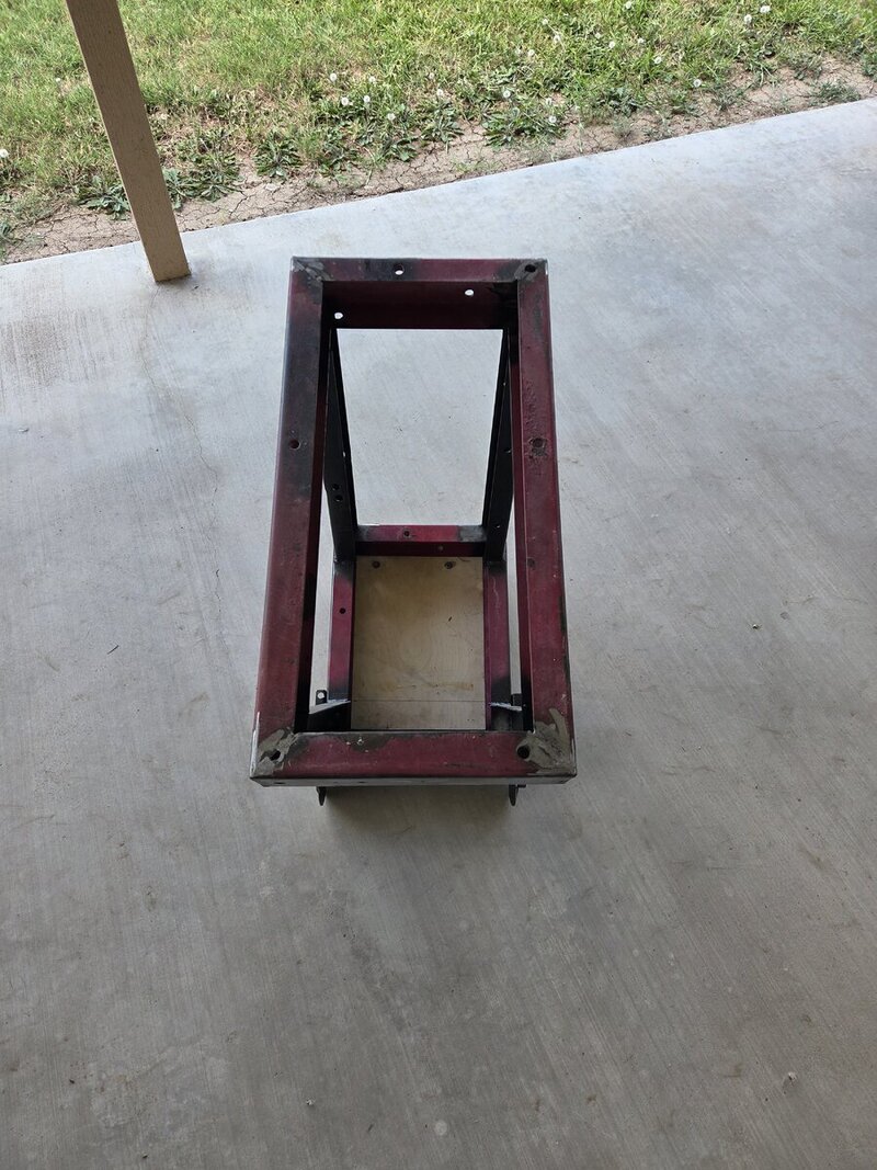

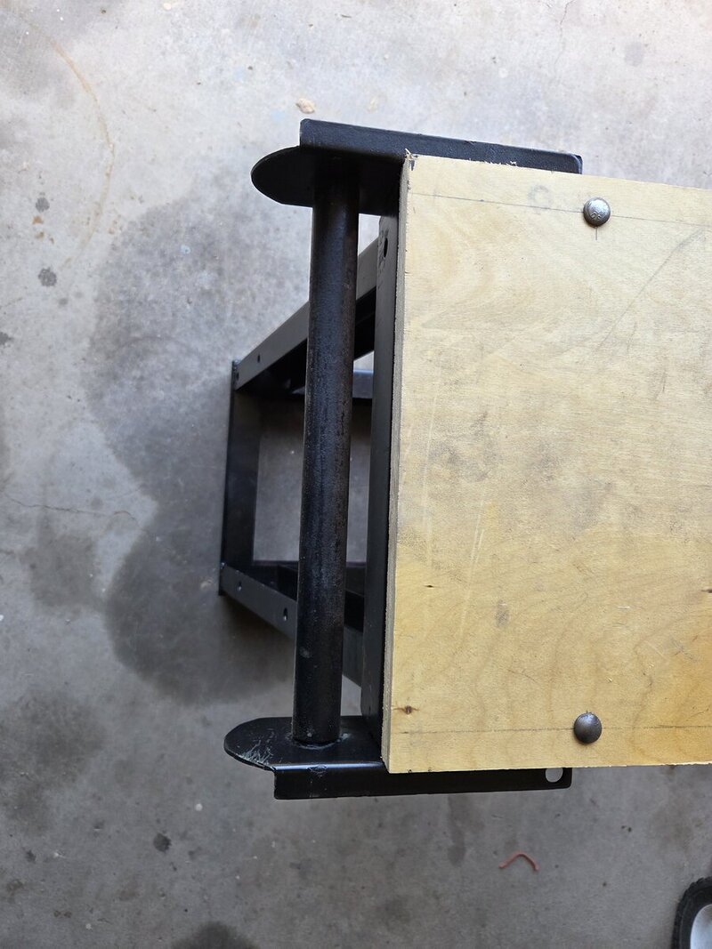

I sacrificed my old harbor freight trailer for the main frame. The top was some scrap plywood and 4x4 screwed down. The ramps obviously were not made by me. I used 3/4" black iron pipe for the ramps to hang off. If you are interested I will take better pictures and provide measurements. I will say I should have made it a little shorter as I only needed to provide 2 ft clearance from the bottom of the frame and I actually made them 2 ft tall.
your pictures and drawing are perfect. Since I don't weld I will figure out a way to bolt it all together. I think I will use a couple of steel stools and cut them down. Thanks a lot 79 Spitfire.

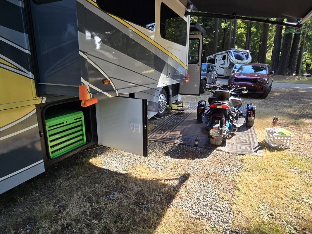

Got back to camp and cleaned the Spyder after 3 rides of neglect. I sure miss my garage.
