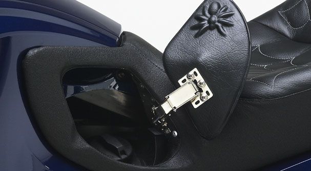

Ultimate seats has a gas door option that uses an aftermarket fuel door. Many folks have bought the door and done the modification themselves. Here is the picture of what Pegasus1300 is doing.
images
Corbin has a version that they modify the front "wing" of the seat:
And open. access to the gas cap without lifting the seat.:
